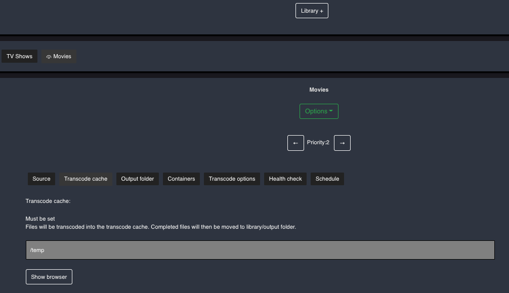

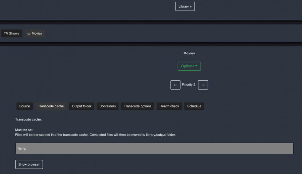

  8. Found my problem...I had not set one of the library transcode caches to /temp (hand left as default .) Delete the docker, which cleaned up the docker image (dropping about 20% usage), reinstalled and restarted....all is good! TDARR is filling up my docker container. I had installed TDARR the other day, and everything was running find - transcoding for a couple days. I then had a power outage and after a restart, during parity check, I got a docker image space usage error. I stopped TDARR and the image stopped filling. After the parity check was complete, I restarted TDARR - and more filling. I have attached the TDARR log files. Advice appreciated. TDARR
