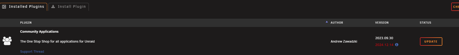

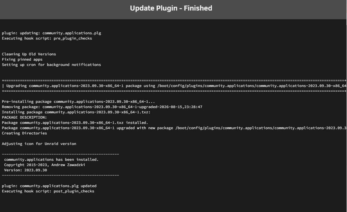

  3. For some reason the update below won't complete. After clicking Update the process runs and appears to finish without any errors. When I go to the Plugins tab after the update a link is displayed to update to 2024.12.14. So the update is not taking effect. Any ideas please I'm not a power user. Thanks

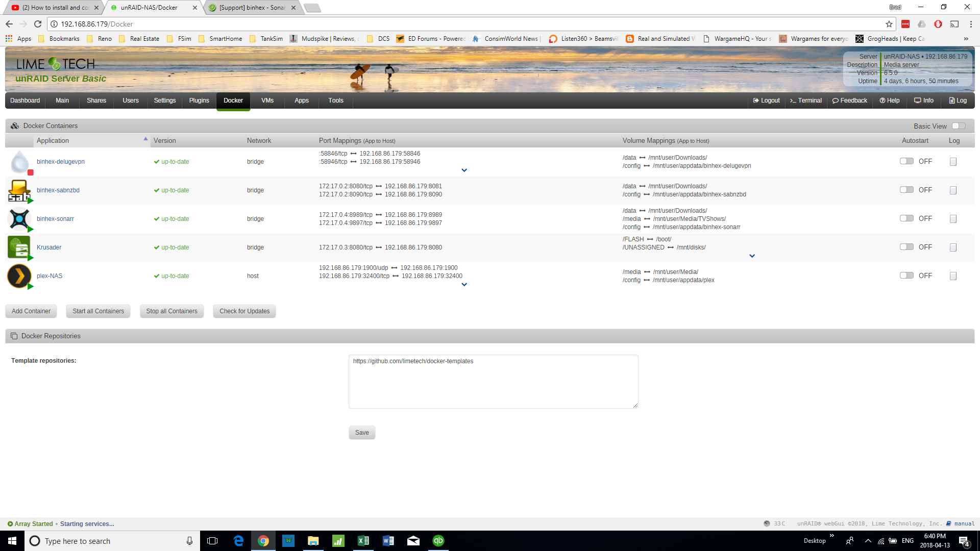

  7. So I renamed the directories to remove the caps. The run command is below. But it still isn't working? root@localhost:# /usr/local/emhttp/plugins/dynamix.docker.manager/scripts/docker run -d --name='binhex-sonarr' --net='bridge' -e TZ="America/New_York" -e HOST_OS="unRAID" -e 'UMASK'='000' -e 'PUID'='99' -e 'PGID'='100' -p '8989:8989/tcp' -p '9897:9897/tcp' -v '/mnt/user/Downloads/':'/data':'rw' -v '/mnt/user/media/tvshows/':'/media':'rw' -v '/mnt/user/appdata/binhex-sonarr':'/config':'rw' 'binhex/arch-sonarr' 0cbbc8817ef0efad0d306907674a80585bc736c723cb61fb9be1895457fc547d
  8. Where do I find the Run command? Sorry
