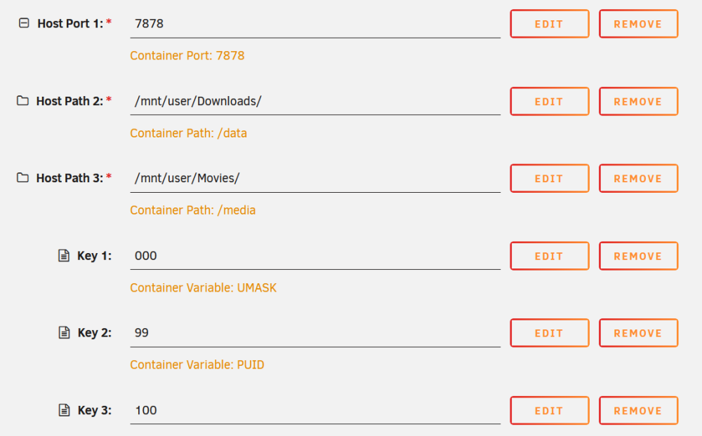

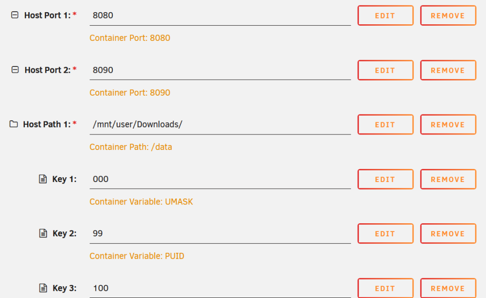

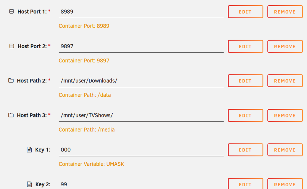

Hello,
I recent updated to the new version of the docker and now I'm getting some permission issues.  I have the postProcessing (Sab -> SickBeard) script running and now I'm getting the following error from Sab:
PostProcessing was aborted (Cannot create final folder /UnprocessedShare/tv/TVShowNameHere)
/UnprocessedShare is set up as a volume for the Sab container
I also just deleted the perms.txt file and forces an update
Do I need to somehow set permissions now?
EDIT: I just ran a quick test without the post-processing.  I think it is because I try to move the files from the Downloads location, to a different location on the new volume.  I don't think it has anything to do with the post-process script.  Hope that helps
EDIT 2: Temporary fix for now: I looked at the permissions of my "shared volume" and they were root root.  I believe that was the cause of the problems.  I modified it to nobody:users and I am able to create the folders and finish the download process.  I am assuming this is not the ideal solution, but I think it's a stop-gap
I'm having the same permissions problems. Sabnzb isn't able to create folders in my "incomplete" folder so it can't start downloading anything whether it gets passed along via sickbeard or couch potato or if I put an nob in my catch all folders. The plex docker is busted at the moment too. Jswanson can you give me some advice on how to fix the permissions as you did?
Here were the following steps I used.  I don't think it is 100% as I am still getting some issues in the Sab Log (lots of "Suspect error in downloader", not sure if that is related)
Note: I only did the following on my "shared volume" between Sab/Sickbeard/Couch Potato.  I did not have to do this to my Docker Folders.  Same idea may apply, but I did not test.  Proceed at your own risk.
First navigate to the location of your "shared volume" using cd (should be on your cache drive)
Run the following command:
ls -l
You should see a list of all the sub-directories and their permissions.
My "shared volume" was "root root" and I changed it to "nobody users", using the following command:
chown -R nobody:users sharedVolumeLocation
Then you can re-run the ls command to confirm.
Again, this worked for me and I do not know the implications this might have.  However it is currently working for me, which is good for now until I hear the "official" solution.
@ttttubby i would probably hold off doing the above for now, jswanson04 had a different issue to what you have, as he was saving to a different location (possibly even an external drive?), and permissions wern't set correctly on this, i do NOT make any modifications to any other volumes, only the /config host path so this wont be your issue.
possibly even an external drive?, and permissions wern't set correctly on this, i do NOT make any modifications to any other volumes, only the /config host path so this wont be your issue.
No, my shared volume is just another folder on my cache drive.  The reason I am leaning away from the permissions not being set up correctly originally is there was not an issue before.  All of the dockers interacted with the shared location without an issue.
Unless there was something that was changed where before the docker was running as root, but now it is not and that is the issue.
Deleting the perm file made it so that I could download files through my watch folder it now I'm not communicating at all with couch potato. Could be a couch potato issue?
Ok deleted the couch potato perm file seems to have fixed this. Still waiting to see if post processing works correctly but for now things seem to be back to normal.
