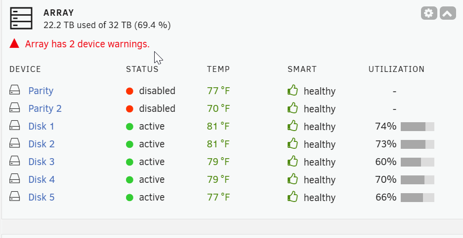

  2. There in one of these: https://store.45homelab.com/configure/hl15 So it's odd that those two specifically would die. I guess to clear the errors, I need to stop array, remove the parity drives from the config, start it, stop it, and re-add the drives?
  3. Is it possible both of these died at the same time? I got them both at the same time and they're maybe a year old. I moved them both to new slots and have the same problem. They're both able to run a smart test with no errors (I know that doesn't mean much) Thoughts? Time to replace? tower-diagnostics-20251013-1020.zip

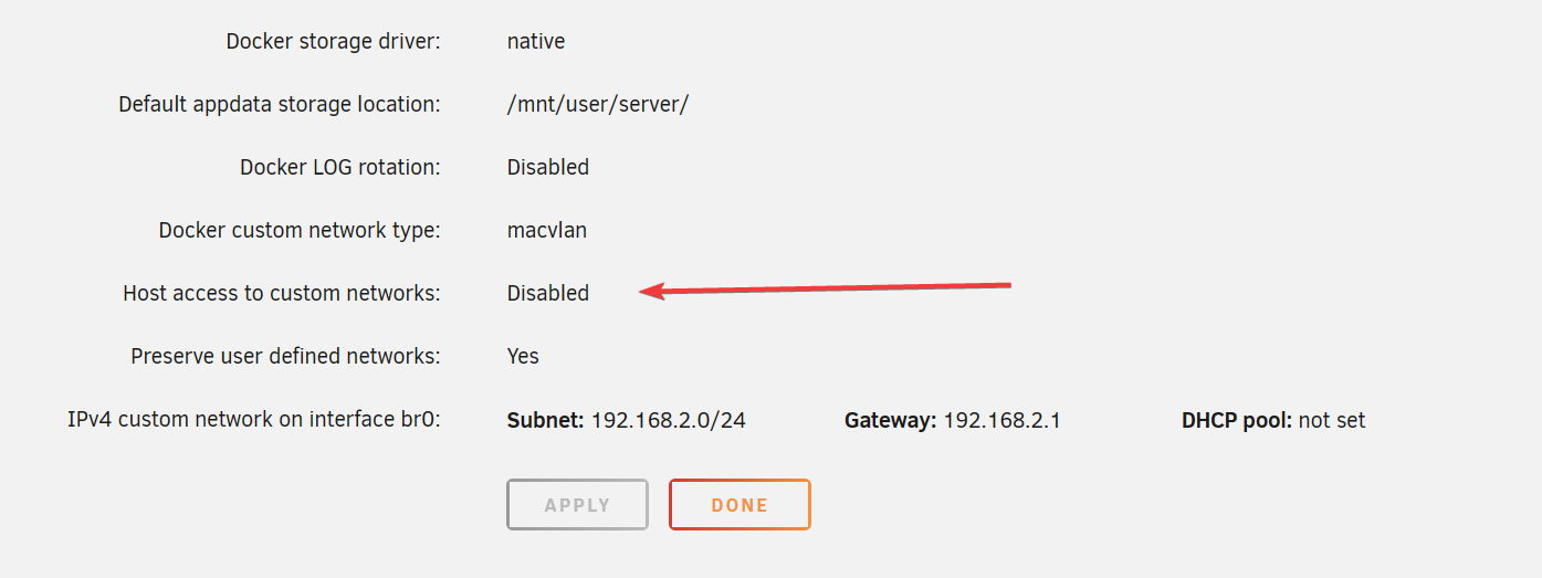

  4. Just needed to enable host access to custom networks under docker settings

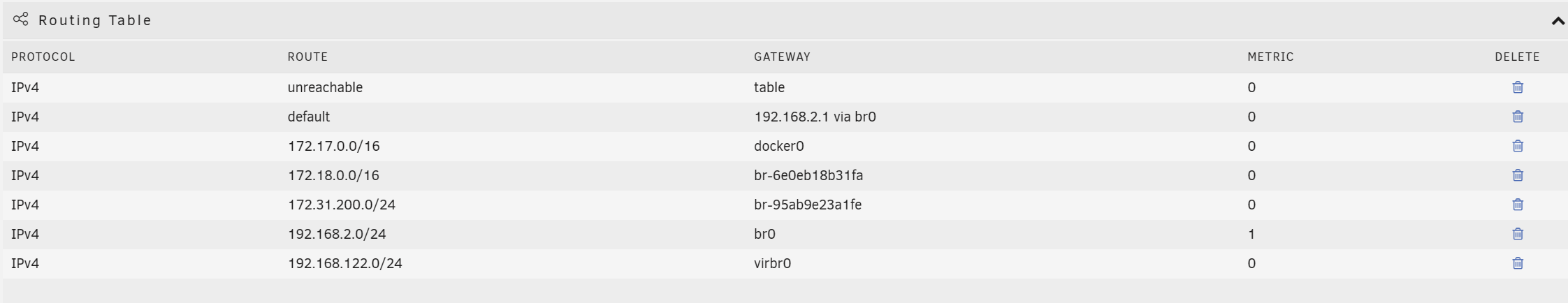

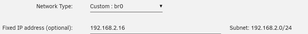

  5. The opposite is also true... I have Nginx reverse proxy container on it's own ip (192.168.2.15) and it is not able to connect to anything on the host unraid IP (192.168.2.3)
  6. Not sure if this is the right subforum for this but here goes. I have several dockers running on the default docker network. And some dockers on fixed IPs In my case, these two networks are not able to talk to each other. If I open the console for binhex-jellyfin, I cannot ping 192.168.2.3 (my unraid server address) Here's my routing table... Any help in sorting this out would be appreciated.

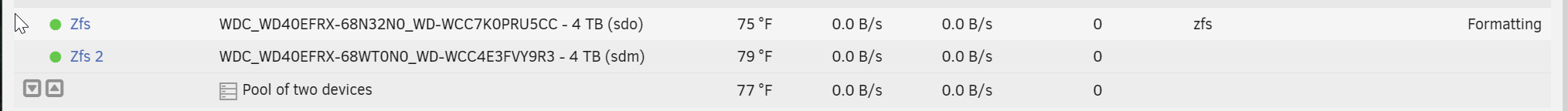

  10. Background: I starting playing with ZFS pools. - Started with 3 old 4TB drives in raidz1. - One of the 3 drives failed out. - I destroyed the pool to get the bad drive out. - I built a new mirrored pool with the 2 good drives. - Didn't format the drives so it basically imported the two zfs drives and set up a raidz1 pool. - Took me a couple of tries to notice what was going on - destroyed pool. removed partitions on drives. - created 2 drive mirrored pool. At this point I started a pre-clear on the bad drive to see if it's bad, and yes, it is, it's puking all over the syslog. No problem there; expected that. I started the array. Started successfully. Told me I need to format the new pool. I checked the box and hit the button. I've been sitting here for about an hour with zero disk activity. Diagnostics attached. Any help is appreciated. tower-diagnostics-20250424-0835.zip
