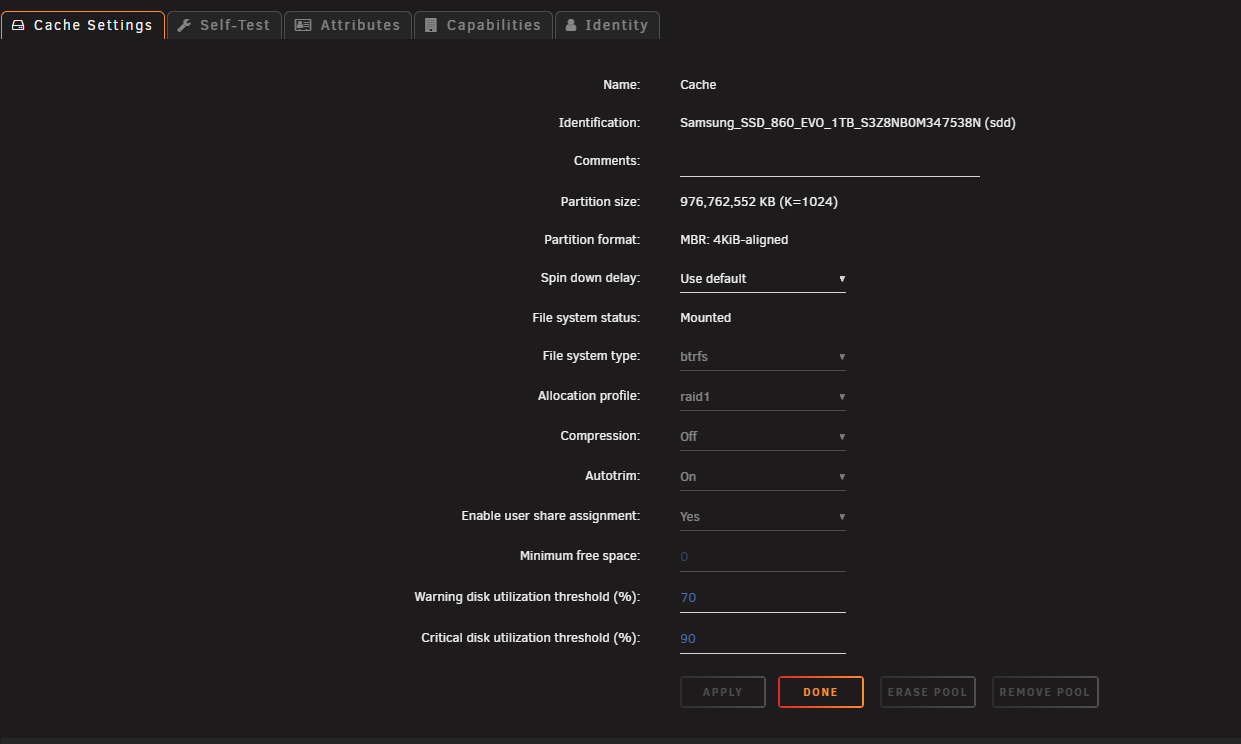

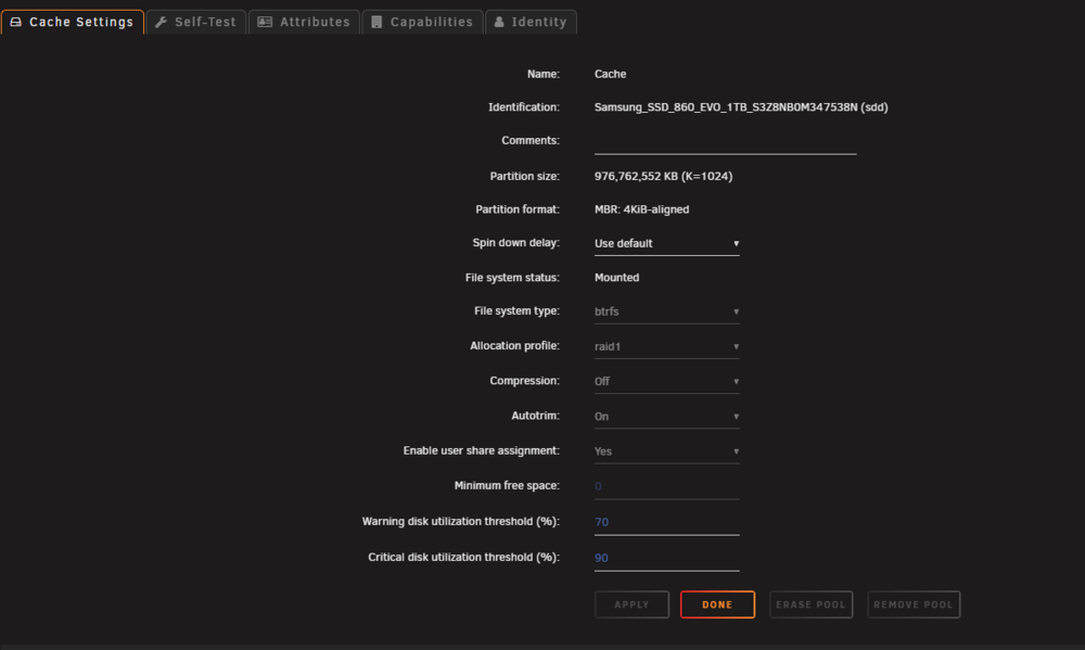

  1. I'm confused because I have never had to do any of this and I have been copying image files that are over 1tb in size with no issues. It used to just go directly to the array, because my pool size is 1tb. I took a look at those directions and I do not see where to change the Floor or min size? Can you tell me exactly where to find this setting? Having to set this temporarily also confused me. That means each time I need to copy a large file, I would manually need to change this value??
  2. I use Total Commander ver 11.56, current version. I have used TC for years as well. Not likely to be on the pc side here. Nothing has changed on my pc. These copies worked fine until the last unraid update. My Share settings haven't changed since moving from ver 6 to 7. So this points to the last update to 7.1.4. Do my Share settings look correct to you?
  3. This is a new issue for me after upgrading to 7.1.4 diag file attached. All of my shares are configured to use cache and then array Cache is a pool of two 1tb drives ssd My array has over 30tb free I sometimes copy disk image files which are larger than 1tb, which means they are just copied directly to the array. At least this is how it has worked for many years. Yesterday I tried to copy a 1.4tb image and it keeps failing due to Disk Full error. On the server, I have several warning s about cache drive running out of disk space until it is maxed out, meaning the copy job fails. It looks like it is trying to copy a 1+ tb file to the cache drive when it should not. It did not do this before upgrading to 7.1.4tower-diagnostics-20251013-0822.zip Windows 11 Pro on the pc side, again this has worked for years. For files less than 1tb, they copy to cache drive and then the Mover does it's thing to copy to the array, as it should. Any idea why this is now failing?

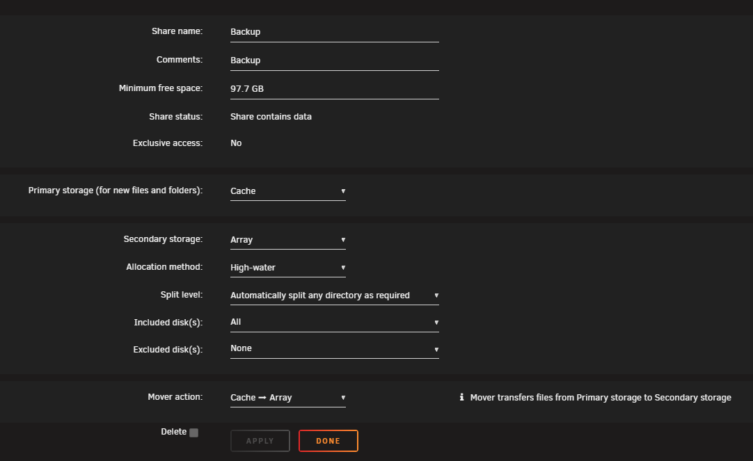

  8. and now the mover ran as it should, so now everything seems to be working. Puzzled as to what happened here.
  9. well spoke too soon. The mover ran for a bit, then stopped, leaving a ton of files on the cache drive. It's still not working. I have now manually moved all files to my user shares, cache drive is clean again. Went back to my share settings, and again a couple were changed back to cache only, so changed those again to cache --> arrray sending some new files to my server to see if the mover does it's job.
  10. Ok that was it. After upgrading to 7, my some of my shares were set to use cache only and some were set to use array only. I found that changing the primary storage to cache, then the option for secondary shows up, so make that array. Moving is running now. Thanks!
  11. I also no longer see the option to use Cache drive on the Shares tab?? Where do I configure a share to use cache initially, and them mover runs to push those files to array?
