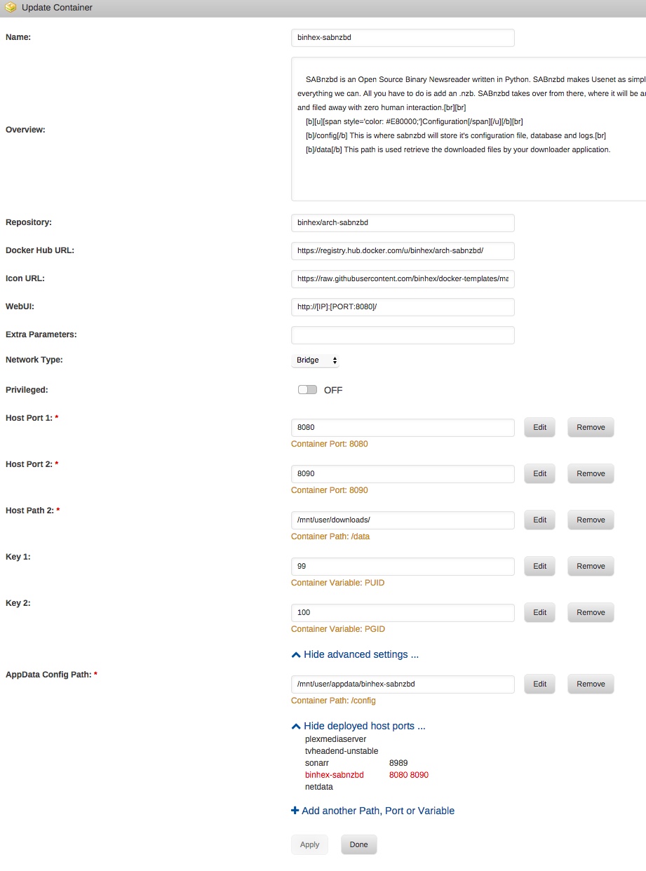

Ok I added the container to Sonarr, but the path is not listed, for sabNZB it says :data does this matter? See attachments. Now that I have added this to Sonarr what is the next step?

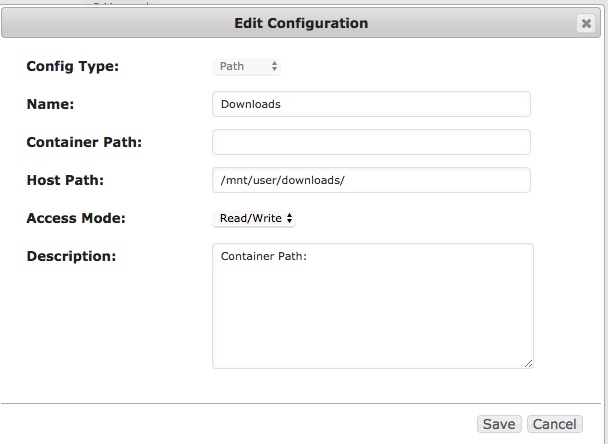

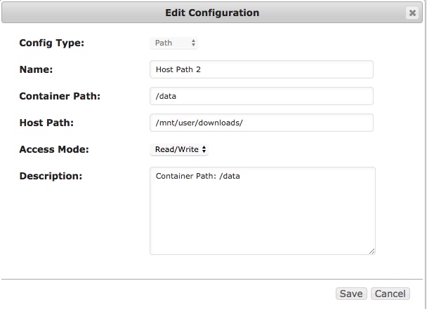

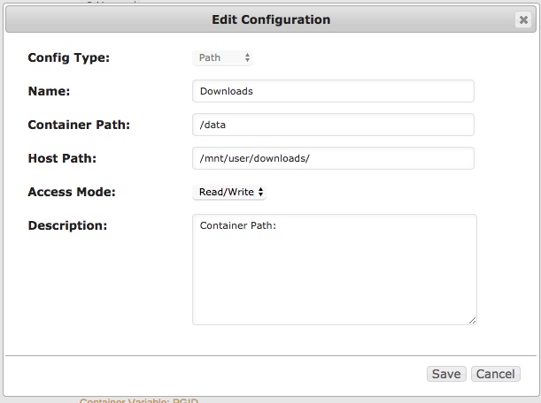

Edit the volume on sonarr and show me a screen shot.  I think you entered in a description and not a container path
Here you go
This is the same one for Sabnzb
I'm guessing I need to add the container path in Sonarr to match that of Sabnbz to /data ?

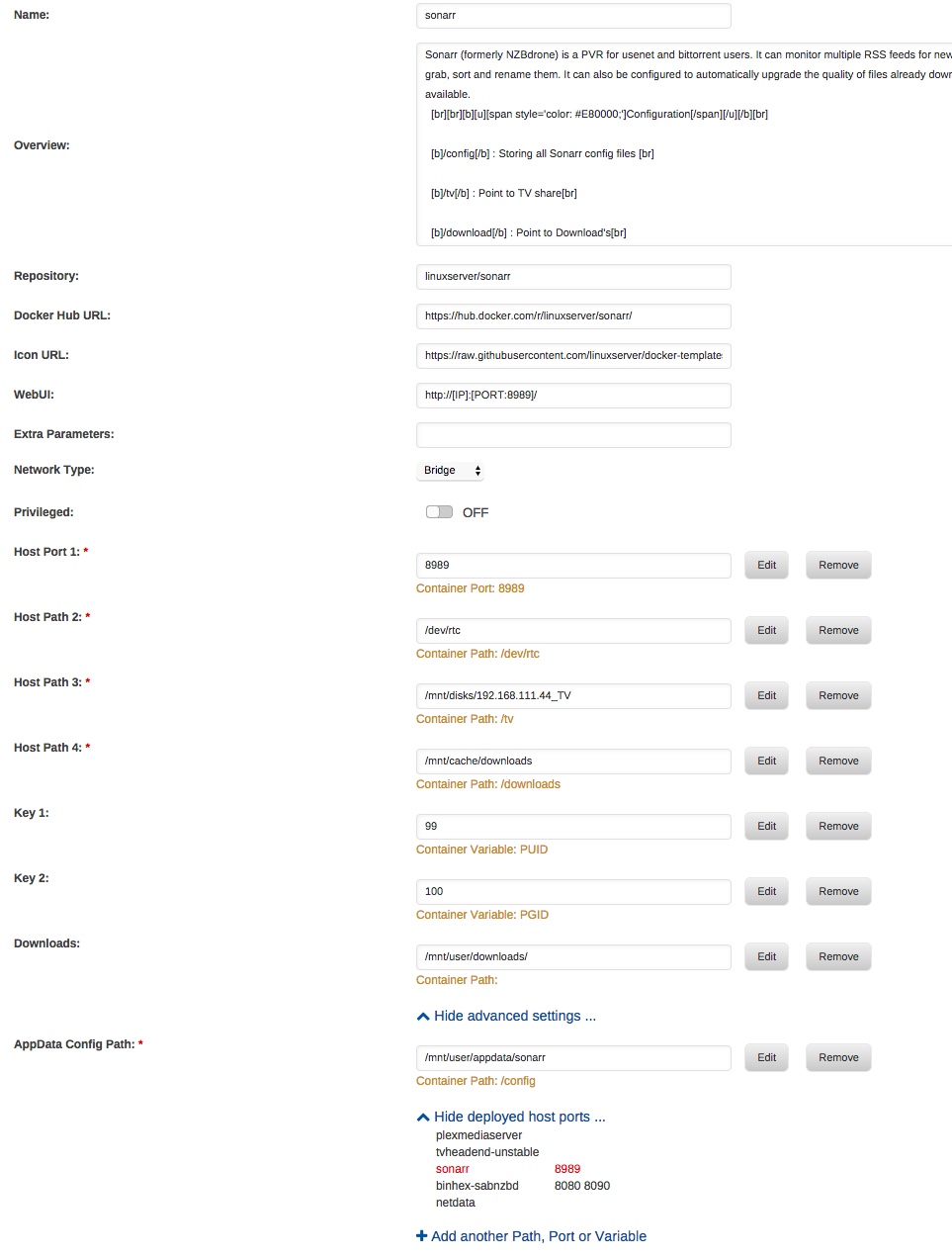

Ok fixed, this is the sonarr container now, correct?
What are the next steps now with sonarr and the folder mappings?

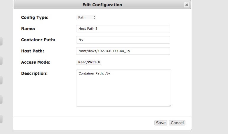

So I mounted a share and updated the sonarr container path, does this look correct now?
I got it working properly, thanks so much for your help.

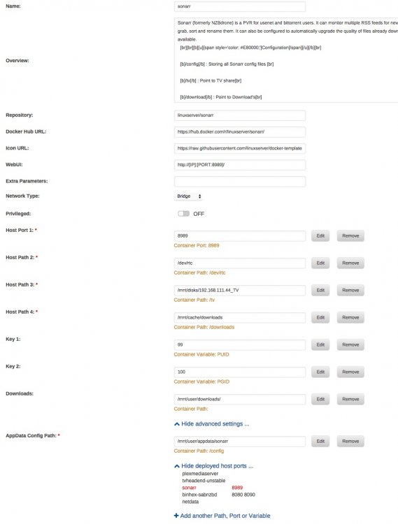

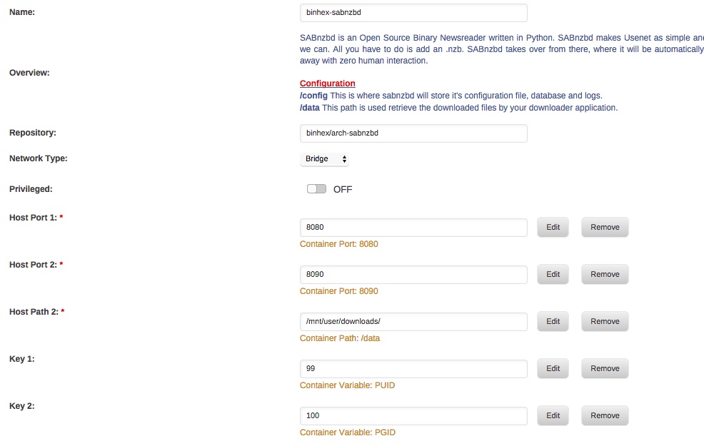

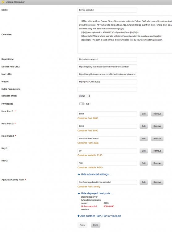

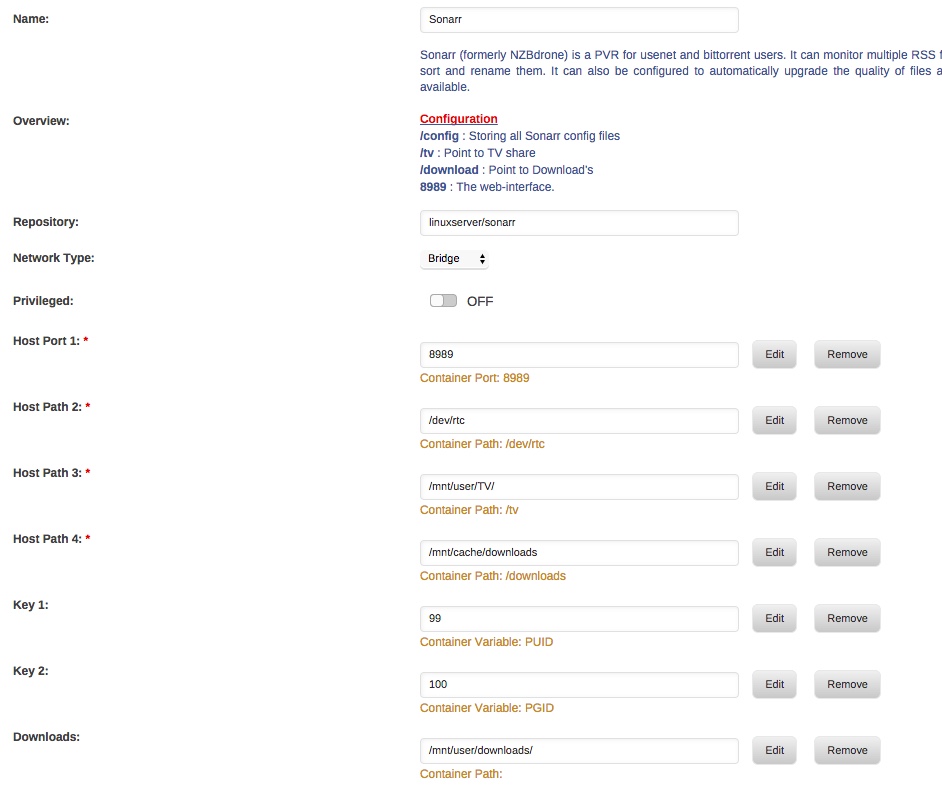

Ok here are my dockers, where have I gone wrong?
