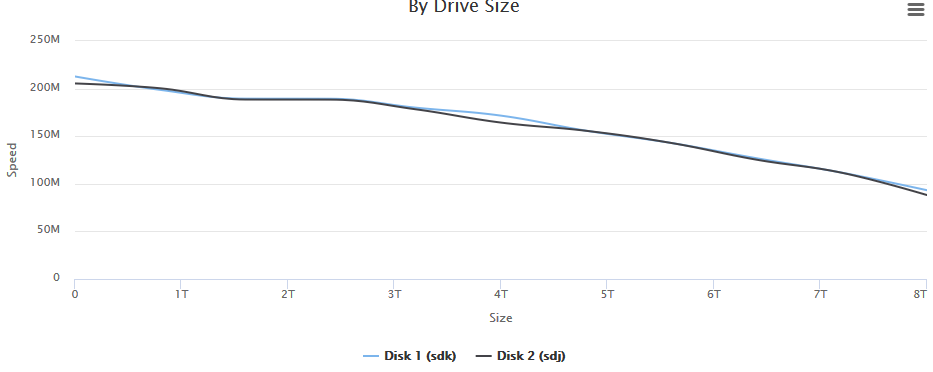

After getting a complete benchmark I am wondering how to interpret the graphs? I have a few drives that are not a smooth gradual slope but have a hump in them. Does this mean I should be looking to replace those drives?
Share a picture. If the hump is at the start, some Seagate drives are like this where the first 25GB-50GB is much slower.
Keep an eye on the drive and see if the graph changes over time.

Both of these drives are Seagate Archive 8TB drives. Don't see much of a hump in any other drive on the array. I should also say the benchmark was done at the 25% so may not be real accurate.
I've got two of those drives. My benchmarks show similar lines.
That gives me an idea.
If the drive's curve is different than average by a certain amount, flag it for further attention. That way we know for certain that a weird looking curve may be in fact "normal" for that specific drive model, and not worry about it.
That's something the scans from the HDDB will show. I've received a feature request to include the scans from the HDDB to compare with a drive benchmark which will show if someone's drive is outside of the norm.
http://strangejourney.net/hddb.cfm?View=models&Vendor=Seagate&Model=ST8000AS0002
