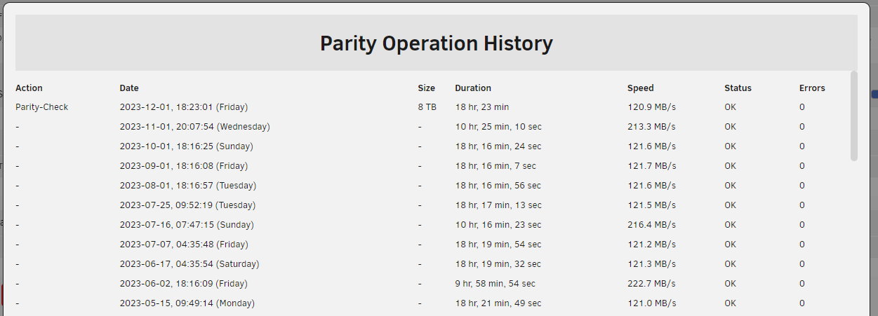

  4. I've noticed that my parity check speeds are usually consistent at about 121 MB/s, however I occasionally have a parity check that goes MUCH faster, over 200 MB/s. Any idea what causes the inconsistencies? Or maybe a better way to ask it - how can I speed up my parity checks? See attached image for history.
