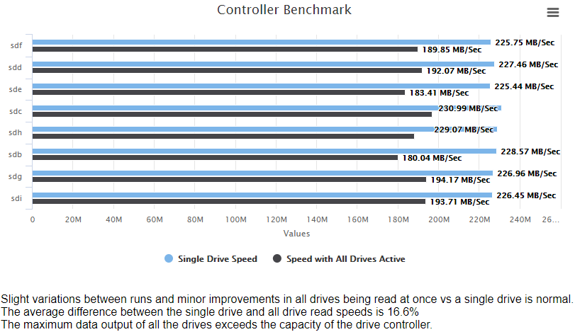

For the Controller Benchmark, the application performs a read of each drive attached to the controller in sequence for 15 seconds each. Then all drives are read simultaneously for 15 seconds. If the sum of the percentage difference between all of the drives exceeds 5%, your controller bandwidth is likely being saturated and you're not getting the full possible performance (such as during a Parity check).
This can help you plan your drive to controller assignment.
Example of a Controller's bandwidth not being saturated:
Here's my main rig with 8 WD Red Pro 6TB's attached and saturating the controller
Just want to say thanks! Working great. The new controller benchmark is much easier to understand and overview.
My rig gives me average difference 0.1%

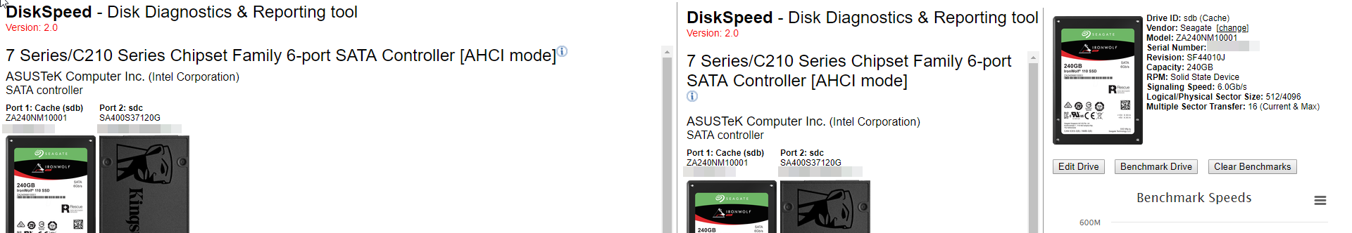

One small thing, when you change the vendor name for SSD's, pressing "Save" result in this:
Capture_DiskSpeed_-_Google_Chrome_2019-07-31_22-11-28_08865266.thumb.png.874c4b3b85e3f16fe03ad6d11200bb09.png
Edited by Niklas
For some reason, I added a save path in the drive latency check script which overrode where it was saving the benchmark log files. This affects everyone on yesterday's update. I didn't notice because I had previous scans and I just saw a graph and figured it ok. I'll add temp code to version 2.1 which will clean up those files though they're harmless as-is. A clean reset will also remove them. Version 2.1 or 2.2 will introduce the ability to restore previous benchmarks and selectively remove existing ones as well as removing the Average line.
Thank you. I'll get a fix for this in version 2.1

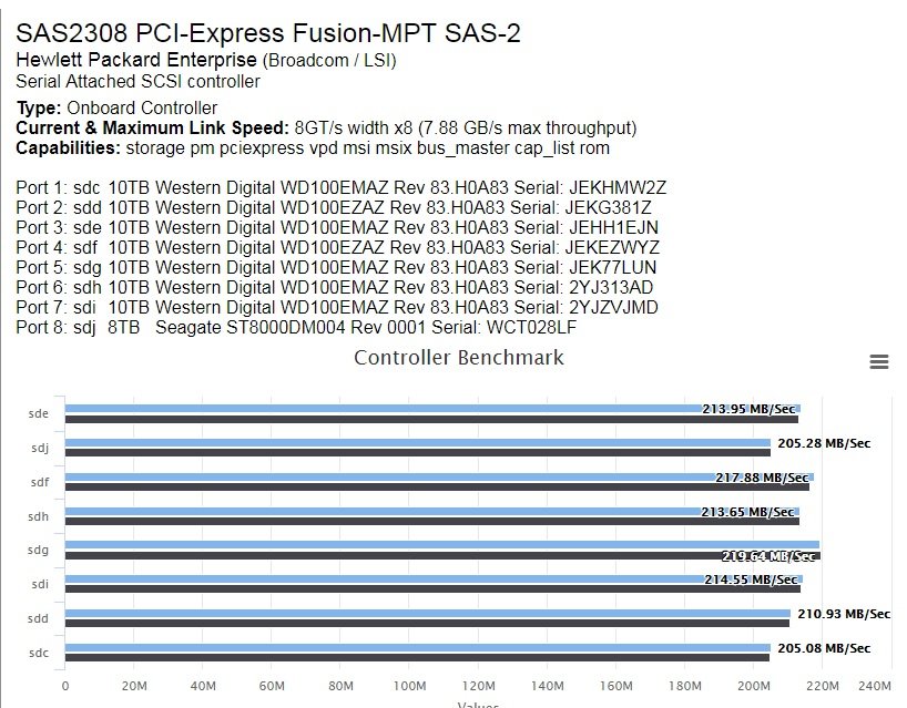

Thank you for this. I like how I can determine how many drives on which controller I can saturate, while maintaining a descent speed for a parity check.
Question I have is, how do I know if I can replace a 8 controller with a 16 controller and still maintain my speed before the 16 get saturated?
I am looking at placing 12 or 13 drives on the 16 but would like to keep the 200+ speed. This would be on my 1 x PCI Express 3.0 x16 slot. Would this be possible? My specs are in my signature.
Edited by Harro
add txt.
Good question. You'll have to look up the specs on the new controller to look for hints. It likely will have two controllers which handle 8 drives each. You're currently using 1.7GB/sec which is significantly less than the bandwidth of 7.88GB/sec available - so you're not likely to exceed that with spinners but there might be an internal limit to a controller. If I would hazard a guess, I would guess a sixteen drive SAS controller would be up to the task.

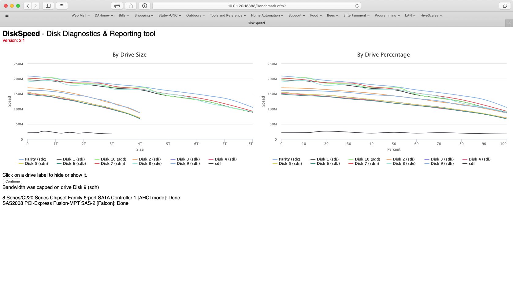

I installed this docker as you suggested in the UTT thread. No idea how to interpret the results though.
sdf is an external drive connected via esata if that matters.
Sorry. Realized I had run the wrong benchmark tests.
Controller benchmarking shows a variation of 3.3% on the onboard controller (Your controller is not bottlenecking) and a variation of 0.0% on the dell H310 controller (Your controller is not bottlenecking). Not sure what the next step would be to resolve the speed issues?
Replace your slowest drives?
