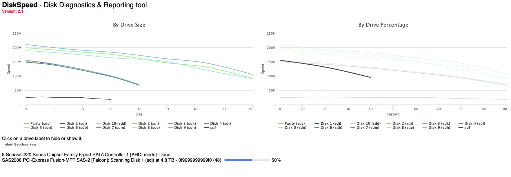

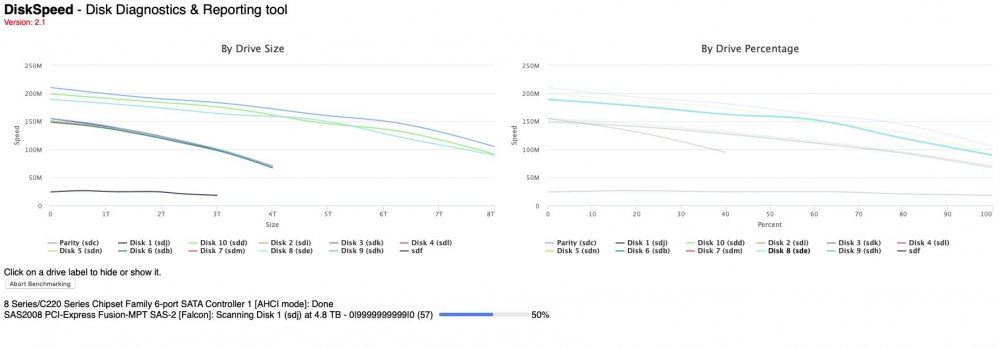

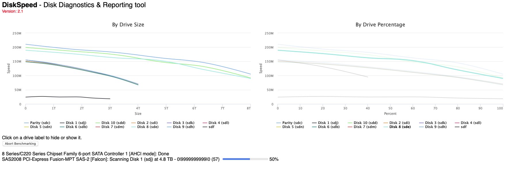

This is a continuation of a discussion in the tunables tester thread.
Ran a speed test with the results shown below. Disk 1 is failing (soon to be replaced) and I couldn't get the test to run past 40% (this was the third try), but it doesn't look good to me.
Disk 8 is the same model and to me it should have similar characteristics but doesn't.
There is a difference of almost 25% at the start of the test and it increases rapidly up to the 40% mark where the test stalled.
Opinions?
Does swapping cables from Disk 1 and Disk 8 impact the speed test on the valid disk 8 any?
When you click on the Benchmark all drives button, uncheck "Check all drives" and only check "Disk 1". Set the checkbox for "Disable SpeedGap detection".
SpeedGap is logic that checks the high & low speeds of each test iteration. If it's over a given threshold (starting at 45MB), it considers the drive having been accessed and retries with a slightly larger threshold - and it will repeat ad nauseum.

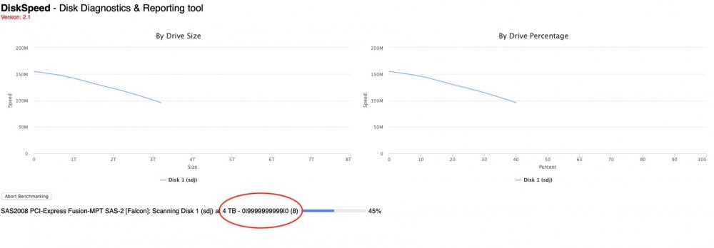

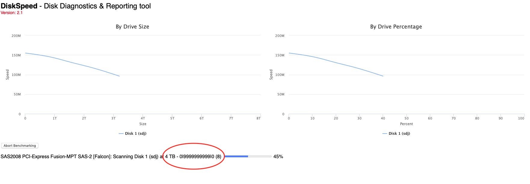

This is as far as the test gets-
Not sure what the number that I circled represents. The trailing number "8" will continue to progress upwards. It got up to "255" on the last test after running all night.
I'll need to dig into the code but I suspect it's just a formatting error.
Telnet into your server and enter the following command, verify that Drive 1 is still sdj
dd if=/dev/sdj of=/dev/null bs=1M skip=3000000 iflag=direct status=progress
This will start a disk read of your drive starting at around the 3TB mark where you got a successful read and try to read to the end of the drive with progress updates roughly every second and giving how much data was read in the last second.
You have some kind of media error on the drive in the middle where the read speeds are likely extremely variable. If you see this reproduced, run a long SMART test on it. I would avoid putting any data on this drive.

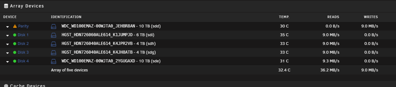

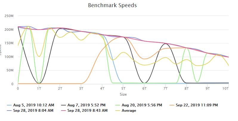

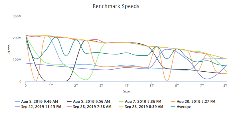

I'm hoping some of you guys might have some insight on what is going on. So I ran the DiskSpeed test multiple times on all my drives but constantly it showed my Parity and Disk4 was very slow. This caused my parity checks to double in length the past few months because it would slow down to 3.5MB/S for hours and then ramp back up to 150MB/S. I figured I would need to replace both the Parity and Disk4. I started to preclear a new 10TB drive that I was planning on replacing my parity with and move all the contents from disk4 to disk5 so I can shrink the array. After waiting a couple days to move everything from disk4 to disk5 (remember it fluctuates from 3.5MB/s to 50MB/s max.. even with turbo write on), I finally have Disk4 empty. Before I send it back for RMA I decide to do a diskSpeed test one last time...shockingly all my drives are now running at full speed and I'm not even sure if I need to replace my Parity or disk4 anymore...Does anyone know the reasons why this might be the case? I'm afraid that it could be because Disk4 is currently empty and once Disk4 is no longer empty it will start to slow down dramatically again.
The differences I can only think of is (I ran DiskSpeed without any other docker containers running.) I thought this could be the reason so I started up all my docker containers and re-ran the tests. It still ran at full speed.
Another change I did was change the tunables in Disk settings from
Tunable (md_num_stripes): 1xxx  to
Tunable (md_num_stripes): 8192
Here are the results for Disk4 and Parity.
Disk4:
Parity:
That ... that is weird. I've never seen anything like that. Even if every other drive was being pounded at the same time, you wouldn't see something like this.
Your Tunable's won't affect it because it doesn't go through the unraid driver to access, it's a straight dd read using a block size given by the drive as being the optimal size.
The drive might not be bad. The only thing I can think of is to try pinning some CPU's to the docker to see if it cleans it up if it happens again. I'm also assuming that you didn't have any CPU intensive tasks going on or no VM's taking all the CPU's away.

I don't think it's the DispSpeed utility that is incorrect because the past few months my parity checks have been extremely slow (fluctuating between 3.5MB/s to 50MB/s) and now when I try to do a parity check it runs at 150-200MB/s full speed with no fluctuation. Should I still replace the parity just in case? I think the read speeds are fine but write speeds still seem to be slow because when copying from cache drive to disk4 it is writing at 30MB/s. From my understanding DiskSpeed doens't test for write speeds only read.
That's correct, my utility only does non-destructive reads. If you want to identify if Disk 4 has issues and remove the Parity drive from the equation, carefully recreate your array without Disk 4. The parity rebuild speeds will tell you if the Parity drive is the issue. If it looks good, mount the old Drive 4 using the UD plugin and copy files to it to see if you can duplicate the slow writes.
While the Parity is rebuilding, you can also kick off a long SMART test on the old Drive 4. If everything still looks good, take the array offline and kick off a long SMART test on the parity drive and all of the others for a shiz-n-grins sanity check.

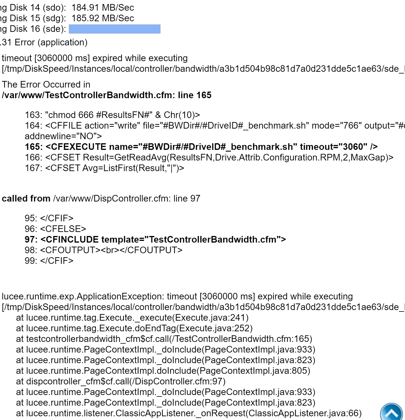

Hi all, hopefully you will be able to help.
Just upgrade my unraid rig from two sas controllers to a single 24 port controller.
I am trying to complete a controller benchmark but it keeps failing about 2/3 of the way through with a timeout error.
I suspect it is because of a software constraint set by Diskspeed for the controller test as all drives pass testing with good speed and no other errors when run individualy for each drive. It fails around drive 16 of 24 every run through.
Is there a config value i could change to increase this timeout limit (if that is the actual problem) to aproximately double to enable a full run through of the 24 drives.
Thanks for your help :)
I didn't know there was a 24 port controller. I have the timeout set to five minutes to try to nip any rogue processes in the bud but at 24 drives testing for 15 seconds each, it would take at least six minutes to do a complete pass.
I've updated the default timeout to ten minutes. I just pushed version 2.3 - please update the Docker and try again.
