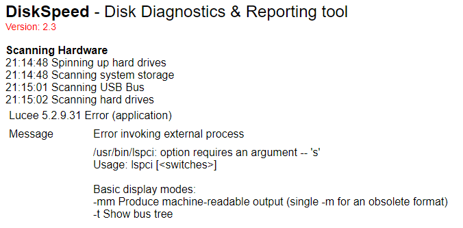

Hi @jbartlett- has there been progress on this issue? I'm seeing the same issue ("usr/bin/lspci: option requires an argument -- 's') so I thought I'd ask.
Thanks!
I need more information from you. I put in the same version of the card as yours but did not get the same drive breakout paths on the OS. Please describe everything between your motherboard and the hard drive.
Thanks for taking the time! (Just to avoid confusion, this particular issue was first reported by @electron286 , I was asking about progress since I bumped into same issue).
At any rate, I found the problem, at least in my case. My setup includes a floppy drive, which is a platform-connected device. Seems like ScanControllers.cfm device tree parsing is slightly confused by this.
What you get in ls -l /sys/block for this device looks like this:
fd0 -> ../devices/platform/floppy.0/block/fd0
Once instructed to ignore such devices, the scanning process completes happily and everything starts to work flawlessly.
Below is a proposed patch to ScanControllers.cfm.
Again, thanks for building and maintaining this fantastic tool over the years!
--- ScanControllers.cfm.orig    2019-08-07 06:57:04.000000000 +0300
+++ ScanControllers.cfm 2019-10-09 10:49:20.150512121 +0300
@@ -388,7 +388,7 @@
 <CFFILE action="write" file="#PersistDir#/ls_sysblock.txt" output="#BlockDevices#" addnewline="NO" mode="666">
 <CFLOOP index="i" from="2" to="#ListLen(BlockDevices,Chr(10))#">
        <CFSET CurrLine=ListGetAt(BlockDevices,i,Chr(10))>
-       <CFIF FindNoCase("virtual",CurrLine) EQ 0>
+       <CFIF FindNoCase("virtual",CurrLine) EQ 0 AND FindNoCase("platform",CurrLine) EQ 0>
                <CFSET DrivePath="/sys/" & ListDeleteAt(ListLast(CurrLine,">"),1,"/")>
                <CFSET CurrDrive=Duplicate(Drive)>
                <CFSET CurrDrive.DevicePath=DrivePath>

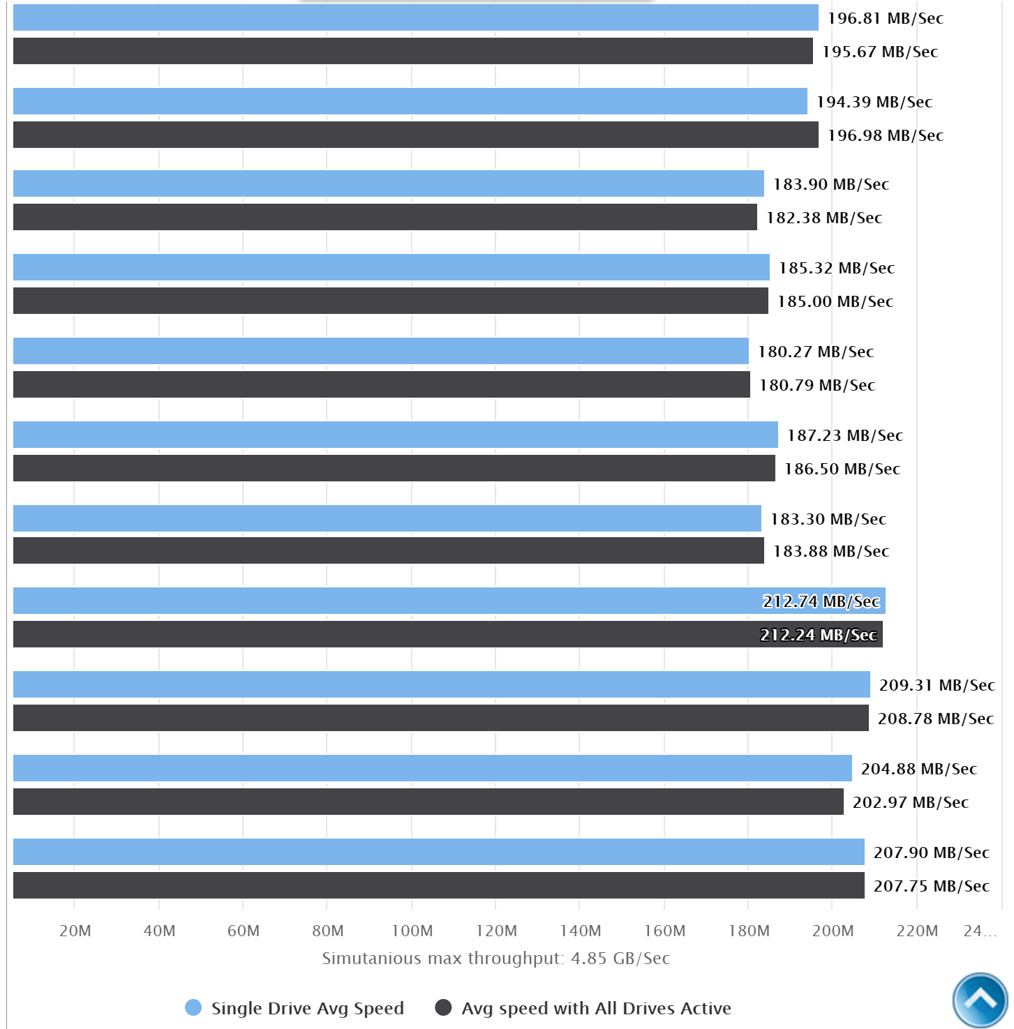

5 hours ago, jbartlett said:
I pushed an update after pulling up BeyondCompare to do a code sync but didn't actually sync the code. That'll teach me to try to work on bugs after being up for nearly 24 hours after a whirlwind vacation of New York City & Long Island! Try again, I show 2.3 on my main rig.
Instead of just increasing the timeout to accommodate your rig, I just bumped it up to 9999 seconds for the controller benchmark (2.78 hours).
Haha, Happens to the best of us :)
Update worked a treat! thanks for your help.
I can now rest easy at night knowing im getting full throughput from my drives, all 4.85GB/s of it!!!!
Also good to know i have some theoretical headroom of about 3GB/s for future expansion through expanders if i ever find a case to support that many drives.
Thank you for supporting such a useful tool.

Version 2.4: Added changes submitted by @doron which should help those who got the "-s option" error by ignoring "platform" devices
  • Display the correct throughput value when both the controller LnkSta & LnkCap are the same (current & max link speed)
  • Reference table for PCIe controller link speed max throughput updated to add x32
  • Omit "platform" devices such as floppy drives from the scan
  • Ignore "Logical/Physical Sector size" returned from hdparm as it does not properly handle SAS drives. Will implement a better fix later when I get a SAS drive

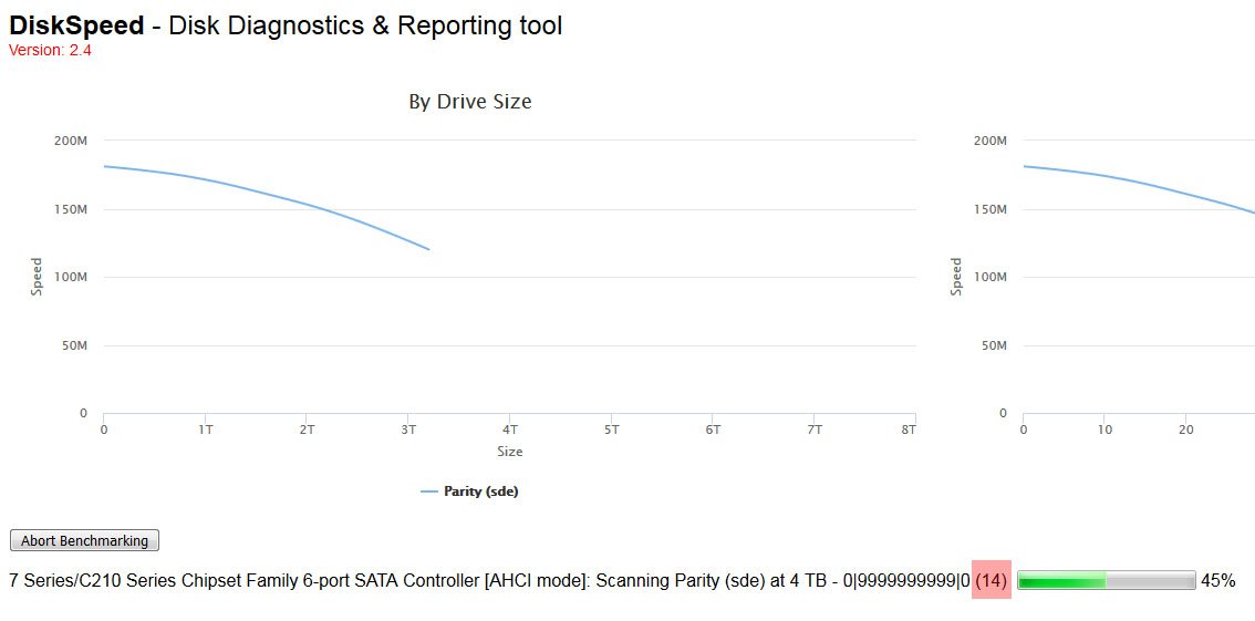

I have also a weird problem here...
Using unraid v6.8.0-rc6 and got this (see picture) when i check my 8TB-Parity drive...
The red marked number increases slowly but nothing else happens...
Edited by Zonediver
Kick off a benchmark from the main screen, select your parity drive and at least one other drive. There needs to be at least two drives being benchmarked for the following to be displayed: "Click on a drive label to hide or show it."
The period at the end of a line is a hidden hyperlink which unhides the iframes that is doing the actual work. That will give additional detail as to what's going on.
Thanks for your reply - i did what you said but there was something wrong - i got a Java-Error...
I restarted the docker and now its working again 👍
