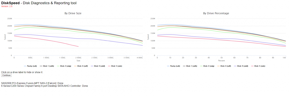

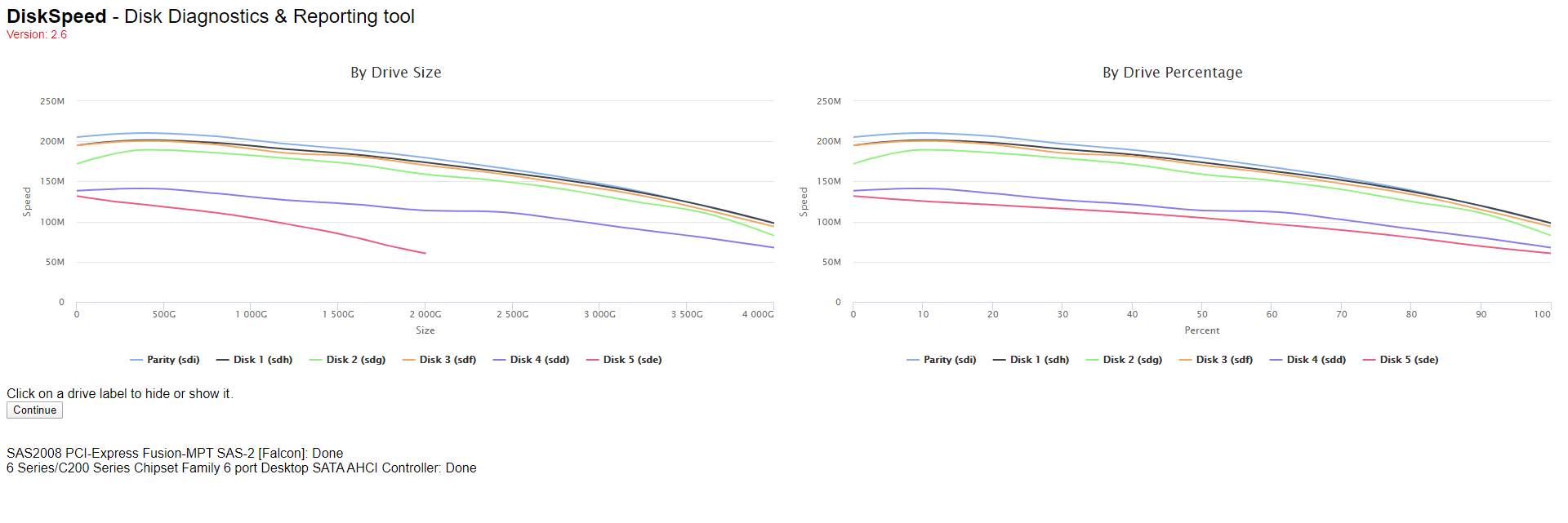

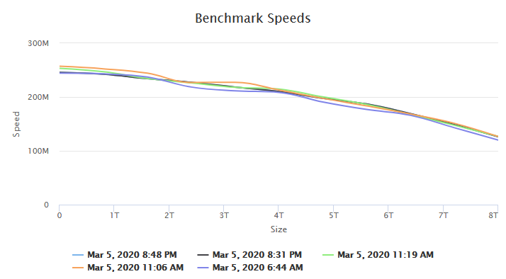

7 hours ago, jademonkee said:
Upgraded to v2.5 this morning and thought I'd re-run the benchmarks.
Was receiving 'speed gap' notification, so I aborted, disabled all dockers and re-ran. Still got the 'speed gap' notification, so I aborted, and re-ran with the 'disable speed gap detection' option checked.
The final results page looks vastly different to the last time I ran it, however, going back to the main page, the curves look just as before (almost as if the main page didn't update to the latest results - even after I Ctrl+R refreshed the page).
Please see attached.
So: is it something I should be worried about? I haven't received any notification from Unraid that anything is wrong with SMART, but should I do something to confirm that my disks (or controller?) are ok?
Thanks for your help.

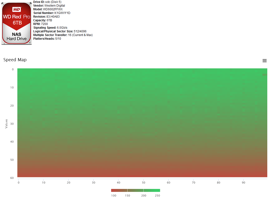

I can duplicate the home page graph not showing the most recent which is odd since I didn't change that logic in a long time. I'll look into it.
I've got one drive that shows the same erratic benchmark, on my backup system which should have zero outside activity against it. I removed the cache popping logic and that changed the results though it still shows some erratic hills but didn't throw the speed gap warning.
Version 2.6 pushed to remove cache popping logic.
Just re-ran the tests on v2.6
Much better results! I didn't receive the speed gap warning, either.
Thanks for the help.

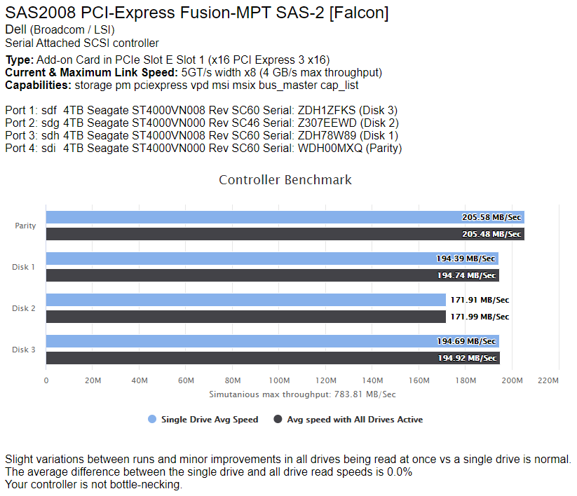

Added controller benchmark results

Found a partial solution....
2 hours ago, AgentXXL said:
Needless to say that has improved things dramatically taking the link speed to 5GT/s vs 2.5GT/s.
2.5GT/s means a PCIe 1.0 slot, if it was also a x4 link instead of x8 it would only have a quarter of normal bandwidth, so big impact is expected.
Yes, I found that the HBA was indeed limited by the PCIe slot. I waded through some logs and saw the link speed at 2.5 and knew something wasn't right. Then I used the DiskSpeed docker to benchmark the controller and it also reported the link speed as 2.5 at the start of the test. Moved the HBA to a x8 slot and it's now running at 5. The Supermicro is certainly an older unit and the previous owner did say it wasn't as fast as they wanted - turned it into a half-decent upgrade for me. Rare to find them locally, especially for the price I paid.
I'm still planning to eventually replace the motherboard with something faster and more modern. I've read a bit about using more than a single cable to the SAS backplane so I'll keep my eyes open for a deal on a better HBA. DiskSpeed also mentioned in the post-controller benchmark that the controller was underpowered for the number of drives I'm using. That gives me more ammo to watch for a better HBA.
For now I'm happier as my disk I/O speeds doubled. After running a full check with the DiskSpeed docker I'm hoping that the tunables can be tweaked to get me even a bit more performance.

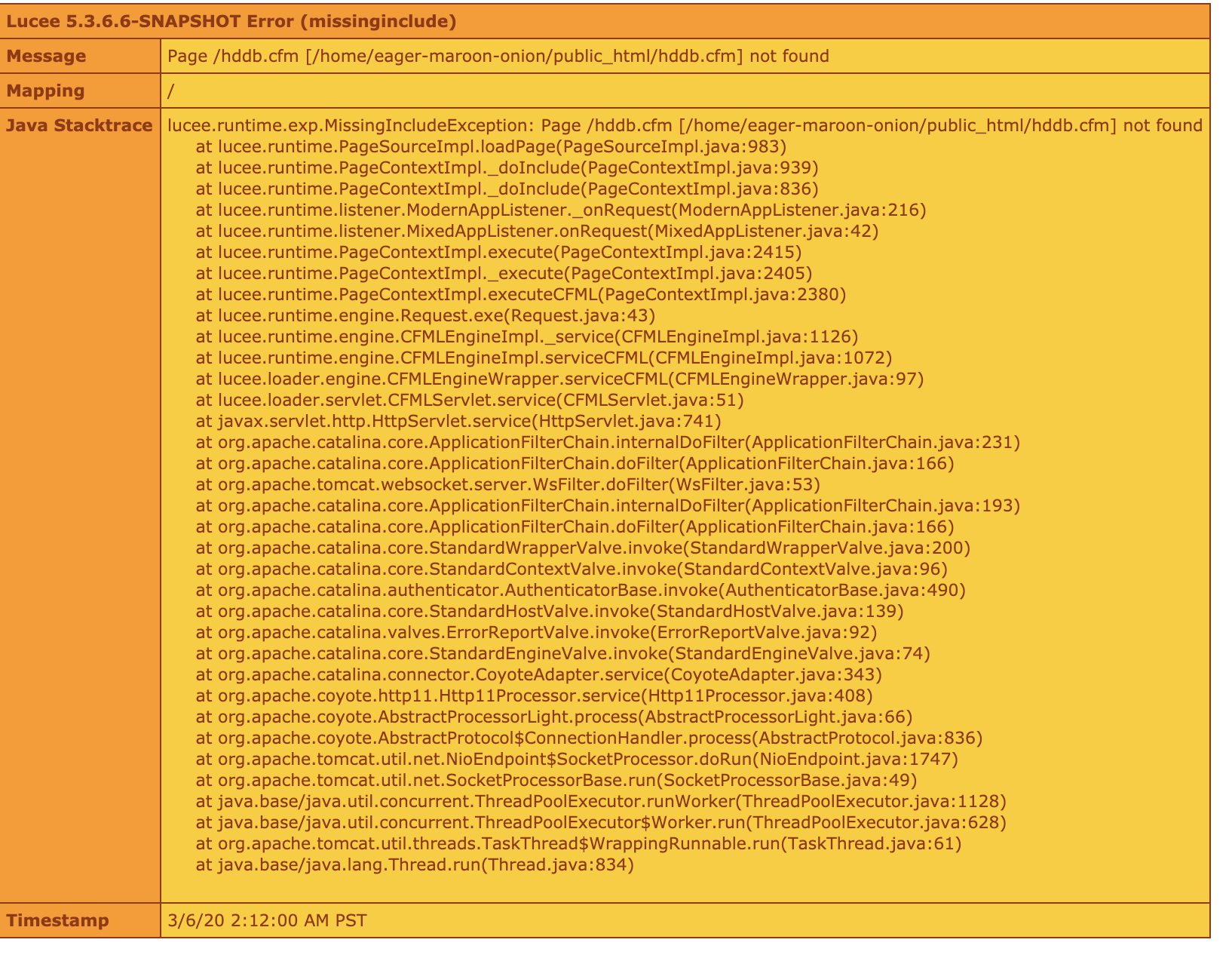

Your website does not work when looking for drive images.
Thank you for bringing it to my attention. I recently moved the backend of the DiskSpeed docker off my web server at home to "the cloud" and I missed that. It's fixed.

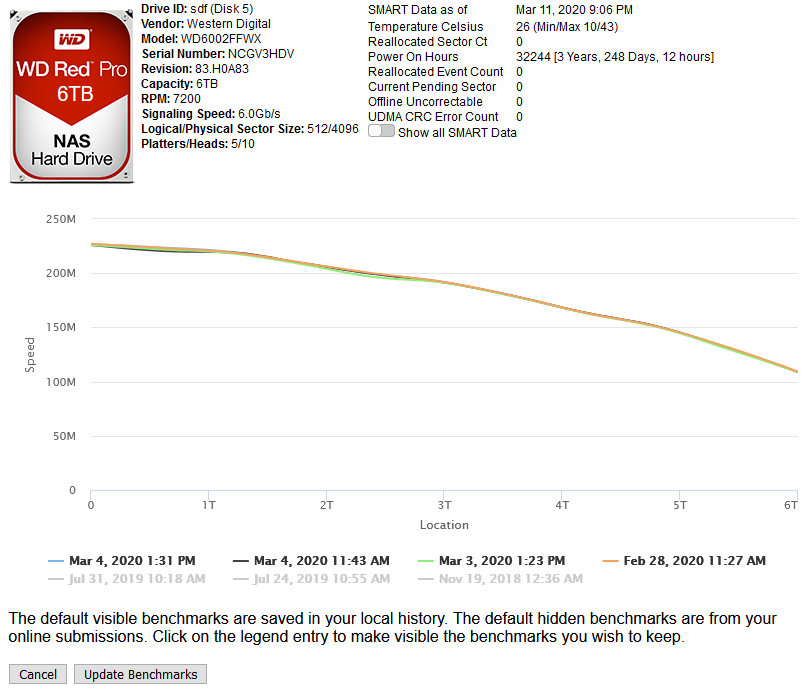

I'm also updating the HDDB to give better graphs where it shows only the last benchmark per person per drive. What's out there now can be messy. Also working on cleaning up the crap drive manufacturers use for their identifications and adding newer drives & their images to ones that people haven't already contributed to the HDDB.

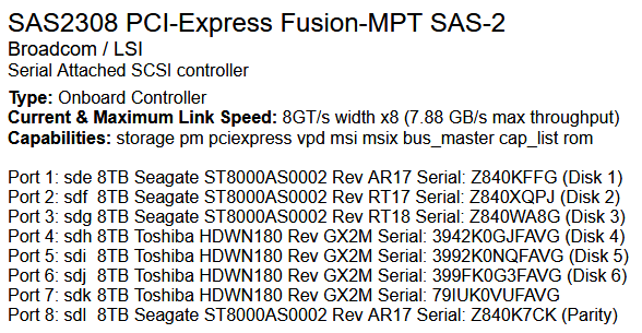

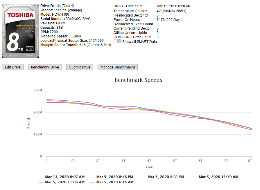

Any idea why my 4 Toshiba N300s get mapped together as far as benchmarks go?
My 4 Segate Archive Drives didn't get lumped together in the benchmarks
Each of the Seagate get their own benchmark speed graph
Each N300 gets all of the N300 benchmarks together in the graph (there's one extra because I got confused as to which one had been benched)
First, have you updated the docker since last night? If not, please do so as I did a lot of rework around the logic that builds the history files for display.
The graph data on each drive is stored independently of each other. To verify, please navigate to appdata/DiskSpeed/Instances/local/driveinfo on your NAS. You should see four directories representing these Toshiba drives
hdwn180_gx2m_3942k0gjfavg_8tb
hdwn180_gx2m_3992k0nqfavg_8tb
hdwn180_gx2m_399fk0g3favg_8tb
hdwn180_gx2m_79iuk0vufavg_8tb
If that is the case, please kick off a benchmark on them (or benchmark all drives from the main menu) on version 2.7+ which will rebuild the history files and should fix your problem.
Using 2.7,
Tried running the benchmarks again, but only got one benchmark run and its still assigned to all the drives.
EDIT: I just ran the controller benchmark, which showed erratic results, and as per the recommendation I restarted the Docker and ran it again: same erratic results (although I think the disks with low speeds were different this time). Attached is a screenshot.
Now that this is fixed in v2.6+, how do I delete the erroneous test results from my result history?
Do I have to purge everything, or can I just delete the erroneous ones?
Thanks.
Thanks.
View the drive(s) in question and click on the "Manage Benchmarks" button. Hide the benchmarks you want to get rid of (or make visible the ones you want to restore).

Currently in development - Drive Heat Maps. Each square = 1GB. Each line here is 100GB. Color represents MB/s read over that GB. And it looks like I'll be able to tell you what file is located where on the drive.
Initial prototype. I'm currently going through my old drives trying to find one with a speed dip.
Edited by jbartlett
Very cool, if you need help testing I have have some disks with known slow sectors.
