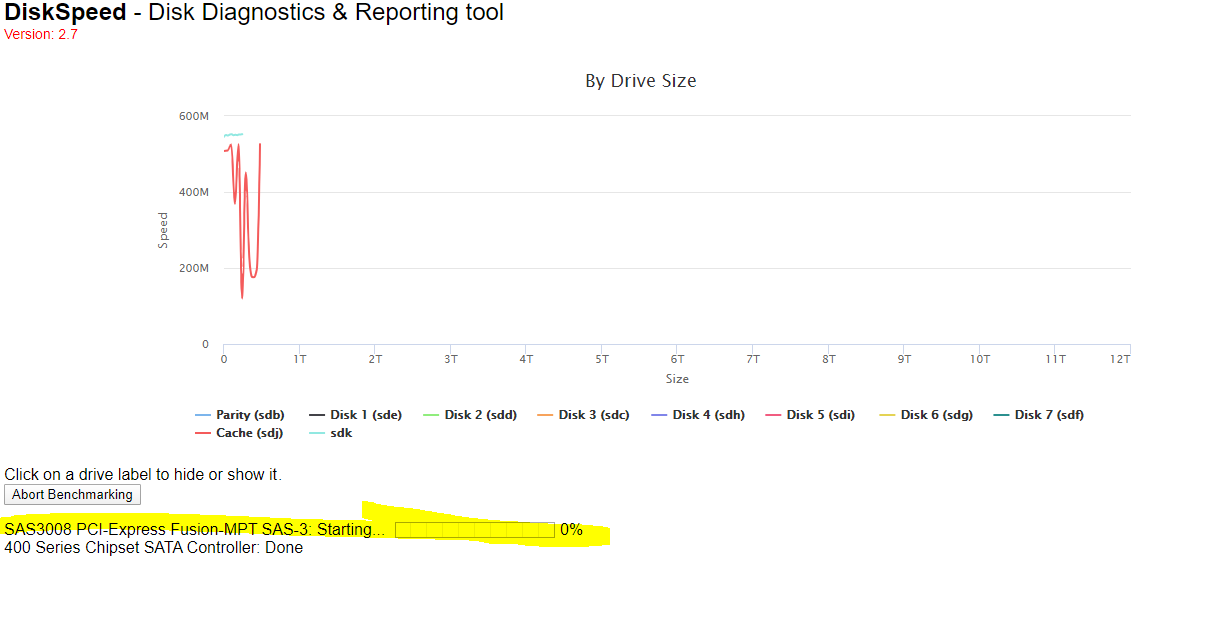

Found this great app today but am having a few problems with it on an LSI 9300-8i. It seems to benchmark the 2x SSDs (cache and unassigned for plex) that are connected directly to my motherboard but the 8x drives connected to my HBA (LSI 9300-8i) are not scanned. It just seems to hang here. 30 minutes and counting.
Incidentally, the controller and drives are accurately represented at the beginning before starting the benchmark. Maybe I'm doing something wrong?
See the period at the end of the line "Click on a drive label to hide or show it." ? There's a hidden link on that period that when clicked on will make visible the hidden iframes that are doing all the actual work. You'll be able to see if there's an error or not or what's happening.
It sounds like the drives are properly being detected but there's an error happening when it's trying to do read tests against the drives on that controller.
Copy-n-paste any error message. You do not need to copy-n-paste the Java stack trace.

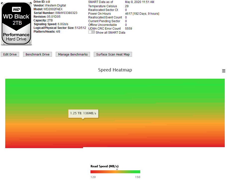

I'm working on a surface read speed heatmap right now, then plan on working on a drive utilization map which can help pinpoint what files are located on bad sectors.
The heatmap looks pretty incredible i'll grant you that.  I have a few wobbly seagate SAS drives, which I will be moving out of service, but would probably be sufficient to test on if you want some feedback.  Albeit i'm waiting on some new breakout cables first.  Had quite the ride moving hardware the last week....
