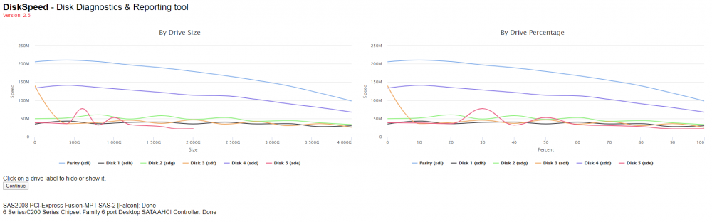

The difference between new WD Red (shucked White WD100EMAZ) and an older WD Green WD10EACS is hysterical.

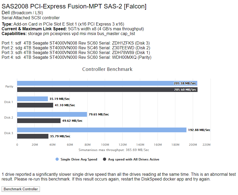

Curious why the cache disks performed so poorly during simultaneous vs. individual.
Only thing notable is they're in the 2 rear chassis bays instead of in the 12 up front.
My guess is that the read speed of the faster drives were capped by the OS in order to maximize the output of the other slower drives. Gives better overall performance. You're only utilizing 2GB of the stated 7.8GB bandwidth so you may have a bottleneck elsewhere in the PCI chain.
Guess it could be the expander in the drive cage; H240 is a 2x4 12Gb/s lane controller, but the cage is 12+2.
Trying to dig up some info on the cage/expander and see if there's a possible bottleneck there.
Not that it's a big screaming deal; throughput is well above my normal needs as it is

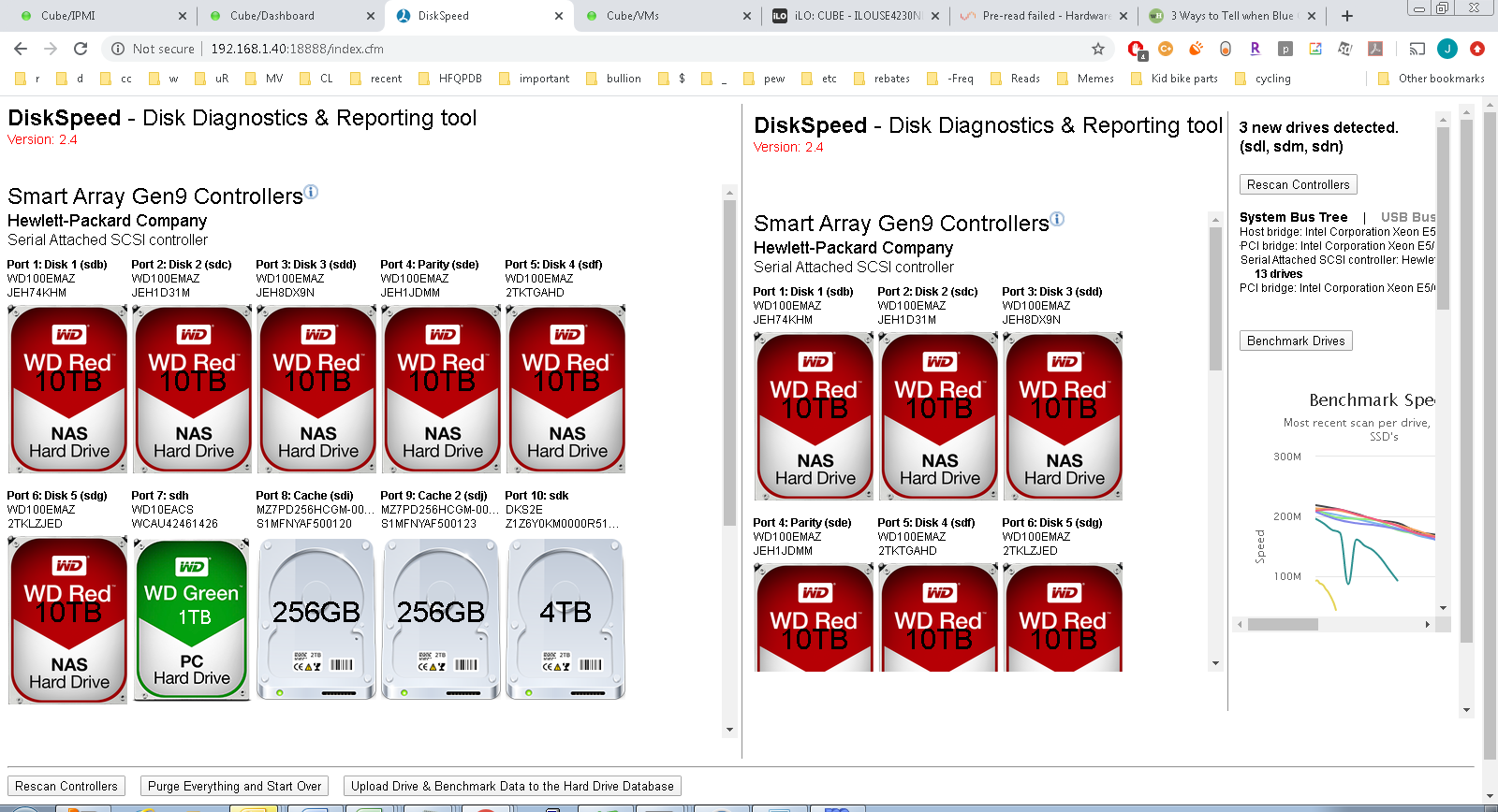

Odd screen error after doing Rescan Controllers
You're behind one version. I believe that's fixed in 2.5.
Whoops, that's my development version.
Edited by jbartlett
so should I do something to update it?  the version says up to date in the Docker screen.
Clicking on the "Diskspeed" header or refreshing the page should fix.

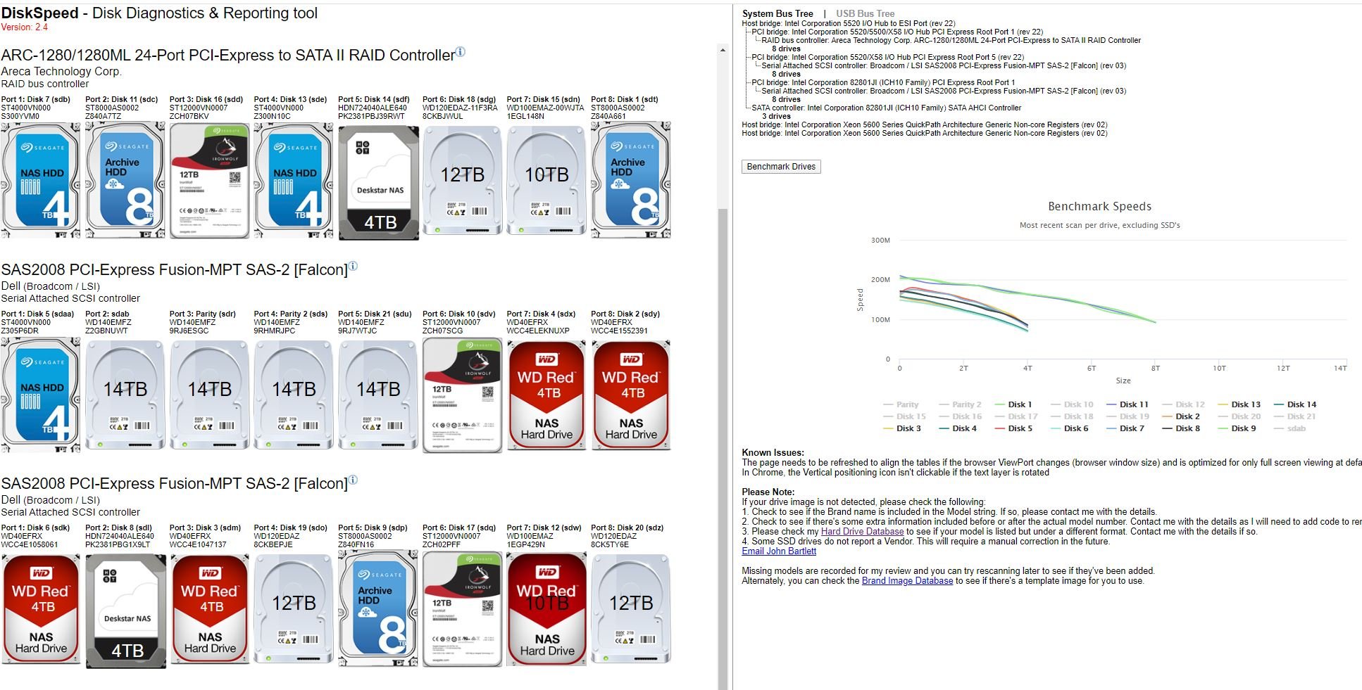

New user, installed on two similar systems, only difference is number of drives.
Default ports does not work for host, need to change port number from 18888 to 8888, else keep getting connection refused.
Fist server no problem with running tests.
Second server crash in what appears to be a timeout waiting for the 20 spinning drives to spin up:
DiskSpeed - Disk Diagnostics & Reporting tool
Version: 2.4
Scanning Hardware
08:25:25 Spinning up hard drives
08:25:25 Scanning system storage
Lucee 5.2.9.31 Error (application)
Messagetimeout [90000 ms] expired while executing [/usr/sbin/hwinfo --pci --bridge --storage-ctrl --disk --ide --scsi]
StacktraceThe Error Occurred in
/var/www/ScanControllers.cfm: line 243
241: <CFOUTPUT>#TS()# Scanning system storage<br></CFOUTPUT><CFFLUSH>
242: <CFFILE action="write" file="#PersistDir#/hwinfo_storage_exec.txt" output=" /usr/sbin/hwinfo --pci --bridge --storage-ctrl --disk --ide --scsi" addnewline="NO" mode="666">
243: <cfexecute name="/usr/sbin/hwinfo" arguments="--pci --bridge --storage-ctrl --disk --ide --scsi" variable="storage" timeout="90" /><!--- --usb-ctrl --usb --hub --->
244: <CFFILE action="delete" file="#PersistDir#/hwinfo_storage_exec.txt">
245: <CFFILE action="write" file="#PersistDir#/hwinfo_storage.txt" output="#storage#" addnewline="NO" mode="666">
called from /var/www/ScanControllers.cfm: line 242
240:
Java Stacktracelucee.runtime.exp.ApplicationException: timeout [90000 ms] expired while executing [/usr/sbin/hwinfo --pci --bridge --storage-ctrl --disk --ide --scsi]
  at lucee.runtime.tag.Execute._execute(Execute.java:241)
  at lucee.runtime.tag.Execute.doEndTag(Execute.java:252)
  at scancontrollers_cfm$cf.call_000006(/ScanControllers.cfm:243)
  at scancontrollers_cfm$cf.call(/ScanControllers.cfm:242)
  at lucee.runtime.PageContextImpl._doInclude(PageContextImpl.java:933)
  at lucee.runtime.PageContextImpl._doInclude(PageContextImpl.java:823)
  at lucee.runtime.listener.ClassicAppListener._onRequest(ClassicAppListener.java:66)
  at lucee.runtime.listener.MixedAppListener.onRequest(MixedAppListener.java:45)
  at lucee.runtime.PageContextImpl.execute(PageContextImpl.java:2464)
  at lucee.runtime.PageContextImpl._execute(PageContextImpl.java:2454)
  at lucee.runtime.PageContextImpl.executeCFML(PageContextImpl.java:2427)
  at lucee.runtime.engine.Request.exe(Request.java:44)
  at lucee.runtime.engine.CFMLEngineImpl._service(CFMLEngineImpl.java:1090)
  at lucee.runtime.engine.CFMLEngineImpl.serviceCFML(CFMLEngineImpl.java:1038)
  at lucee.loader.engine.CFMLEngineWrapper.serviceCFML(CFMLEngineWrapper.java:102)
  at lucee.loader.servlet.CFMLServlet.service(CFMLServlet.java:51)
  at javax.servlet.http.HttpServlet.service(HttpServlet.java:729)
  at org.apache.catalina.core.ApplicationFilterChain.internalDoFilter(ApplicationFilterChain.java:292)
  at org.apache.catalina.core.ApplicationFilterChain.doFilter(ApplicationFilterChain.java:207)
  at org.apache.tomcat.websocket.server.WsFilter.doFilter(WsFilter.java:52)
  at org.apache.catalina.core.ApplicationFilterChain.internalDoFilter(ApplicationFilterChain.java:240)
  at org.apache.catalina.core.StandardWrapperValve.invoke(StandardWrapperValve.java:212)
  at org.apache.catalina.core.StandardContextValve.invoke(StandardContextValve.java:94)
  at org.apache.catalina.authenticator.AuthenticatorBase.invoke(AuthenticatorBase.java:492)
  at org.apache.catalina.core.StandardHostValve.invoke(StandardHostValve.java:141)
  at org.apache.catalina.valves.ErrorReportValve.invoke(ErrorReportValve.java:80)
  at org.apache.catalina.valves.AbstractAccessLogValve.invoke(AbstractAccessLogValve.java:620)
  at org.apache.catalina.valves.RemoteIpValve.invoke(RemoteIpValve.java:684)
  at org.apache.catalina.core.StandardEngineValve.invoke(StandardEngineValve.java:88)
  at org.apache.catalina.connector.CoyoteAdapter.service(CoyoteAdapter.java:502)
  at org.apache.coyote.http11.AbstractHttp11Processor.process(AbstractHttp11Processor.java:1152)
  at org.apache.coyote.AbstractProtocol$AbstractConnectionHandler.process(AbstractProtocol.java:684)
  at org.apache.tomcat.util.net.AprEndpoint$SocketWithOptionsProcessor.run(AprEndpoint.java:2464)
  at java.util.concurrent.ThreadPoolExecutor.runWorker(ThreadPoolExecutor.java:1149)
  at java.util.concurrent.ThreadPoolExecutor$Worker.run(ThreadPoolExecutor.java:624)
  at org.apache.tomcat.util.threads.TaskThread$WrappingRunnable.run(TaskThread.java:61)
  at java.lang.Thread.run(Thread.java:748)
Timestamp2/20/20 8:29:32 AM PST
I have found it necessary useful to first "spin up all drives" for anything that needs to check every drive before doing whatever (like diskpeed does). Even reboots are faster if you just spin them all up first. It avoids both possible time outs or errors waiting for drives to respond as well as contention between reading and spinning up multiple drives.
ps. 15 drive array. may not be as much of an issue with fewer drives?
Edited by interwebtech
I tried to implement's unraid's version of spinning up a drive but had issues with it but that was a bit ago, should try again. The way it works now is to issue a dd command to read random sectors on the drive but I've noticed that even those that seems to execute without issue, drives aren't always spun up.
I have no problem using the spin up or spin down buttons, so whatever unraid is doing does work.

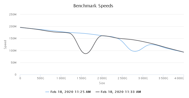

I have a weird one.
Drive ID: sdk
Vendor: SEAGATE
Model: DKS2E
Serial Number: Z1Z6Y0KM0000R5191JBJ
Revision: 0
Capacity: 4TB
Logical/Physical Sector Size: 512/512
Two different runs, both times it "glitched".
Disk wasn't even assigned to anything or partitioned at the time.

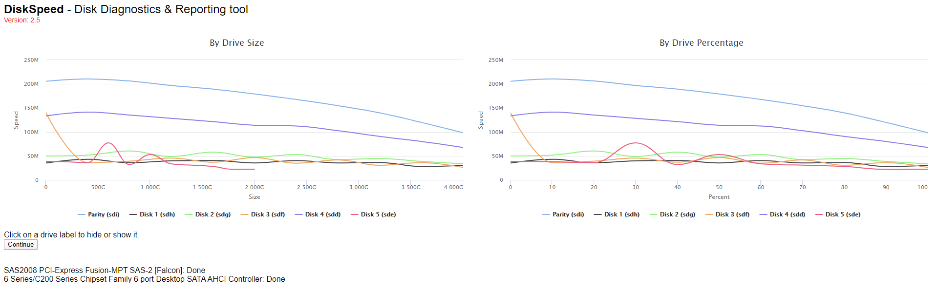

Upgraded to v2.5 this morning and thought I'd re-run the benchmarks.
Was receiving 'speed gap' notification, so I aborted, disabled all dockers and re-ran. Still got the 'speed gap' notification, so I aborted, and re-ran with the 'disable speed gap detection' option checked.
The final results page looks vastly different to the last time I ran it, however, going back to the main page, the curves look just as before (almost as if the main page didn't update to the latest results - even after I Ctrl+R refreshed the page).
Please see attached.
So: is it something I should be worried about? I haven't received any notification from Unraid that anything is wrong with SMART, but should I do something to confirm that my disks (or controller?) are ok?
Thanks for your help.
EDIT: I just ran the controller benchmark, which showed erratic results, and as per the recommendation I restarted the Docker and ran it again: same erratic results (although I think the disks with low speeds were different this time). Attached is a screenshot.
Edited by jademonkee
added controller benchmark
