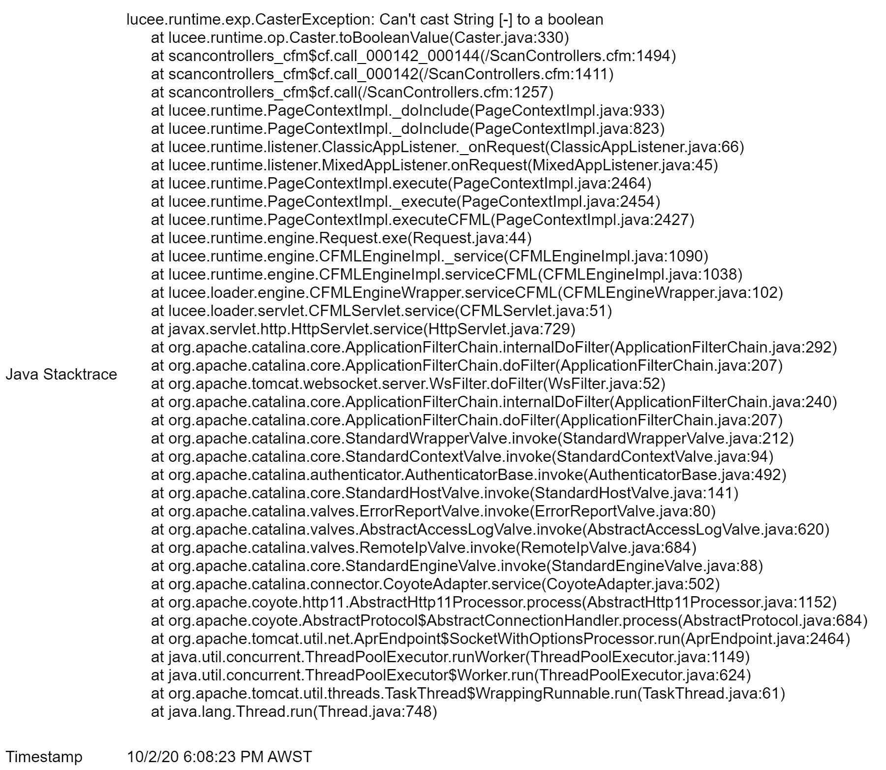

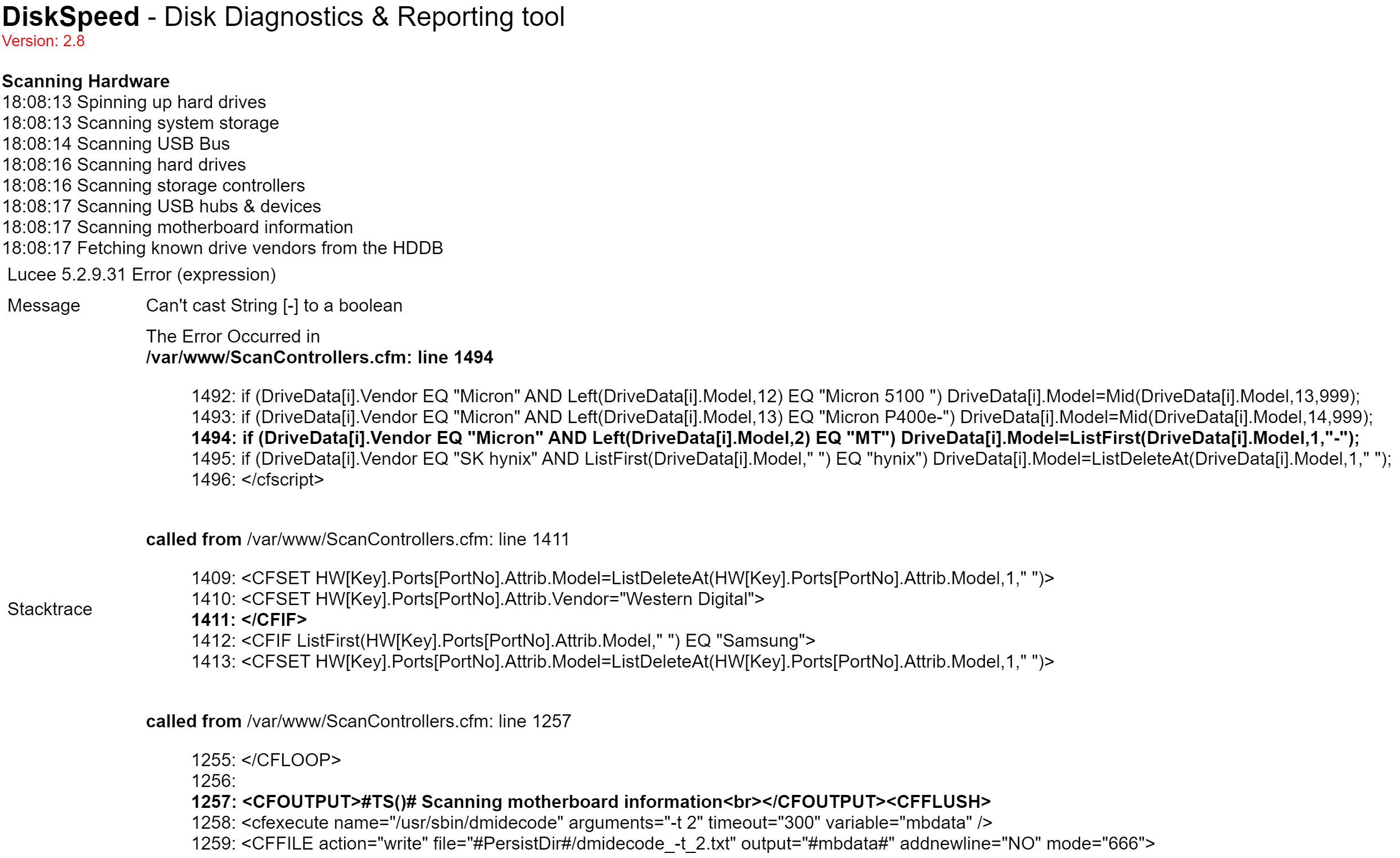

Hi @jbartlett,
Thanks for putting the docker together, I've got it installed on 2x unRAID boxes and 1 works fine but the other does not.
Motherboard: Asus B85M-E
HBA: H310 (flashed to LSI HBA mode)
The SSD's where originally connected to the HBA but I've moved them to the onboard SATA controller and I get the same error message. I think the SSD make/model being identical up until the last 3 digits might be the issue?
Any help would be appreciated :)
I see the issue, it's a typo. It's passing a numeric position to the ListFirst function at the end of the line which doesn't take a numeric position. It's too late for me to push a fix tonight but I'll take care of it tomorrow.
On 10/7/2020 at 1:53 AM, jbartlett said:
@opticon - Go ahead and update the Docker and see if it fixes the issue
It works thankyou :)

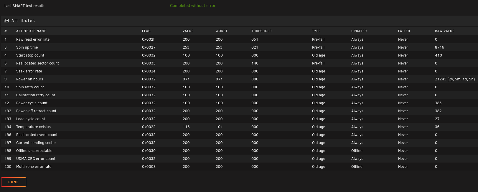

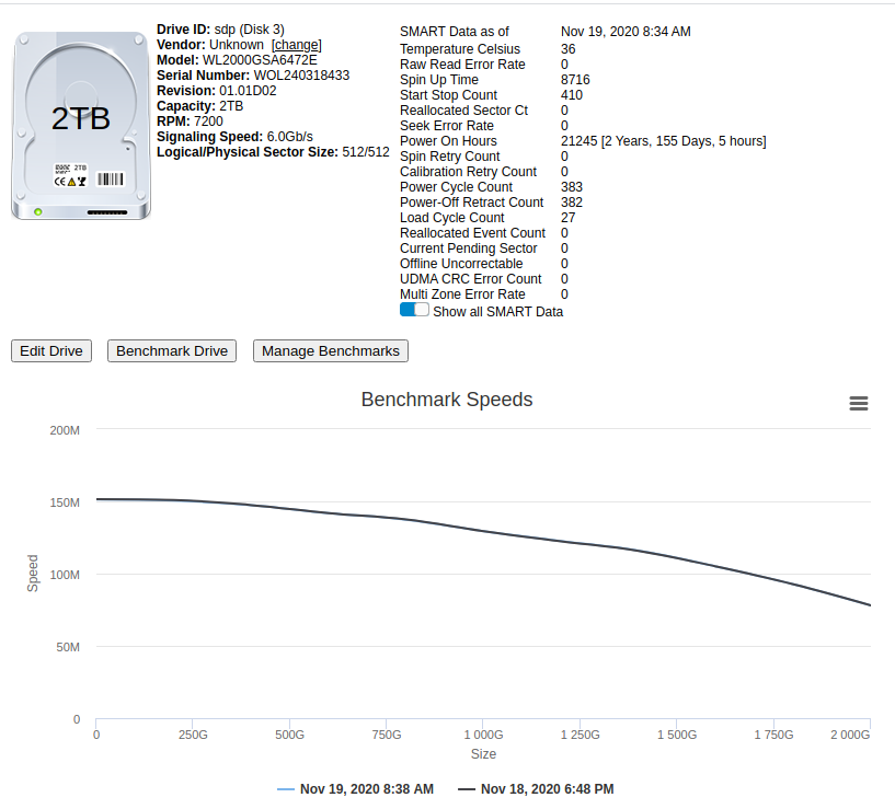

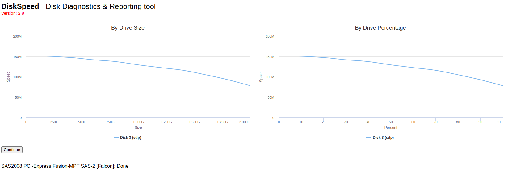

2 hours ago, snowmirage said:
Most tests took in the range of a few min (maybe 5?) but this drives has been stuck at 36% for over half an hour.
Click on the Benchmark button on the main page and uncheck "Check all drives", set the checkbox for Disk 3, and set the checkbox for "Disable Speed Gap detection".
If you frequently get a "retrying" on a spot, its because the min/max speeds at that spot were over a certain threshold and it is retrying that spot again after increasing that threshold by 5mb. Setting the Disable Speed Gap button disables this retry feature. This gap between the min/max speeds is typically caused by some other process accessing the drive at the same time but it can also be caused by a bad spot. I plan on adding a cap to the number of retries.

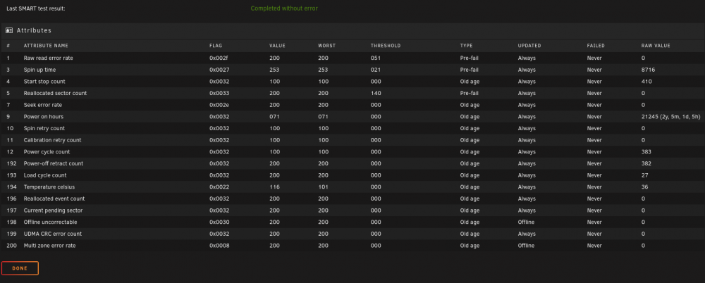

The newest version of this app also displays the SMART information for the drive which by default displays only catastrophic drive health values. Take a screen shot of that and post it. If it's not displaying it, then there's something wrong with the smart report as it gets it from UNRAID and UNRAID isn't saving it. View the drive info on the unraid Main tab to get the smart values.
That seems to have done it.  Test for that drive finished following your suggestions.
image.thumb.png.2625ad4666f8edcbd3fbb4c70c6707c9.pngimage.png.cb0f755100f0c2182df0710c770910c9.pngimage.thumb.png.7a87a3e7fcda322320a046bb70ede6ec.png
To be honest I haven't looked at a SMART report closely in years and need to go refresh my memory on what "bad" really looks like.
Nothing looks wrong with the drive from these reports. A future update will add heat map support where the entire drive is read and the read speeds are represented in a color range. This might help see hidden trouble spots. That update is probably a couple months away though. Right now, I'm working on adding drive allocation & fragmentation maps which the heat maps will use to locate which files are contained in found bad spots.
One thing you can try is to run a benchmark as given above but test the drive every 1%.
Edited by jbartlett
