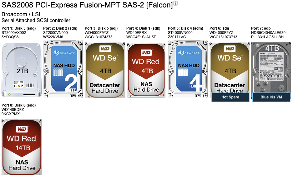

Hi @jbartlett
Suggested Feature:
So one thing I struggle with in my server is keeping track of what the various drives are used for. unRaid itself does not provide a way to annotate drives or add a memo etc. In my case, I have a number of unassigned  SSDs and other drives passed through to various VMs and for other uses.
Diskspeed docker does a great job of visually representing the drives, and the capacity overlay is super useful. For me, a great addition would be the ability to manually add an additional text memo to some / all drives to help me quickly remember what that specific drive is used for (without needing to sift through VM configs etc.)
I've visualised something here to get the idea across;
You can see that I can determine from the titles that most of these are array drives, but those on Ports 6 & 7 are not. In a few months after setting stuff up, I'd love a handy reminder of what those drives are doing in my system. You see here that I mocked-up an additional text overlay where I can set a reminder for these specific disks.
It wouldn't even need to be a separate field. If the existing disk size overlay could be amended to take custom text, that would work too (I'd be happy to manually add the capacity to my custom label)
For me, this would be a great feature. Thanks for considering it.
A second text layer - should be somewhat simple to implement. I'll add it to the 3.0 To Do list. (The 2.9 line is bug fixes only now.)
