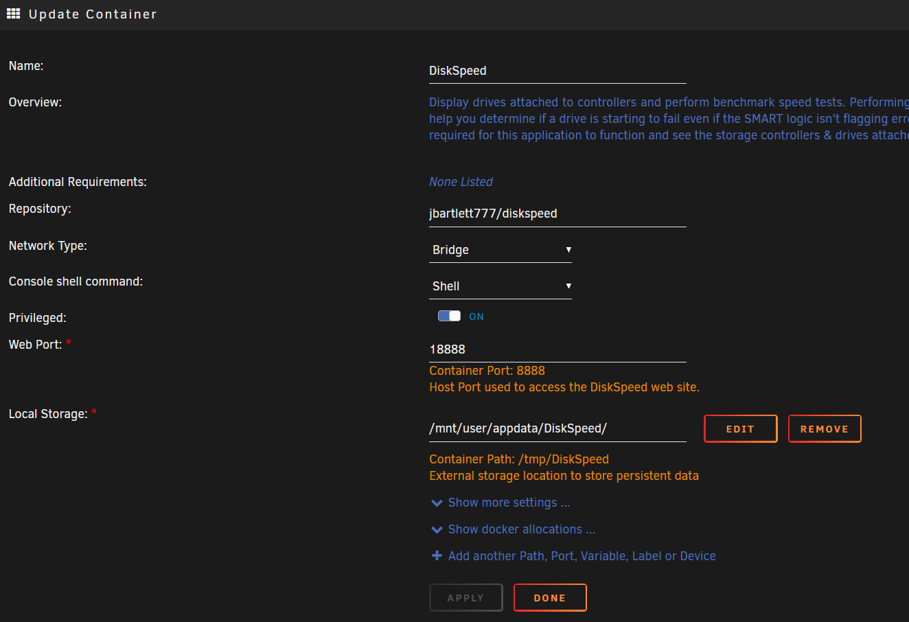

Hello,
i have some problems to get started with diskspeed docker container my setting are:
<?xml version="1.0"?>
<Container version="2">
  <Name>diskspeed</Name>
  <Repository>jbartlett777/diskspeed</Repository>
  <Registry/>
  <Network>bridge</Network>
  <MyIP/>
  <Shell>sh</Shell>
  <Privileged>true</Privileged>
  <Support/>
  <Project/>
  <Overview/>
  <Category/>
  <WebUI/>
  <TemplateURL/>
  <Icon/>
  <ExtraParams/>
  <PostArgs/>
  <CPUset/>
  <DateInstalled>1652055180</DateInstalled>
  <DonateText/>
  <DonateLink/>
  <Description/>
  <Networking>
    <Mode>bridge</Mode>
    <Publish>
      <Port>
        <HostPort>1111</HostPort>
        <ContainerPort>18888</ContainerPort>
        <Protocol>tcp</Protocol>
      </Port>
    </Publish>
  </Networking>
  <Data/>
  <Environment/>
  <Labels/>
  <Config Name="Host Port 1" Target="18888" Default="" Mode="tcp" Description="Container Port: 18888" Type="Port" Display="always" Required="false" Mask="false">1111</Config>
</Container>
Even the docker is started i try to use http://192.168.178.2:1111/ but nothing appears.
I don't get my root cause problem.
Edited by lex87
On 5/9/2022 at 4:26 AM, trurl said:
Post docker run instead of XML
Thanks a lot issue solved
On 5/10/2022 at 6:03 PM, jbartlett said:
The container port must remain 8888.
that helped

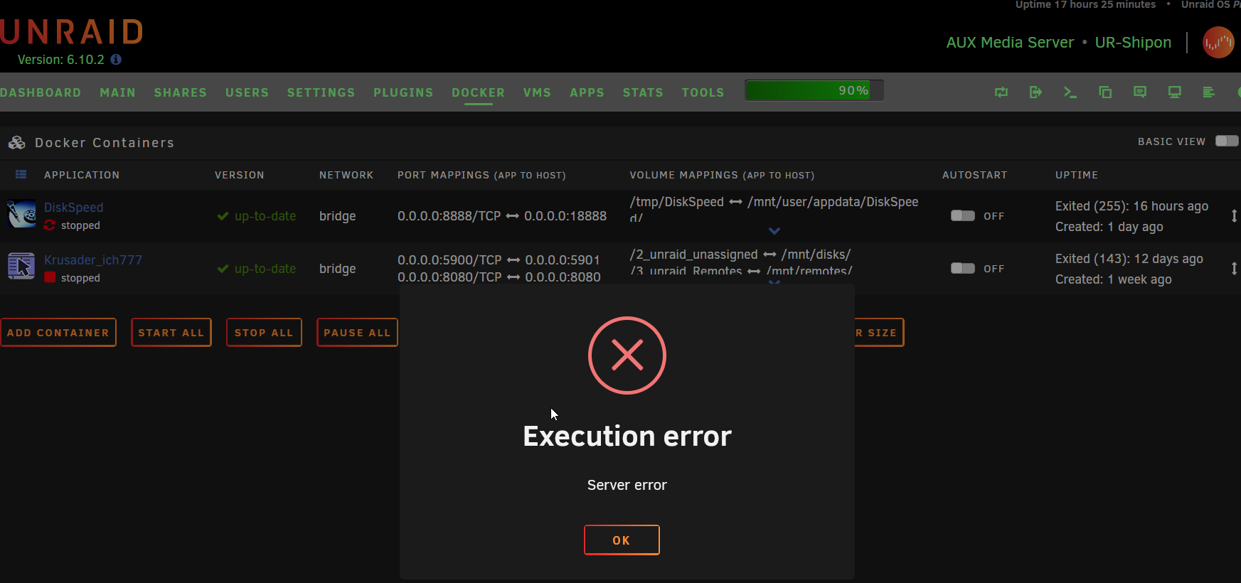

I was checking something recently after upgrading to 6.10.2 and noticed that DiskSpeed created its main folder with a unknown user pid:
:/mnt/user/appdata# ls -ld DiskSpeed/
drwxrwxrwx 1 65534 users 18 Apr 13 10:12 DiskSpeed//
:/mnt/user/appdata/DiskSpeed# ls -alh
total 0
drwxrwxrwx 1  65534 users  18 Apr 13 10:12 ./
drwxrwxrwx 1 nobody users 292 May 21 02:46 ../
drwxrwxrwx 1  65534 users  10 Apr 13 10:12 Instances/
seemed to work just fine however?
total 0
It's the built-in docker user but I have a task that goes out and opens up the permissions on any new files.

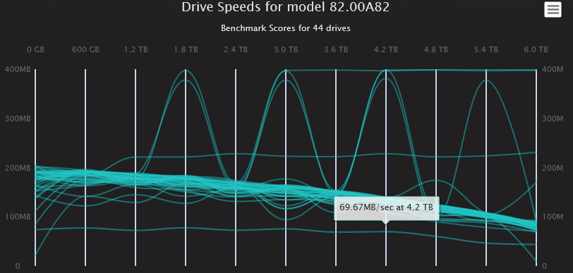

I've benchmarked my HDDs and now I'm puzzled with this result:
I didn't find similar results in this thread. How such high speeds are even possible? What does this 'sine' behavior say? Also, max allowed speed gap doesn't increase after 25+ retries, so I had to just abort this benchmark.
Benchmarks of two other similar HDDs don't report anything unusual. This is SMART of the weird one:
It's possible with WD SMR disks that haven't been fully written, when the disks knows there's no data there it returns zeros from the controller, doesn't read the disk surface, hence the higher speeds, once the disk has been fully written you should see normal results.
I've suspected that this is somehow connected with SMR. The weird HDD is only 44% full, but two other drives are 76% and 65% full respectively, so they produce normal graphs:
So, are you saying that I can expect normal result if I fill my HDD over 50% or more? In this case DiskSpeed will need some tweaking, I suppose, because speed gap doesn't increase on retries and disabling it doesn't work either for some reason. First I thought that my HDD was faulty, but now I'm thinking that WD SMR technologies mess benchmarks up.
Edited by AnimusAstralis
It should return normal results once the disk has being fully written at least once, after that actual used capacity used should not be important.
It's not uncommon it seems based on other submissions. But yeah, I'll need to code in a catch for sine waves 😅
It may be a good idea to get into the habit of putting your new drives through at least one pre-clear pass, one write pass at a minimum, which will prevent this from happening.
Hello.
I am new to diskspeed and by far i do not know everythin what this thing can do.
I installed the Docker 'Diskspeed' on both of my Systems.
On the 1st System it looks good.
Just one small thing:
I do miss an indicator which disk already was benchmarked and has a graph and with does not have a benchmark graph.
With more than 20 Disks it is a hassle to keep track wwhen using this tool the first time.  😁
But that is just a luxus problem.
On the 2nd System (look at my signature) I once started it, and it crashed.
Then I stopped docker and tried to start again and now I always get an Server Error.
I should mention, that 3 unassigned Devices are currently in the process of preclear.
Is the Diskspeed Docker vulnerable when preclear is running on a disk?
Edit: After precler is finished on all 3 Disks: diskspeed docker starts and works without rebooting the unraid System.
It looks like diskspeed does really not like it, when some disks are in use (preclear).
Edited by DataCollector
edit after preclear is done
There's not much I can do if the Docker app won't even start if a Preclear is underway. The Docker is just an application server, my program hasn't even kicked off until you open the GUI. I've no idea what would cause that but you might get a hint if you monitor the syslog while you start it.
As for knowing which drives have been benchmarked, you can benchmark all drives at the same time from the main screen. Click the button "Benchmark Drives". Above it will be a benchmark graph if any have been done yet and you can see by which ones aren't included that still need to be done. You can optionally benchmark just those drives at the same time by unchecking the drives that have already been done on the following screen.
