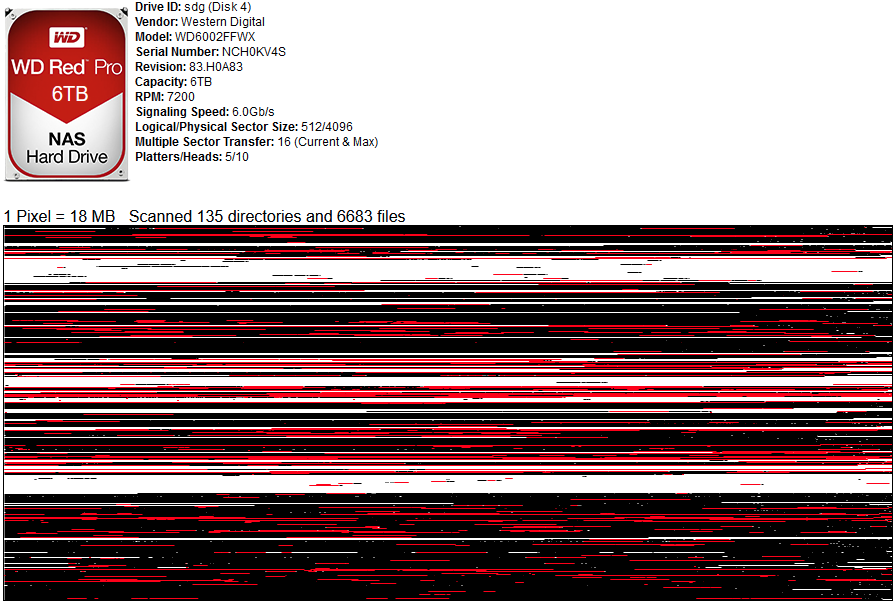

Feature in progress - file fragmentation & allocation map.
One thing I've learned is that for some reason, the underlaying OS likes to split up files all over the drive. This is from a drive on my backup NAS, files are just copied there but I see that large files are broken up all over the drive in most cases.
Black = Allocated, non fragmented
Red = Allocated, fragmented
White = Unallocated
Edited by jbartlett
I just noticed a trend in the file fragmentation. It seems the OS has the tendency to break the file up into chunks of a set size. I found this really strange because, well, why do it at all? Noticing the trend of 32768, I did some research and some file systems (like ex4) have a maximum number of blocks that can fit in one extent and then the OS has to create a new extent to continue, thus creating a forced fragmentation chain by design. But it's interesting that in some extents break this barrier (btrfs in this case), typically on the last two extents but not always.
I had designed my app to display fragments in red but I think I'll just default everything to black with the option of display fragmented files in red after the scan.

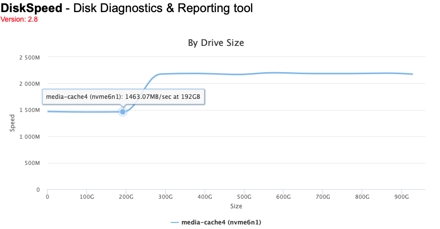

That's a trend across pretty much every SSD and I don't have an answer for you as to why. On the HDDB, I take the peek speed and report that as the transfer speed.
that's the result of trim, when data is deleted from a modern SSD trim is used to tell the controller that those blocks are free and can be erased, the controller does that and marks those blocks / pages as zeroes. when you try to read from these blocks the ssd controller does not actually read the flash it just sends you zeroes as fast as it can. this is the reason ssd's used in the unraid parity array can not be used with trim since that will invalidate the parity.
Just to make sure I understand it right. The flat line that basically indicates the max. interface throughput is trimmed (empty) space on the SSD?
26 minutes ago, Fireball3 said:
Yes, the controller or interface is probably the bottleneck
So the correct logic would be to take the lowest speed as the maximum read speed? There will be interface issues on some systems so an average of the lowest speed of every reported SSD of the same make/model/revision would be better representative of the whole.

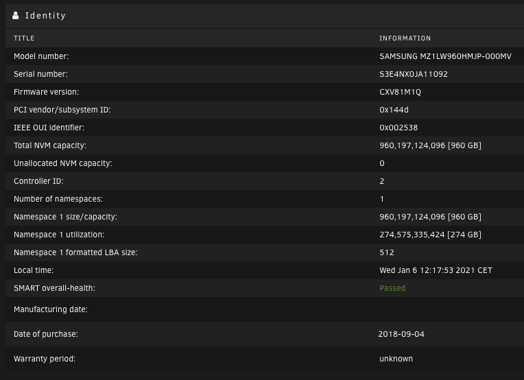

this is the graph from one of my NVMe drives:
and this is the used space (274GB):
to be honest, I don't think it makes real sense to test more than the first 10% of an ssd, this would bypass this issue on all but completely empty ssd's.
