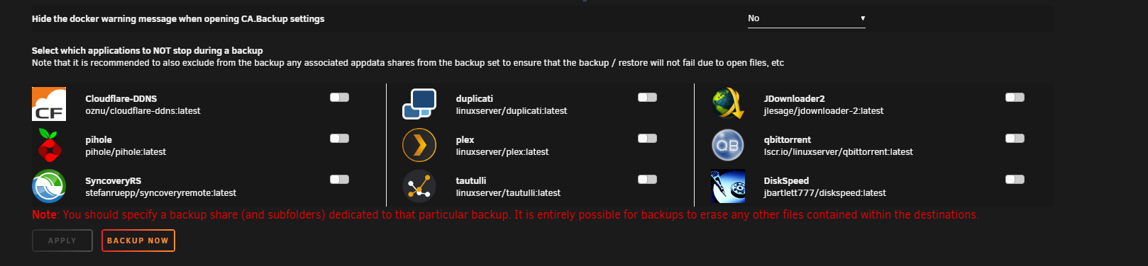

  4. In Appdata Settings I only find under advanced options this field: Is there an other field to change docker stop options?

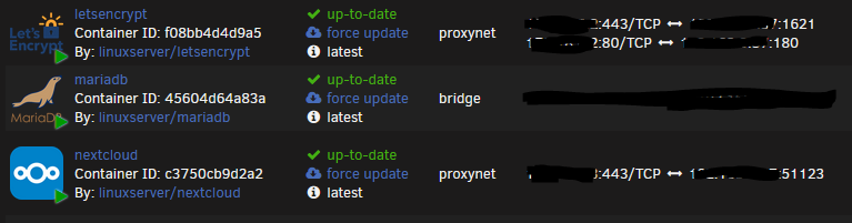

  8. For standard ssl 443 port (which works): port 443 (internet) => 443 to 1621 (router) => ngnix (letsencrypt) "listen 443 ssl" map to nextcloud docker My dream : port 51123 (internet) => 51123 to 1621 (router) => ngnix (letsencrypt) "listen 51123 ssl" map to nextcloud docker. I change opposite the other solution above only the nextcloud.subdomain.conf (letsencrypt docker) row "listen 51123 ssl" But I try some different settings. Now I could narrow the problem a litte bit. Problem is the nextcloud "ngnix" settings not letsencrypt docker. I tested to forward port 51123 directly (without reserve proxy (letsencrypt docker) ) to nextcloud => same error: "403 Forbidden nginx/1.16.0" ... so its an config issue in nextcloud docker but where I should config that, I am a litte bit confused now... Edit: OK my "noob" problem solve partially: setting in nextcloud config.php under "trusted domain": 'trusted_domains' => array ( 0 => 'xx.xx.xx.xx:51123', (internal ip) 1 => 'my.domain.com:51123', (domain) 2 => 'xx.xx.xx.xx:51123', (external ip) BUT works only for internal and external ip not for domain!
  9. Yes I took that into account, my configuration works fine with 443. I had also refer spaceinvaders trutorial :)) I only change port in nextcloud.conf from 443 ssl to 53444 ssl, and router config outside port 443 to 53444, all other config are the same. Router seems not the problem because I get on my web-request to the ngix proxy.
  10. Hello, works great but now i want to configure reserve proxy with a specific ssl port (standard ssl 443 works fine) for nextcloud. I tried to change the port in nextcloud.conf but then i get 403 Forbidden nginx/1.16.0 error, what I do wrong? Thank you very much in advance. Router is configured with this port. Standard ssl (443) works. server { listen 53444 ssl; listen [::]:53444 ssl; server_name cloud.*; include /config/nginx/ssl.conf; client_max_body_size 0; location / { include /config/nginx/proxy.conf; resolver 127.0.0.11 valid=30s; set $upstream_nextcloud nextcloud; proxy_max_temp_file_size 2048m; proxy_pass https://$upstream_nextcloud:443; } }
