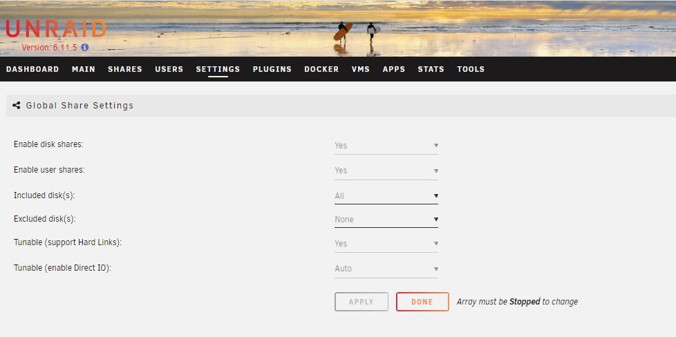

I just finished removing a disk and rebuilding parity after a new config. I find that user shares are visible on SMB (Windows 10) but disk shares are not. They were mounted before I did the new config and they show that they are still enabled in Setting/Global share settings (see below). I have stopped the array, disabled disk shares, then restarted and stopped again and set enable disk shares and restarted. The disk shares are still not visible on \Tower. (see below) Is there something else I need to do the have Unraid mount them on SMB? Thanks.
