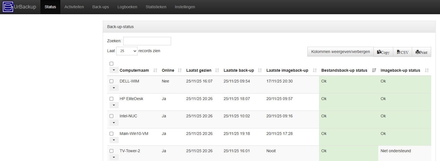

  2. I had tonight a few backups working, didn't find any errors in the urbackup error log. So I think it is solved. Thanks Binhex!
