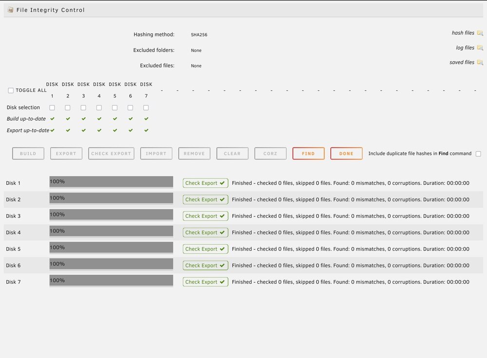

I ran File Integrity today. Long story short, power went down today and I want to see if that caused file corruption. If it got the hashes from when the array was started earlier this morning, then those hashes are useless. Hashes should be from yesterday. It all went well but I want to know what date it got the hashes are from?
Also PS. I'm still confused what's the difference between build and export. Can someone ELI5? Thanks a lot.
As I understand it the hashes are stored in the files metadata within the file system when the hashes are built.    The export copies this information to an external file.
