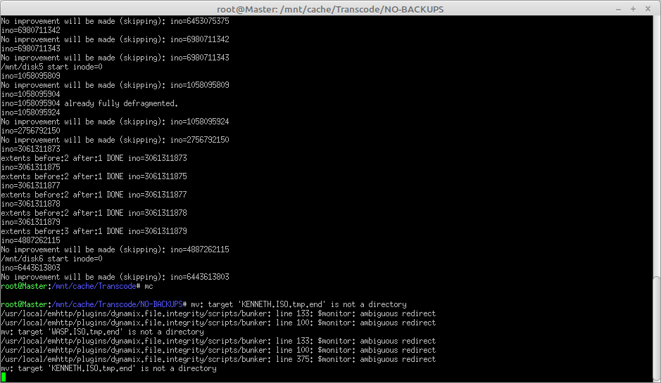

  4. Hi Guys and Gals.. Longtime user but not any kind of programmer, though I normally find solutions (eventually). I find myself in need of some assistance from far more competent minds than mine. Scenario: Xeon 4C/8T 64GB Ram Disks: Parity & Disk1 are WD Ultrastar DC HC330 (CMR 7200) - fast changing data Disk2 to Disk6 contiguous are Seagate ST4000DM004-2CV104 (SMR 5400) - slow changing data Dynamix file integrity installed and set to watch new/modified files. I wish to use xfs_fsr on disks that are monitored by Dynamix file integrity. Testing: Ran xfs_fsr -v /dev/md1 Server went NUTS: htop showed load average ABOVE 16 and 8+ files being accessed by md5sum so I waited until it had all completed and Disk1 had stopped thrashing, then I started digging... Found rc.watcher supports stop and start: so... cd /usr/local/emhttp/plugins/dynamix.file.integrity/scripts ./rc.watcher stop >> /mnt/cache/Transcode/fsr.log xfs_fsr -v /dev/md2 | tee -a /mnt/cache/Transcode/fsr.log ./rc.watcher start >> /mnt/cache/Transcode/fsr.log Seemed to work, no thrashing, no md5sum processes running, EXCEPT after a while in terminal this appeared: ( screenshot titled bunker error.png) Something wrong there, nothing in logs or notifications... Performed a clean restart of server just to make sure it is stable and post this cry for help! What service(s) do I need to stop/pause/suspend/kill before running xfs_fsr? What service(s) do I need to start/unpause/resume afterwards? Thanks for your consideration & help.
