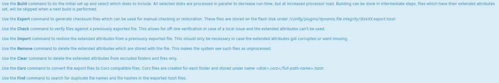

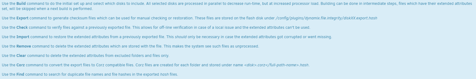

    I think I've got this. There is a built-in help when you click on "Disk verification schedule" label and it says:     But mostly important:

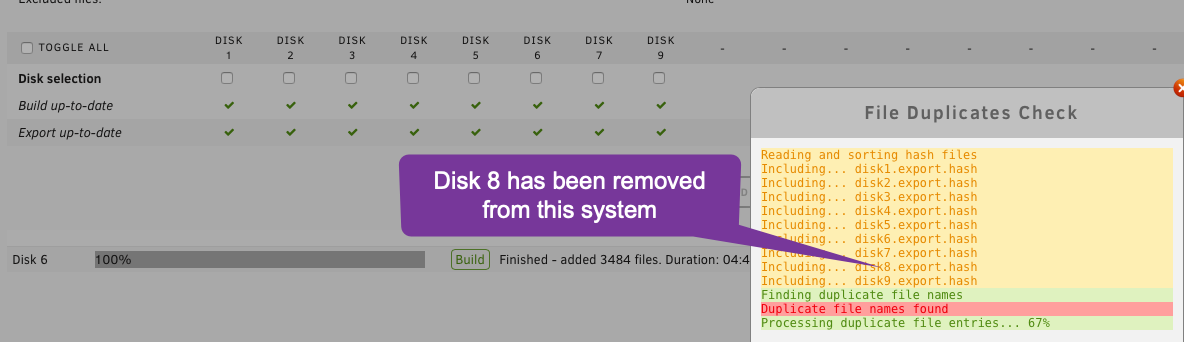

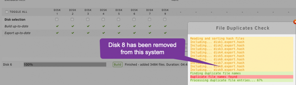

Hi, thanks for the plugin, just a minor bug I noticed when running the Find Duplicates command, it says it's checking Disk 8, I've actually removed that disk from the array as it was faulty. Screenshot:
It sort/check all hash files, it won't check actual disk exist or not. You can simple delete disk8 hash file.

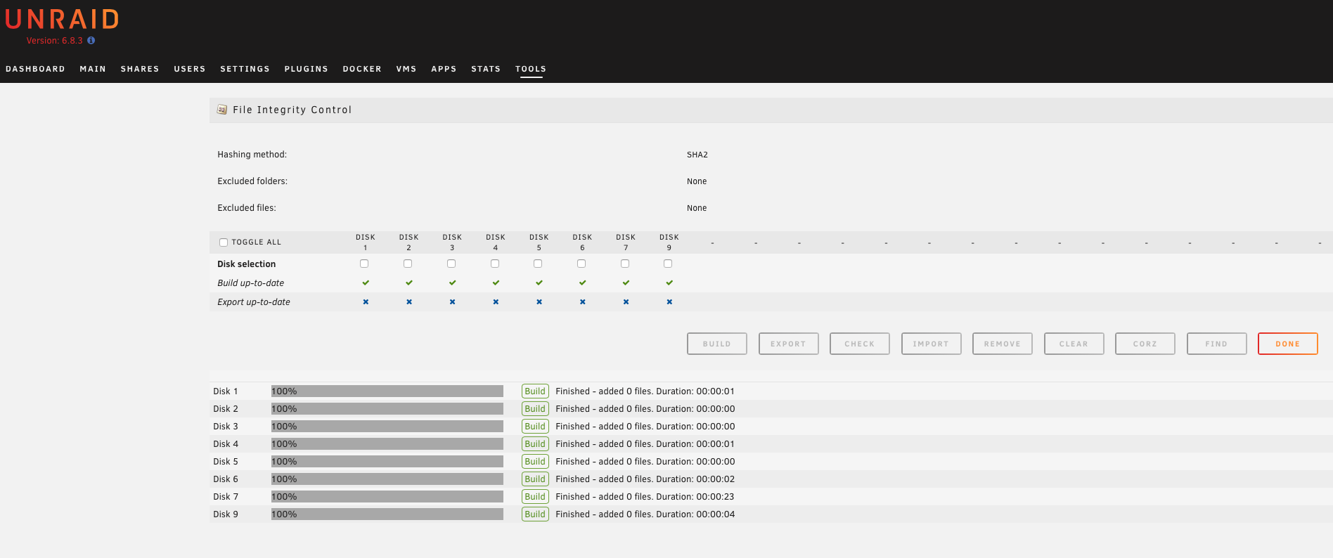

I started using this plugin on a different array the other day and I think I found a bug with the reporting mechanism for the Export being up-to-date with the Build.
When mid-Build, I accidently hit the Export button the the webUI with all the disks selected.  The build continued, but an export was also done on all the devices in my array with the current files where hashes were computed.  I figured, these would almost certainly contain incomplete data, but I'd make a new export when the build completed the next day.  Before I did however, I wanted to see if the Export was incomplete AND the webUI reported that the state was stale.  When checking the export files, I was correct that the data was incomplete and not all the hashes were in the export files.  BUT, the webUI greeted me with all green check marks on the export status for each device.
This left me with a bigger question.  How does the plugin determine if the build and export are up-to-date?

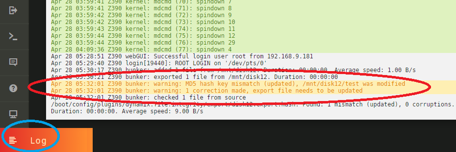

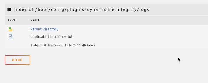

I recently changed Error Logging from Syslog Only to Syslog and Output file.
34806807_ScreenShot2020-12-07at8_42_31AM.thumb.png.6b18413b81091ceb4b96088dd9bfbbf4.png
After a check I see the entries in syslog but can't find the "output file" - any idea where it's stored? (I saw a couple of posters ask but didn't see an answer.)
1098729893_ScreenShot2020-12-07at8_42_04AM.thumb.png.fa86edde23ee95050139acf6b2be48ce.png
