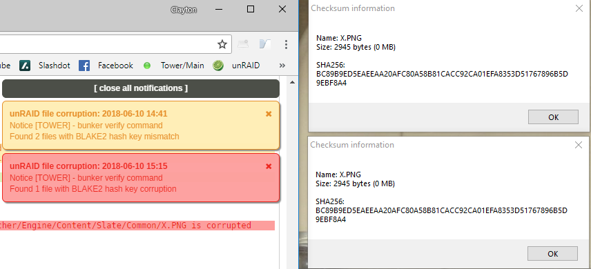

So I've noticed a "BLAKE2 hash key mismatched (updated)" entries in logs on a few files across a several disks.  I've checked the files out and they all seem to play correctly (all movies).  If the file plays with no issues, what does the error mean?

Frankly, I don't think this thing can be trusted to do what it is intended to do.  If it's flagging even one file as being corrupt, as in my case, when other file hashing tools come back and say both copies actually have the same hash then there's a problem somewhere with this tool.  I wouldn't necessarily put too much stock into it saying you've got 295 corrupted files.  If you just replaced the drive and consequently things were just rebuilt from parity I would be more inclined to think your data is just fine.

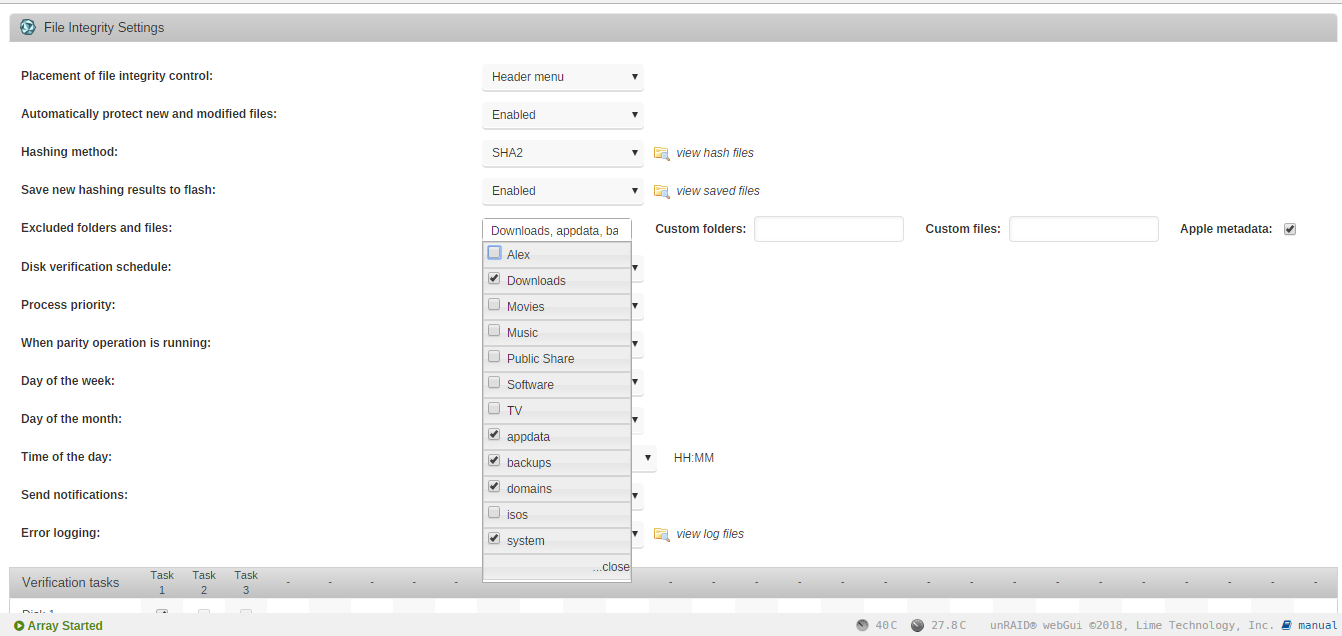

Im sure its super simple however I have excluded all the folders that will cause lots of issues, like incomplete downloads and appdata etc...
As shown, but i'm still getting false errors like so:
SHA256 hash key mismatch (updated), /mnt/disk1/appdata/binhex-minidlna/files.db was modified
and lots of them, how do i ignore the appdata folder?
After you have selected all the excluded folders, run the Clean command to remove existing hash keys, which makes the exclusion active.
