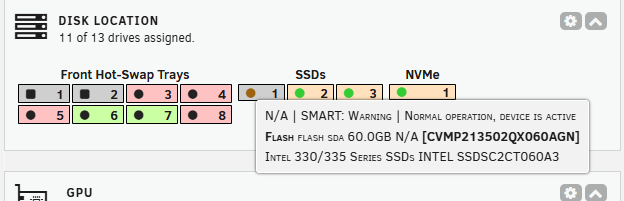

  2. It does indeed list one value there for the drive (Reallocated_Sector_Ct is 1) but as unRAID shows "No Attributes Available" for the flash there is no way to acknowledge the error. This SSD is quite old already and also connected via USB. So I'm not sure if it's because of the age, the connection or UnRAID not knowing how to deal with this situation (the flash having attributes in the first place). Starting S.M.A.R.T tests for the flash also doesn't seem to work. Smartctl is seemingly able to read the values, albeit not absolutely correctly since 109 years of power on time doesn't seem plausible to me.
  3. With all drives working now, the plugin is showing the status on the dashboard as expected. One odd thing (but nothing critical): My flash is showing a S.M.A.R.T warning while the drive itself reports S.M.A.R.T as passed based on an Attribute check. I understand that a SATA SSD attached to a USB<->SATA adapter isn't the usual setup for the flash. Just an odd thing I've noticed. IB-245-C31-20250515-2100.txt
  4. So I think I now know what the issue is. After the update to UnRAID 7.1.x the drive didn't show up anymore at all. So its likely that the drive has failed. I don't know why the SSD didn't show up the the UI of unRAID as failed though. After the update and subsequent reboot the device doesn't show up in the list and unRAID UI anymore. This also means that the plugin is not showing the error anymore and lists the configured slot as unpopulated. I have a replacement drive ordered and will report back if it shows up correctly in the plugin now too.

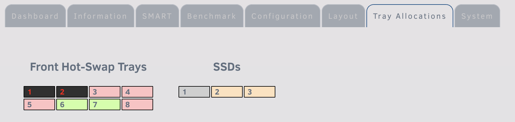

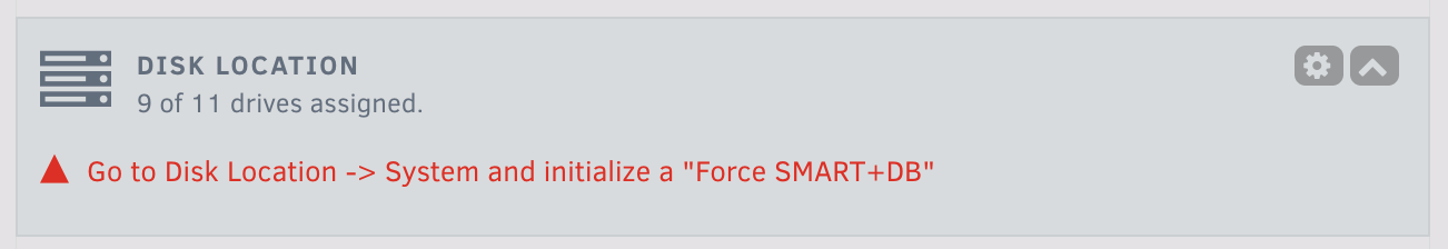

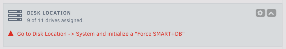

  8. I've just installed this plugin and it looks promising (apart from the default colors being nearly unreadable with the "Azure" theme, but that was quickly fixed by changing the colors to lighter ones) The main issue I'm facing right now is that, after following the instructions on the dashboard and subsequently setting up the layout and assigning the disks, the dashboard just shows a Go to System and initialize a "Force SMART+DB" warning. Executing this options has no effect on the warning though. Let me know if there is anything I can provide or if this is an easy fix. The plugin also doesn't detect one of my NVMe drives. 11 drives total is correct, but under allocations there is only 10 options to select. /dev/nvme0n1p1 is detected as nvme0n1 but /dev/nvme1n1p1 isn't. regards
