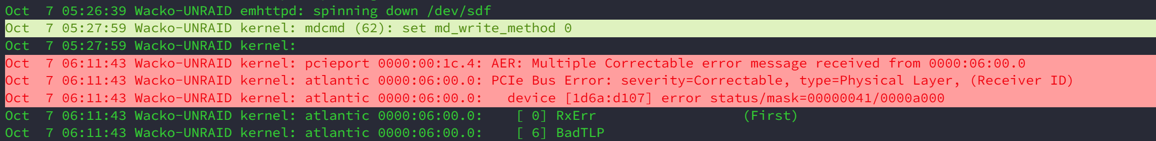

  6. WOW, thankyou kindly for your expert advise and detailed explanation. I Have an onboard 10gbe NIC (AQtion AQC107) that gives an error a few times a day which is related to ASPM. It doesn't cause any problems so its not a major issue, just annoying. Feb 4 06:11:43 Wacko-UNRAID kernel: pcieport 0000:00:1c.4: AER: Multiple Correctable error message received from 0000:06:00.0 Feb 4 06:11:43 Wacko-UNRAID kernel: atlantic 0000:06:00.0: PCIe Bus Error: severity=Correctable, type=Physical Layer, (Receiver ID) Feb 4 06:11:43 Wacko-UNRAID kernel: atlantic 0000:06:00.0: device [1d6a:d107] error status/mask=00000041/0000a000 Feb 4 06:11:43 Wacko-UNRAID kernel: atlantic 0000:06:00.0: [ 0] RxErr (First) Feb 4 06:11:43 Wacko-UNRAID kernel: atlantic 0000:06:00.0: [ 6] BadTLP To help clear the logs for easy "error" finding, I was going to add "pcie_aspm=off" But given your above reply, I feel its not worth implementing in my case as I don't really have a major issue apart from a few random error logs.

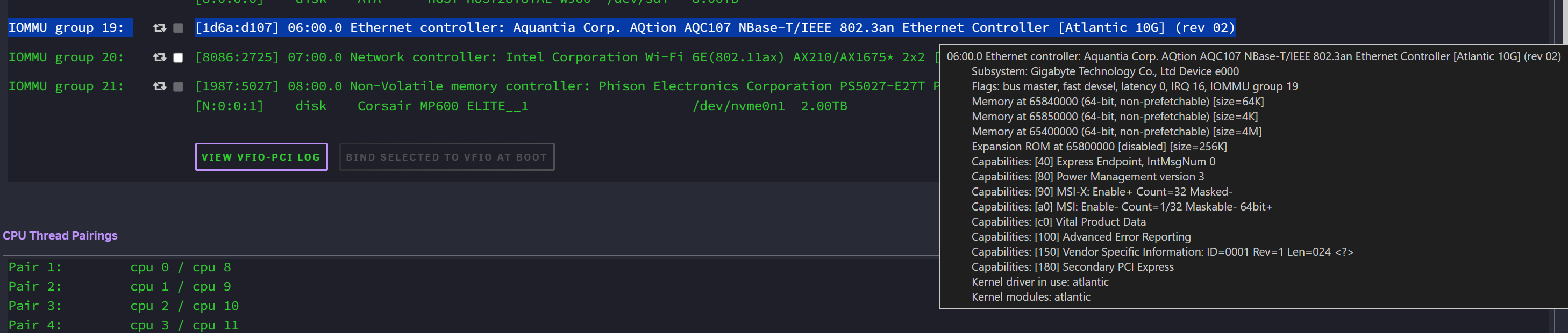

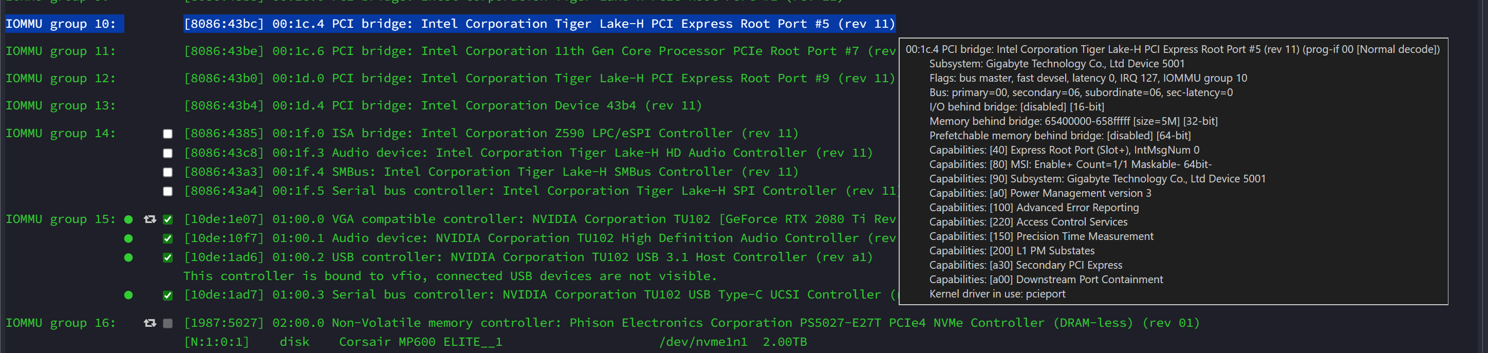

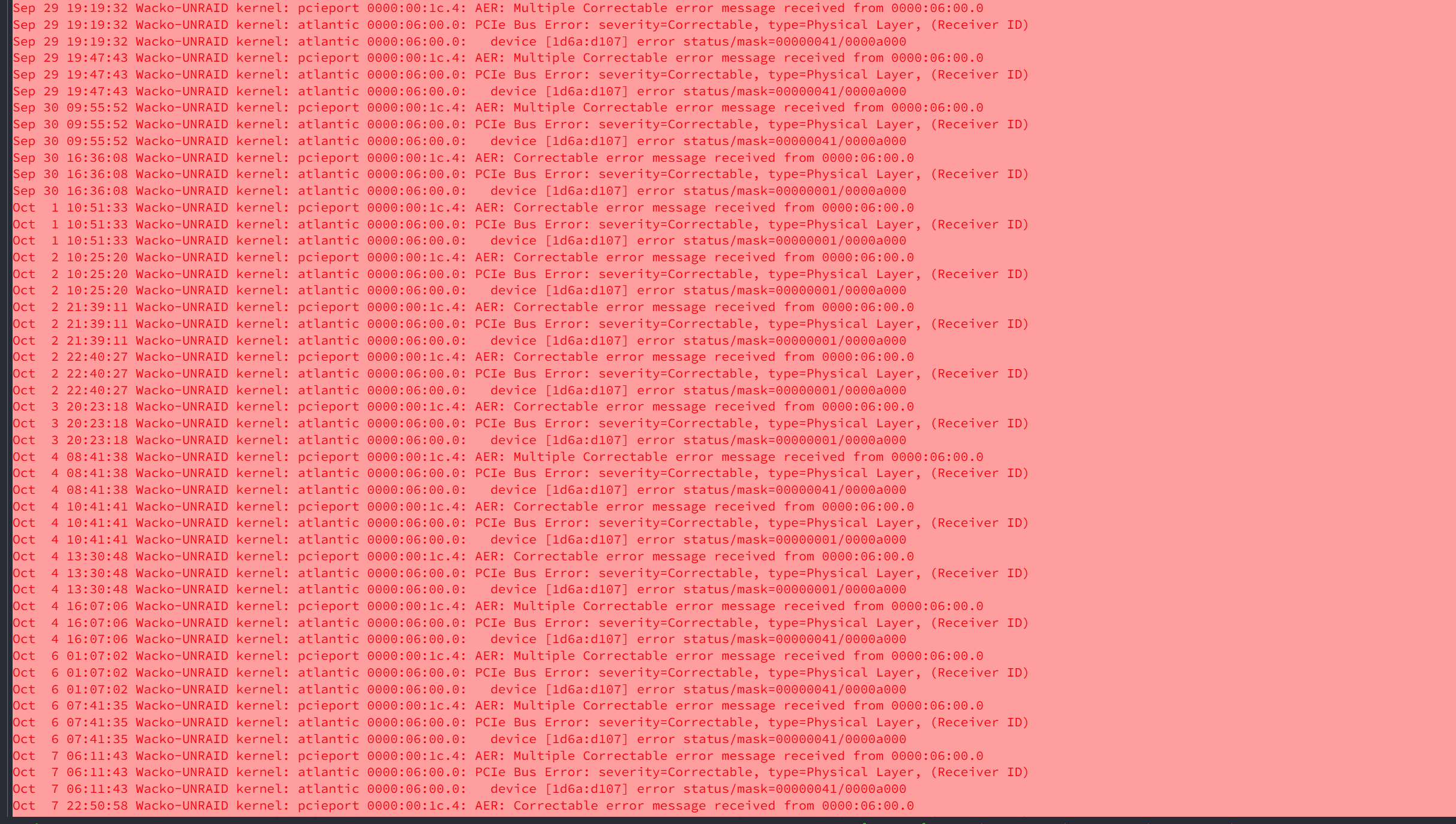

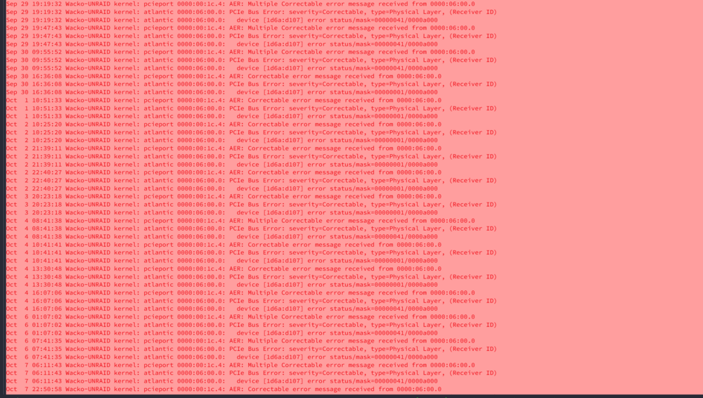

  10. Recently updated my UNRAID Server MB to a Gigabyte Aorus Master Z590 so I could utilise the onboard 10Gbe NIC. This has been working flawlessly and without any obvious issues. Sadly though, I now get random errors in my syslog, sometimes multiple in a 24hr period and others a day or 2 apart. Oct 7 06:11:43 Wacko-UNRAID kernel: pcieport 0000:00:1c.4: AER: Multiple Correctable error message received from 0000:06:00.0 Oct 7 06:11:43 Wacko-UNRAID kernel: atlantic 0000:06:00.0: PCIe Bus Error: severity=Correctable, type=Physical Layer, (Receiver ID) Oct 7 06:11:43 Wacko-UNRAID kernel: atlantic 0000:06:00.0: device [1d6a:d107] error status/mask=00000041/0000a000 Oct 7 06:11:43 Wacko-UNRAID kernel: atlantic 0000:06:00.0: [ 0] RxErr (First) Oct 7 06:11:43 Wacko-UNRAID kernel: atlantic 0000:06:00.0: [ 6] BadTLP From what I have researched and my limited understanding this seems to relate to the ASPM of the device (Power Management) I have tried to enable the ASPM features in the BIOS: PEG ASPM, PCH ASPM and also enabled Native ASPM which allows for OS implementation of ASPM. I did not enable DMI ASPM as I heard this caused issue. Enabling these settings had zero effect on the error. I have searched through the forums and have found suggestions to add “ pcie_aspm=off” to the sys config found here https://forums.unraid.net/topic/118286-nvme-drives-throwing-errors-filling-logs-instantly-how-to-resolve/#findComment-1165004 But I am somewhat reluctant to do so as I don’t understand the full implications of doing so. I have attached screenshots to help identify the system device and of the log error found in Syslog. As always any advise or knowledge on how to proceed etc would be greatly appreciated.
