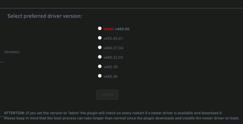

@ich777 a small thing but its bugging me :-), any chance you can get the ui for the plugin to reflect the version you have chosen in the ui?, it currently does not do this, screenshot (note none of the radio buttons show selected version of the driver):-
reproduce:- click on specific version, click on 'update' wait for the plugin to show error notification (should be warning?) and then click back on the plugin and note the radio selection does not shown the 'preferred driver version' you selected.
Already thought of that... :D
But then I thought it would be enough if you see it on the left side of the Plugin but that shows only the current version...
Would it be better to select the radio button what is actually installed or a little textbox with what version is currently selected?
I'm open to suggestions on that...
It would also be a idea to display a textbox or something similar if you choose another version than the current version that says something like: "Nvidia Driver vWHATEVER will be installed on the next boot"
Error? This should be a "red" notification but not an Error, I made it red so that the user actually can't miss it what to do next... :D
i think there are two bits of information that the plugin should show, the currently installed version, and the version you have selected for 'preferred version'.
it does kinda show the current version via the 'Nvidia Driver Version:' field, but its not explicit, perhaps that should be changed to 'Currently installed Version:', and then the 'Select preferred driver version:' radio button should reflect the version you have selected, obviously defaulting to 'latest' when the plugin is first installed.
sorry it looked like an error notification, similar to when a disk has errors, maybe you could have a softer option and use the 'reboot' banner that you get when you upgrade the os and 'require a reboot', you know the one?, the yellow banner at the very top of the ui.

Hi @ich777 just confirming but the proper process with your plugin is to select the latest option?
Yes and no, if the plugin doesn't finds the version that you manually selected then it falls automatically back to latest, so there is no reason to worry about the version. ;)
