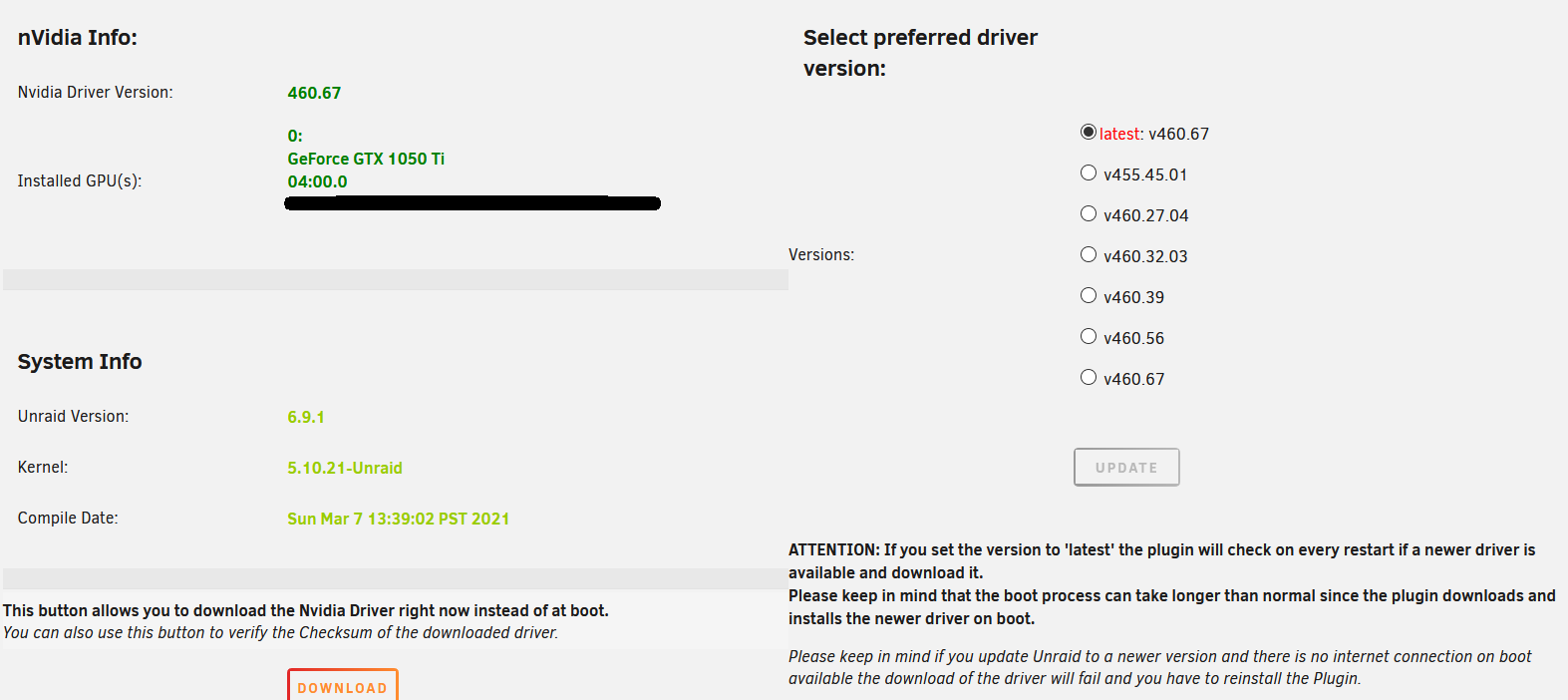

Morning @ich777, happy friday :-). Another minor ui change i would like you to consider for this plugin:-
Issue:-
Red notification shown even though no reboot is required.
Steps to replicate issue:-
1. switch the 'Select Preferred Driver' radio button from 'latest' to the 'Nvidia Driver Version' you are running (as shown on the left), click apply, note that you get the red notification popup suggesting a reboot is required, even though there are no changes to be made.
Expected behaviour:-
no red notification message is shown, as 'nvidia driver version' matches 'Selected preferred driver'.
Suggested fix:-
Compare loaded version with selected version, if they are equal then do not show the notification on apply.
Please update the Plugin to version 2021.03.19 and this should be fixed (found some spare time laying around... :D ).
No extra message was added because it should be obvious that the selected driver matches the current installed (and also not to upset users with messages), the restart message is only displayed if the driver doesn't match the current installed driver, hope that's also fine for you.
nice!, works for me.

You always have the option to choose a driver and set it not to latest to prevent updates on boot.
EDIT2: I get around 9MB/s downloading the file.
Thanks for the reply, as usual 😉
Strange that I got such a slow DL speed from France (ISP Free). As I've said, I didn't have this issue when downloading v460.56 a few days ago.
I understand your advice to avoid this possible problem during the reboot would be, when a new Nvidia linux driver is published, to :
download the latest driver package from the plugin page
- set the driver version to this downloaded version rather than "latest" in the plugin page
- reboot (without downloading, as the latest driver is already there)
If that's correct, I'm fine with such a method, it gives more control on the driver version. Anyway Nvidia doesn't publish drivers every other day, and I'm not always willing to install them on day one !
Thanks again.
Exactly set the driver to your current version instead to latest and if a new driver is released go to the plugin page and set the driver to the newer driver version and click the download button, this will open up nearly the same window as on the plugin installation amd download the driver (you can also click the Download button to verify the MD5 sum but that's also done after the download finished) after that you can reboot and the newer driver will be installed.
Have some times problems with a few ISP's here in Europe with downloads from AWS and Github, since my Docker containers also download the files from Github that has something to do with the traffic volume that the ISP bought from oversea I think (at least I read about that somewhere, I'm not too familar how this works exactly).
