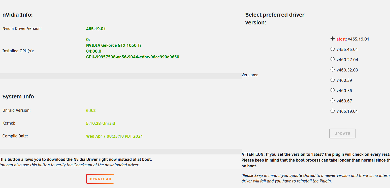

Evening @ich777 a quick heads up, i just upgraded to 6.9.2 (stable) and it looks like its causing some ui issues and problems with the preferred driver selection for your plugin, namely the versions available are not shown correctly and the preferred version i had selected was not honoured on reboot, thus a long reboot time and forced up to the latest version now available (465.19.01).
screenshot below:-
note the preferred version top right.
cheers!.
It will be because new kernel vers havent been created for new release yet in his repo.
Edited by SimonF
  • Replies 5.9k
  • Views 1.1m
  • To utilize your Nvidia graphics card in your Docker container(s) the basic steps are:   Add '--runtime=nvidia' in your Docker template in 'Extra Parameters' (you have to enable 'Advanced
  • Recompiled the drivers and they are now just working fine (to get it working scroll down):   Please do the following (this is only necessary if you upgraded before I recompiled the dri
  • I'm currently spinning up my build VM and compiling the drivers again, currently drivers for 6.11.0 stable are not available...

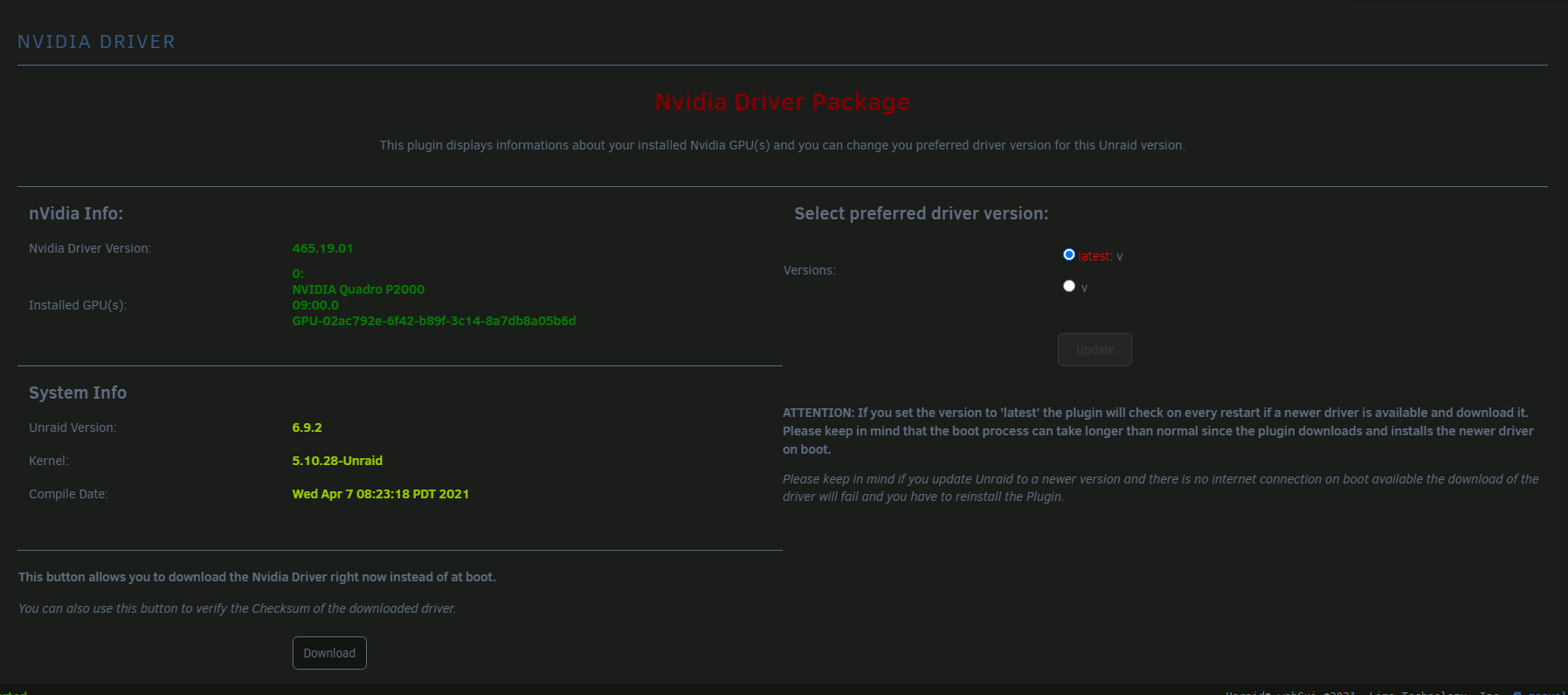

6 hours ago, binhex said:
ui issues
This is just pretty normal, like @SimonF said, since I have to rebuild the packages.
The reason why it's displaying it like that is because I also have built in a fallback so that the latest driver is always downloaded from the LT servers (LT builds only the latest version) so the driver installation won't fail on boot and cause the Plugin to error out if my packages aren't built yet.
When the drivers are available in my repo then the drivers are display on the WebUI or better speaking if you wait for at least 6 or 8 hours (I try to minimize the time but something haven't prevented the automatic upload to my repo after building the packages) after a new release of Unraid the other versions of the driver should be be built already and your preferred version is installed on boot, hope this makes sense to you.
The UI relies completely on my repository otherwise this would be a complete mess... :D
The update process and build process will change with the next releases of Unraid and everything should be already available when you upgrade. :)
Try to go to the UI once more and you should see that now all versions are available.

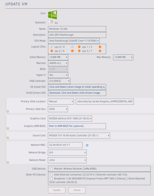

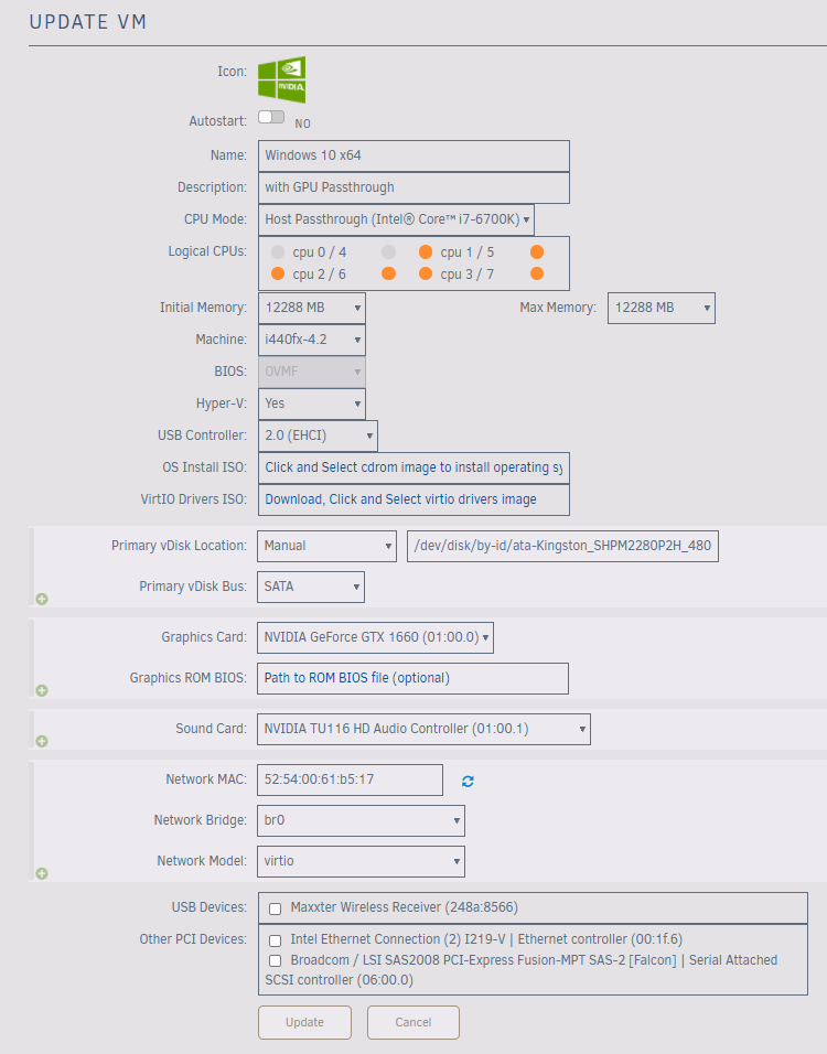

Ok now i've got an other error. After using the gpu in the emby docker i delete the entries in the the emby docker container to use the gpu with a win10 vm.
The problem now is that cant start the vm when selecting the gpu... tried a restart but it didnt help...
The IMMOU Group of my GTX1660 is: 01:00.0 and from gpu sound card 01:00:1
Error code:
Execution error
internal error: qemu unexpectedly closed the monitor: 2021-04-14T12:16:32.430601Z qemu-system-x86_64: -device vfio-pci,host=0000:01:00.0,id=hostdev0,bus=pci.0,addr=0x5: vfio 0000:01:00.0: group 1 is not viable Please ensure all devices within the iommu_group are bound to their vfio bus driver.
Can you help me?
Edited by WowaDriver

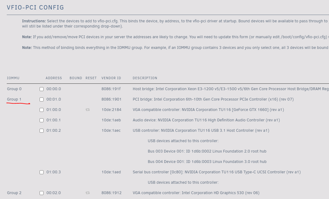

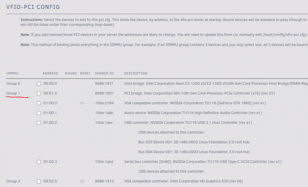

1 hour ago, WowaDriver said:
Execution error
Is the card stubbed or better speaking is the card bound to VFIO?
Can you post your Diagnostics here (Tools -> Diagnostics -> Download -> drop the downloaded zip file here in the text box).
I dont know why but when i press the download button to get the diagnostics i only get this screen and nothing other happens...
It do not download the files... cant say what is the reason for...
But i can give you a screen of my VIFO-PCI-CONFIG:
So the answer is no, i only select the gpu in the win10 vm and made the entries like on the first post of this thread for the emby docker.
