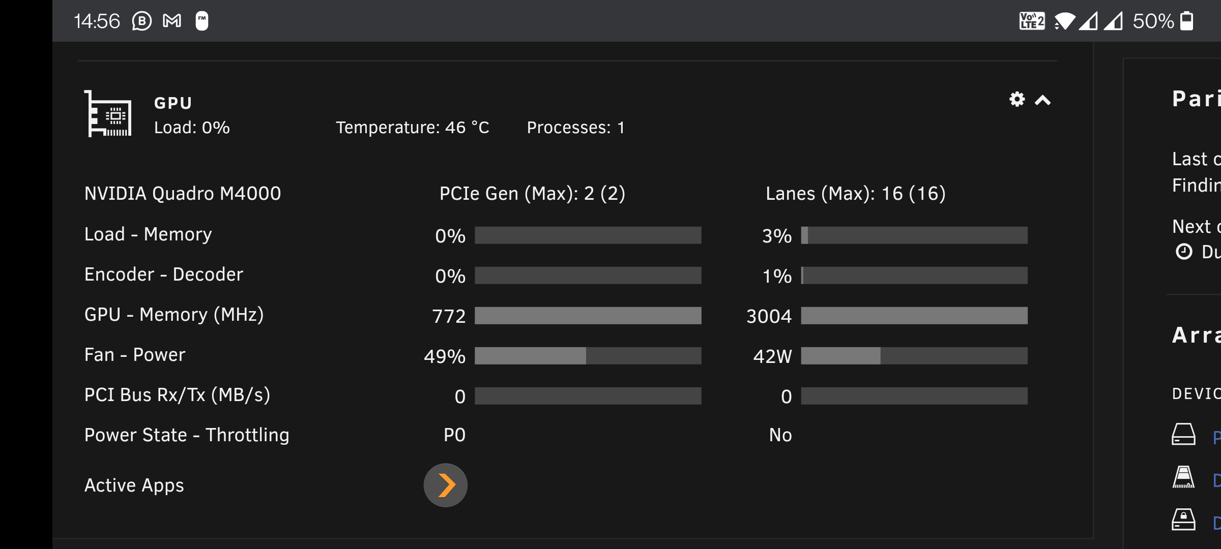

Does anyone have issues with the GPU memory? My M4000 floods and won't empty. Transcoding movies freeze for a couple of seconds and then resume. Re-freeze within 20 seconds and repeat.
Just stopped my movie and it took about a minute before the GPU started to flush the memory.
In my opinion this shouldn't happen when there's only one stream playing. Especially when you realize the M4K can handle at least 20 streams
This has nothing to do with the Driver itself.
This is more a Plex "thing" since it also shows that Plex is using the GPU (I think the picture is after you stopped the playback) and what I can think of is that Plex uses the card a little longer after you stopped the playback.
From my experience the memory usage is pretty normal if you transcode a 1080p file.
Done some testing, and indeed seems to be some kind of plex issue. Direct play freezes even more 🤔
Thanks for your quick response. I'll take this issue to linuxserver
This is more a direct Plex issue and linuxserver can do nothing about it I think.
