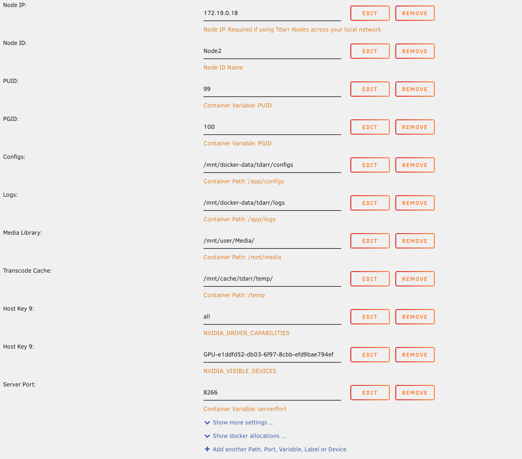

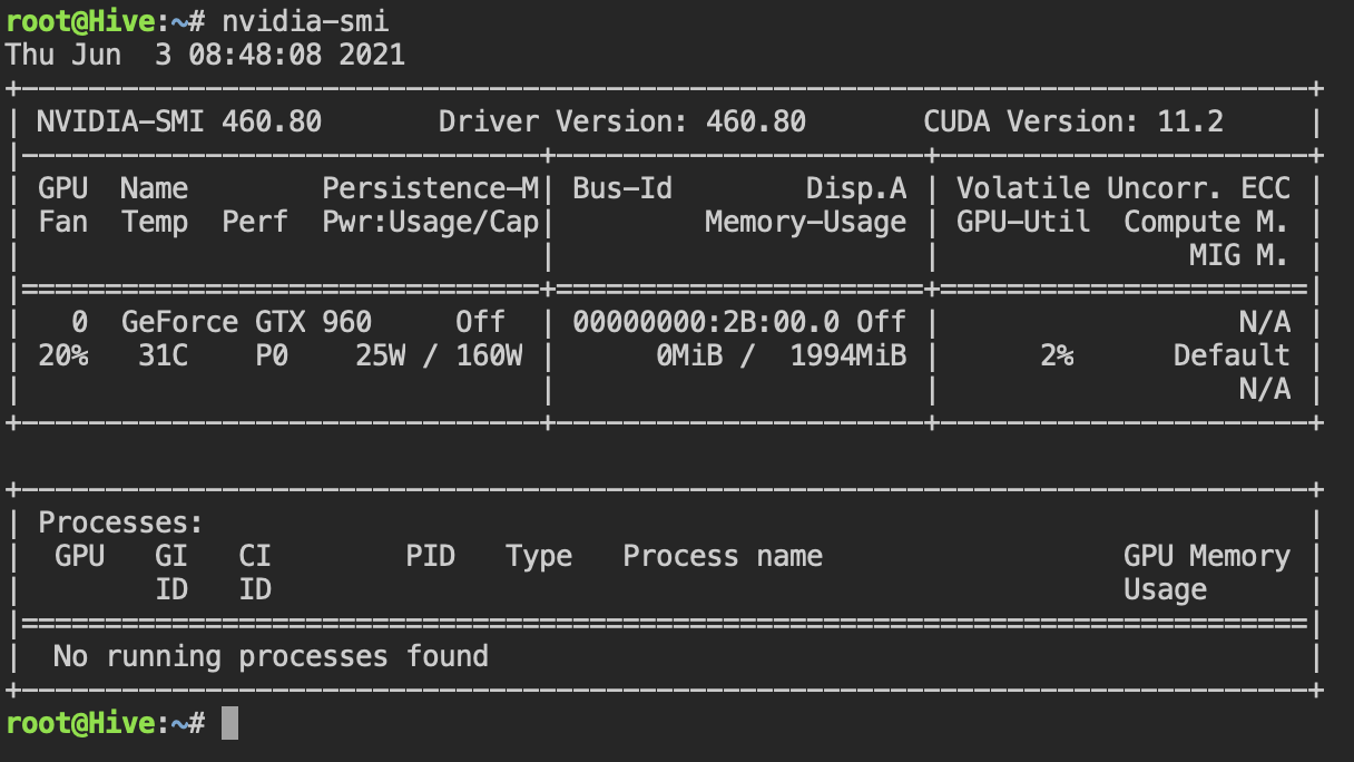

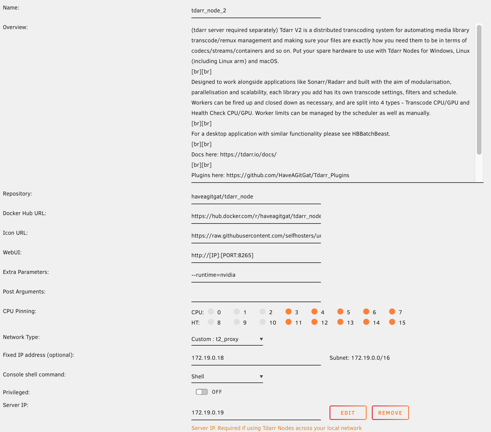

8 hours ago, ich777 said:
Please open up a console and can you give me the output from 'nvidia-smi'?
Can you also send me a secreenshot from the container template itself (with Advanced View turned on)?
Everything seems to look correct from configuration, unless I am missing something.
Extra Parameters = --runtime=nvidia
Variable NVIDIA_VISIBLE_DEVICES = GPU UUID
Variable NVIDIA_DRIVER_CAPABILITIES = all
Also note that Tdar is currently transcoding with the GPU selected and there is no GPU activity using nvidia-smi.
What kind of files are you transcoding? Are you sure that the 960 is capable of transcoding the file.
Keep in mind that the "older" Nvidia cards have problrms with some HEVC formats...
If it's a HEVC file then try a h264 file instead if that also doesn't work.
I figured it out, it was a config in one of the plugins that I needed to tell it to use the GPU. Working pretty well now.

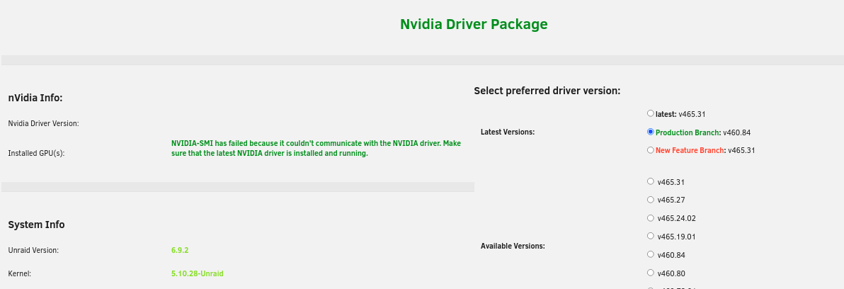

I had issues a few pages ago, now I have again.
I rebooted the server, and when I started everything again, Plex wouldn't start and gave me then "bad parameter" error.
I checked it was typed in correctly, and it was.
I went to the "Nvidia Driver" page, and saw it didn't pick up the GPU. I tried verifying the checksum, and it came up with the error and downloaded it again. I did a hard refresh and checked it again, just to be sure.  It didn't pick up the GPU, so I rebooted it, again, just to be sure.
And it still doens't pick it up, and if I verify the checksum, it needs to download it again.
What am I doing wrong?
Yes, I remember that.
Can you try to issue the command 'nvidia-smi' and see what the output is? Or do you get again nothing?
Please remember there was a driver update again a few days ago and eventually that file wasn't downloaded properly...
If this happens the next time please post your Diagnostics here and the output from nvidia-smi.
Nothing.
"bash: nvidia-smi: command not found"
It gave me a notification about the driver, I updated it, it didn't show anything, So I rebooted again, and it gave me the same answer again.
nvidia-smi:
Diagnostics:
nanostorage-diagnostics-20210607-1342.zip
Edited by Nanobug

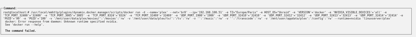

It's there now:
Plex is not happy:
I tried with the GPUID as well, same result.
I've already contacted LSIO about it, but if you have the solution, I'd be happy too :)
Have you restarted the Docker service too?
