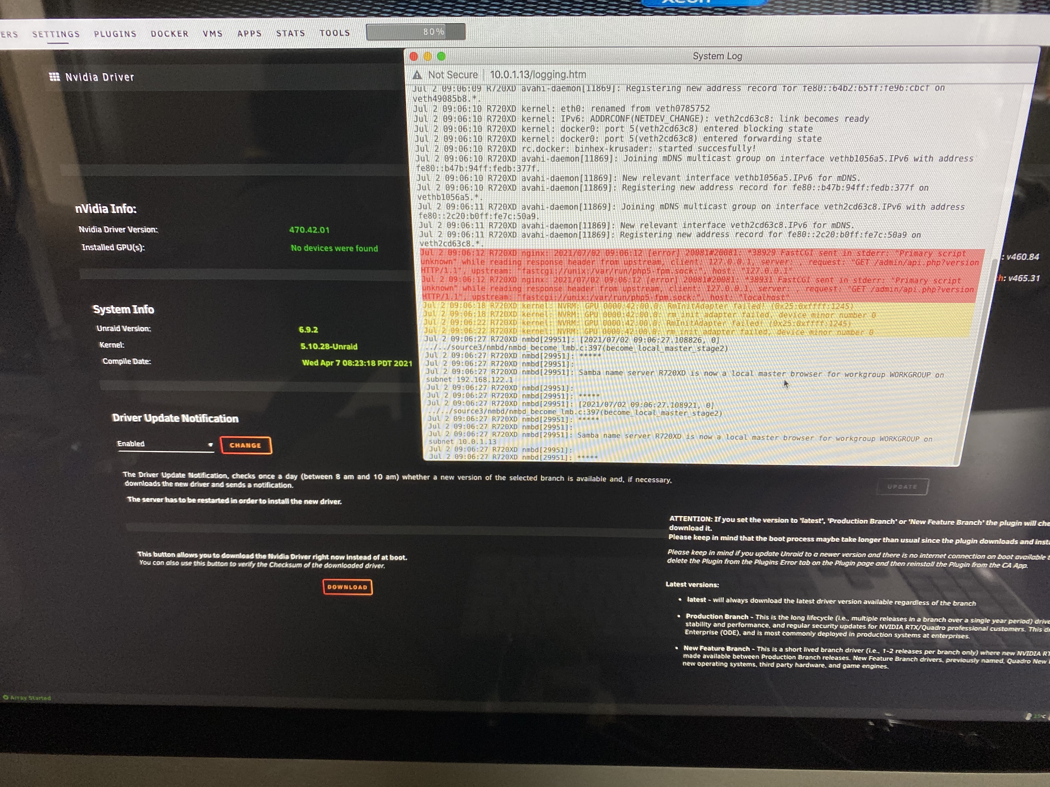

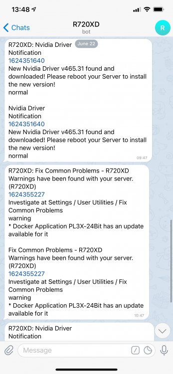

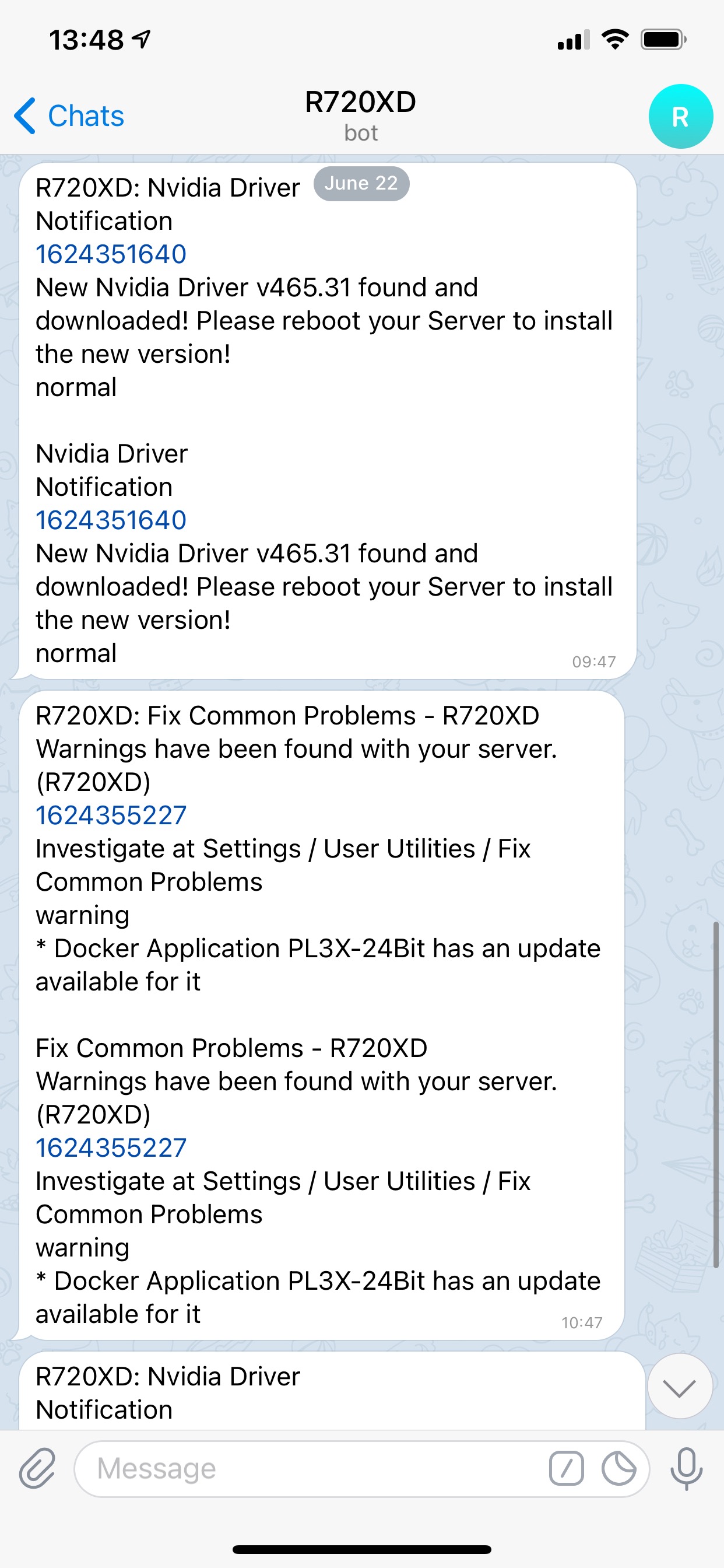

Sorry the Nvidia Driver updated 22nd June according to telegram, Yes the GUI does lockup so i had to MC in and remove the Nvidia plugin and now it does not lock up and no Error in the logs. When i re install the plugin i get this - R720XD kernel: NVRM: GPU 0000:42:00.0: RmInitAdapter failed! and the GUI locks up. Card Works iv tested it in my mining machine.  yes i tried latest and the option below that.
  • Replies 5.9k
  • Views 1.1m
  • To utilize your Nvidia graphics card in your Docker container(s) the basic steps are:   Add '--runtime=nvidia' in your Docker template in 'Extra Parameters' (you have to enable 'Advanced
  • Recompiled the drivers and they are now just working fine (to get it working scroll down):   Please do the following (this is only necessary if you upgraded before I recompiled the dri
  • I'm currently spinning up my build VM and compiling the drivers again, currently drivers for 6.11.0 stable are not available...

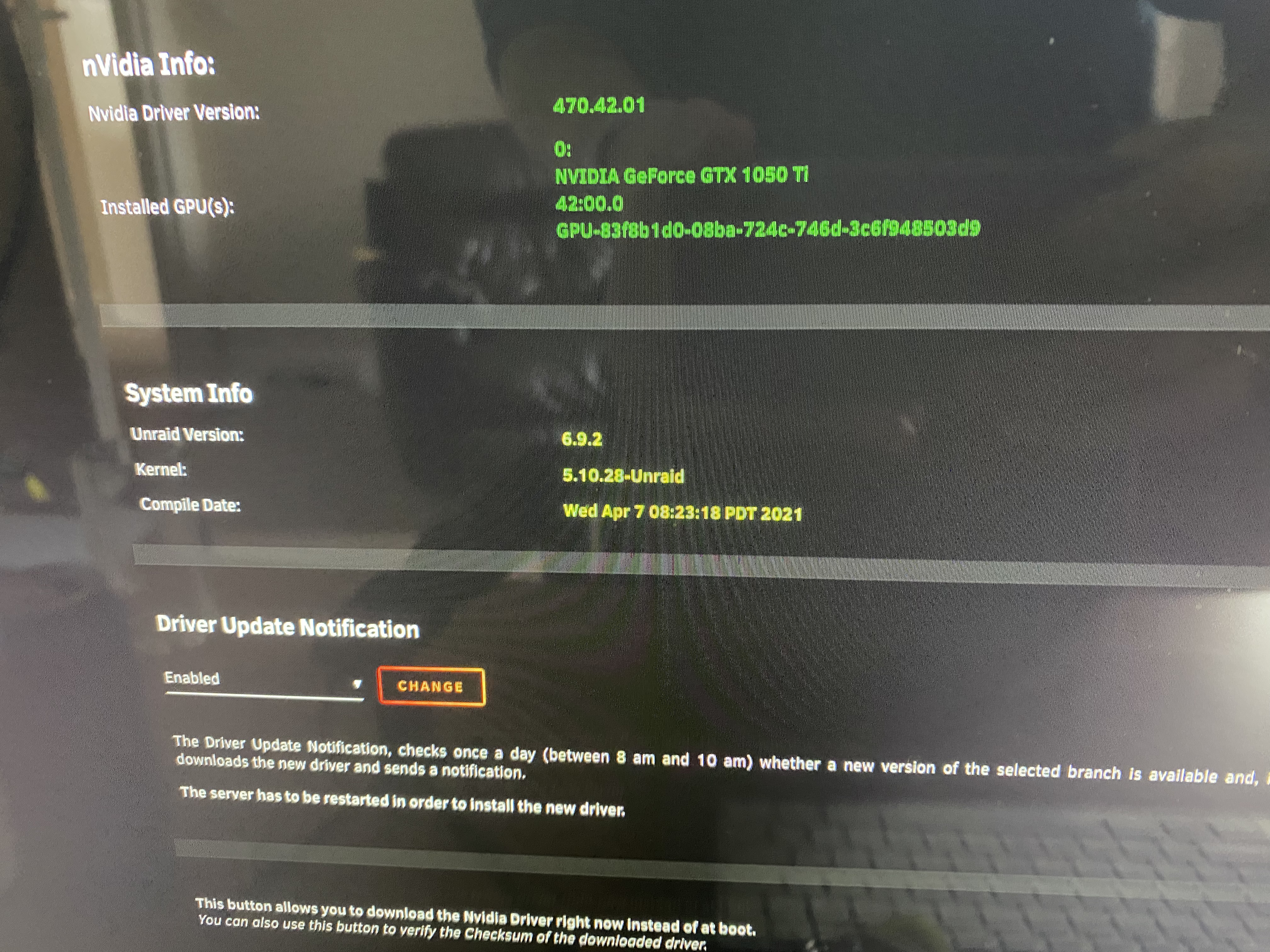

When you are saying GUI you mean the WebGUI from Unraid and not the plugin page?
Are you on the Dashboard when the GUI locks up or does it lock up in general? Can you close the window and reopen the GUI again?
Have you installed any custom build of Unraid or is this a stock 6.9.2 build?
Please open up a Terminal from Unraid and type in: 'nvidia-smi' (without quotes) and post the output here.
I really can't help this is usually a sign the the Card can't initialize because of too less power or some other hardware related issue (sometimes it can also happen when you are booting with UEFI).
Did you mine with it or did you tested it with a 3D load and connected it to a Display?
And rebooted in between?
The problem with this error is that it is not easy to identify. I think you are booting with Legacy (CSM)?
Please double check if you are booting with Legacy mode.
I really can't help this is usually a sign the the Card can't initialize because of too less power or some other hardware related issue (sometimes it can happen also when you are booting with UEFI).
i put it in the machine and installed windows 10 on it and installed the drivers and the card showed up all ok and worked on external display, GUI if i click say Plugin's or Stats tabs i get the 3 wavy orange lines and it does nothing, totally standard unraid i don't play about with it, nvidia-smi: command not found, Honestly it has been working perfectly fine till that nvidia driver update Emby has worked and the card has transcoded everything correctly. On the 22nd about 10am UK time i went onto unraid and the GUI was weird and laggy and like locked up so i rebooted and was the same. So i removed the nvidia plugin and rebooted and its ok. Re install it i get that error. I cant get another card atm as non in stock and well overpriced as they all being brought to mine. This has been happily working Fine for well over 12 months till that update on 22nd
There seems to be something wrong when the plugin is installed and you get this output.
Downgrade to the driver that was installed previously. Eventually this will solve your issues.
This was after the driver upgrade and the reboot I think.
You get the error that the GUI locks up and that Unraid is laggy?
Have you double checked that you boot in legacy mode?
You can also try a BIOS reset, but only if you know what you are doing.
Do you have a second machine where you can test the card with Unraid, I would do it as follows:
  1. Create a new USB Boot stick on a spare USB Key
  2. Put the card in the other machine
  3. Boot the other machine with your card installed from the USB Key
  4. Register for Trail on the WebGUI
  5. Install the CA App
  6. Install the Nvidia Driver plugin from the CA App
  7. See if the WebGUI becomes laggy on this machine too, if not open up a terminal and issue the command: 'nvidia-smi'

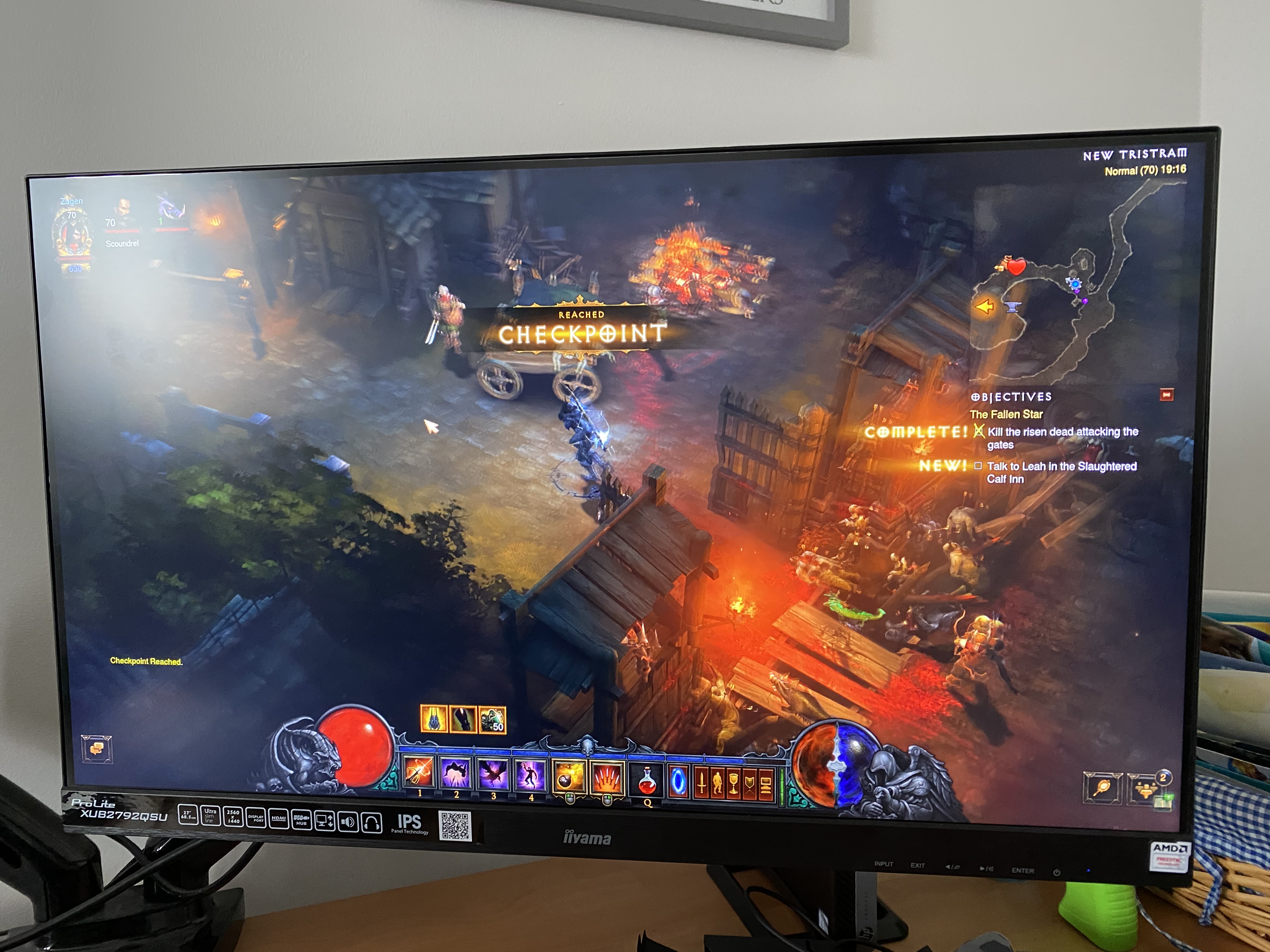

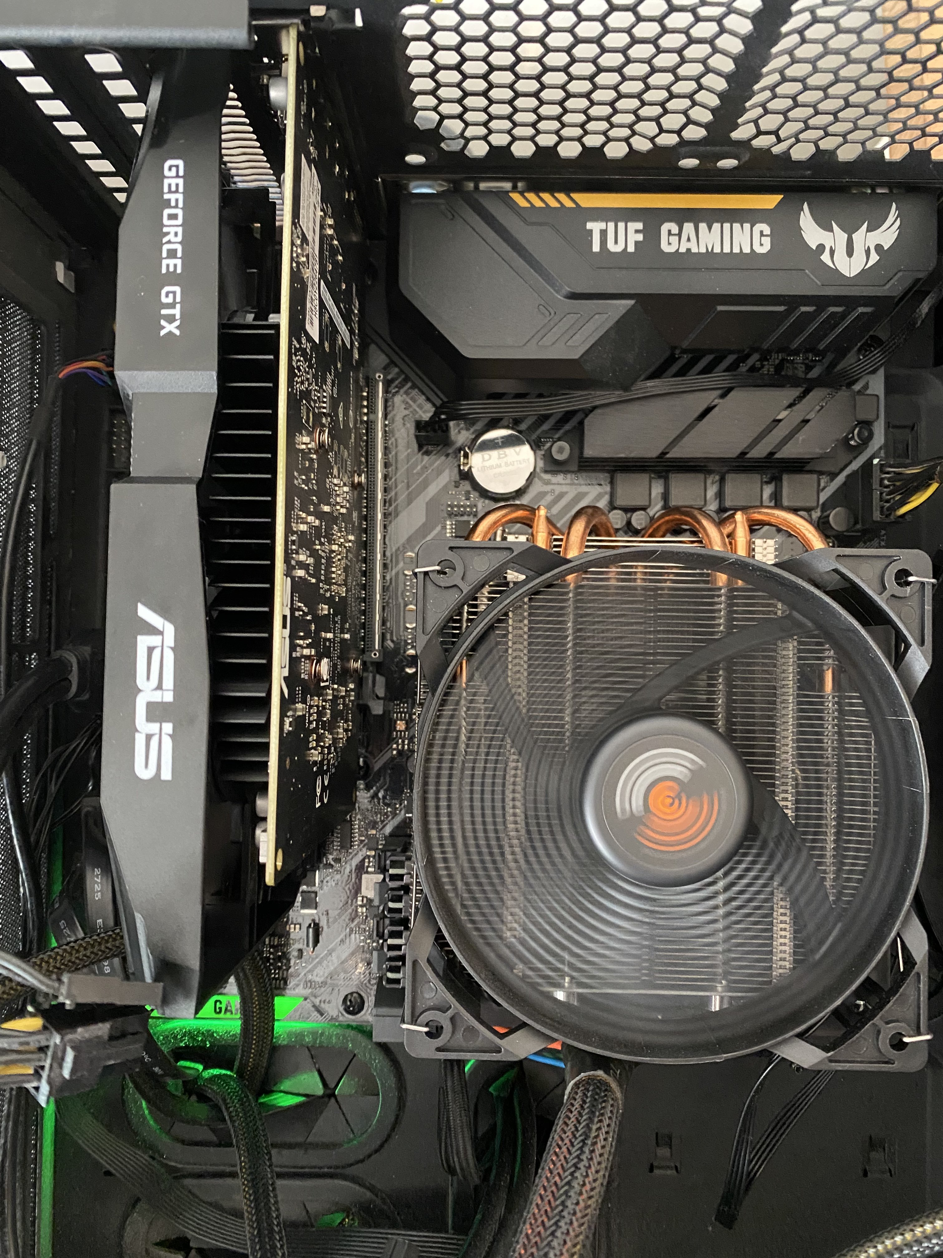

Ok GPU is working and have been smashing games on it for 2 hours no sweat, So deffo Not the Graphics Card :-/
20 minutes ago, leeknight1981 said:
Ok GPU is working and have been smashing games on it for 2 hours no sweat, So deffo Not the Graphics Card 😕
Can you try to do the steps from above with a spare USB Key and Unraid and see if it works on this machine?
Not really No and I don’t have a spare USB now I’m not at home and this is my mates gaming machine, So I’ll have to leave the card here and he will set UnRaid up when he has 5 mins but I’m 99.6% certain it’s not my hardware / server at fault 😜

Guess Who's back...
OK GPU Works in a gaming machine flat out, It also works in UnRaid IE Shows UP and in the plugin.
So i put it back in my server, work's fine! Then i install the Plugin Card Shows up, Ver No, GUID Etc. Then i Re Enabled docker And Boom that same fault in logs Web - GUI locks up and freezes :( So Deffo Not the GPU or Server as it only happens when i install Plugin and or Re Enable Docker. More than Happy to assist with this via teams or what ever :) Logs below in order of time. Before shut down, Re boot, Install plugin, re enable docker etc :)
Have you tested it also with Unraid on the gaming machine? This was the main question...
1 minute ago, leeknight1981 said:
removed Plugin
Yes? And what's the problem here?
Yes we installed UnRaid on the Gaming Machine, Yes the Card showed up and yes it showed in the Plugin... but nothing on that machine to test as was just set up to see if the card was visible etc as its not my machine :(
Not saying there is a problem was showing what was in the logs after i removed it :) Id just like to get to the bottom of this as someone else is having the same issue i think. All was working Fine then an Update then its stopped working. Iv tested the card it outputs and games Fine... It shows up in a Fresh UnRaid - Plugin. I put the card back in mine its fine it shows install the plugin disable/reenable docker then i get the fault and whats in the logs the same as the chap above :)
If it showed up and not freezed on the gaming machine then it seems to me that this is a hardware combination issue on your machine.
As said at the time there was only a driver update of the plugin and nothing else, a rollback should have it enabled again, and the changes to the plugin itself are only cosmetic and or add new features like the notification if a new driver is available and do nothing to the drivers itself.
If you search this thread for this issue this was reported a few times but after a BIOS reset/update/change everything seems to work again, some user even told me that it workes after he put the card in another system and put in back again in his server.
This issue can also happen with too long and too less shielded risers or defective risers.
Have you already tried the steps that I've linked above?
You also said something about a mining rig, do you have a chance to put another Nvidia card in the system?
