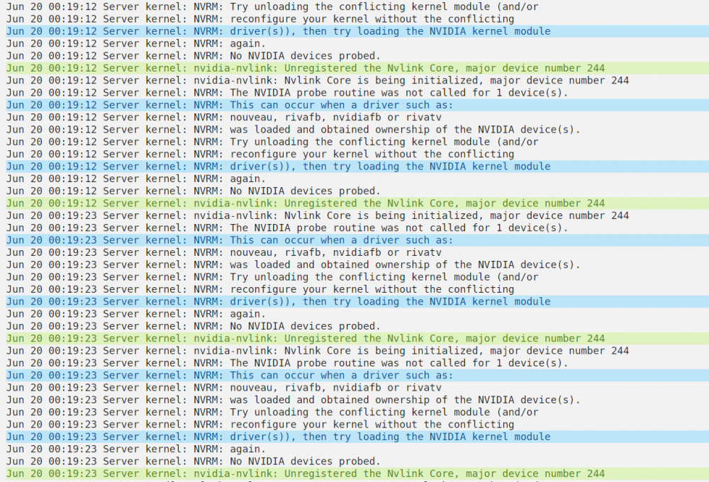

everything works fine, except I keep getting this error in the logs:
Jun 20 00:19:23 Server kernel: NVRM: The NVIDIA probe routine was not called for 1 device(s).
Jun 20 00:19:23 Server kernel: NVRM: This can occur when a driver such as:
Jun 20 00:19:23 Server kernel: NVRM: nouveau, rivafb, nvidiafb or rivatv
Jun 20 00:19:23 Server kernel: NVRM: was loaded and obtained ownership of the NVIDIA device(s).
Jun 20 00:19:23 Server kernel: NVRM: Try unloading the conflicting kernel module (and/or
Jun 20 00:19:23 Server kernel: NVRM: reconfigure your kernel without the conflicting
Jun 20 00:19:23 Server kernel: NVRM: driver(s)), then try loading the NVIDIA kernel module
Jun 20 00:19:23 Server kernel: NVRM: again.
Jun 20 00:19:23 Server kernel: NVRM: No NVIDIA devices probed.
Jun 20 00:19:23 Server kernel: nvidia-nvlink: Unregistered the Nvlink Core, major device number 244
I can't seem to get any stats on the GPU in the unraid gui, but the passthrough works just fine in Windows VM ... it's not really a show stopper, would be nice to get stats in unraid ... and not fill the log with this error ... any help is appreciated.
Please post your Diagnostics (Tools -> Diagnostics -> Download -> drop the downloaded zip file here in the text box).
I really can't say anything without knowing what card that you own and so on...
attached the diagnosis,
the card is a Quadro RTX 4000, I read elsewhere that I shouldn't expect the driver to be used when passing through the card entirely to the guest OS and that the plugin is mainly useful for using the GPU with Docker containers ... is that an accurate understanding?
removing the plugin didn't seem to have any negative effects ... and I don't see the errors in the logs after removal.
does using the plugin ad any benefit to a vm passthrough gpu? can I get the stats in unraid gui if it's passthrough?
appreciate the help for as I'm trying to understand all this!
server-diagnostics-20210620-1532.zip
The plugin is mainly for that use case if you want to use the card for example in your Docker container for transcoding, foldingathome, boinc, mining,... (there are many use cases)
No, this plugin does nothing if you are using it like in your case in a VM and bound it to VFIO, no you can't get the stats of it if it's passed through to the VM because the VM has exclusive access to it.
thank you for clarifying! makes sense!
any clues from the attached diagnosis why it doesn't detect the card? (even with VM off / no passthrough)
Yes, because you've bound the card to VFIO and if you bind it to VFIO it is exclusively reserved for VMs and strictly speaking the host, or better speaking in this case the driver that runs on the host, can't see it.
ah ... well that also makes sense ... (I have to learn more about VFIO I guess)
