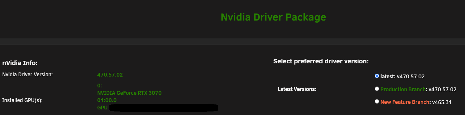

EDIT: Now tested with a RTX3070:

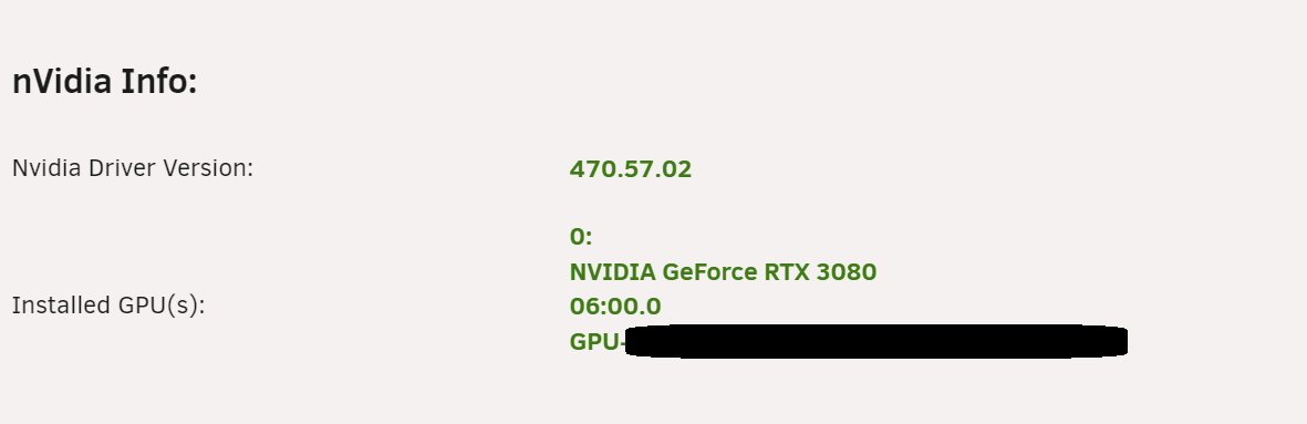

EDIT2: Tested also with a RTX3080:
