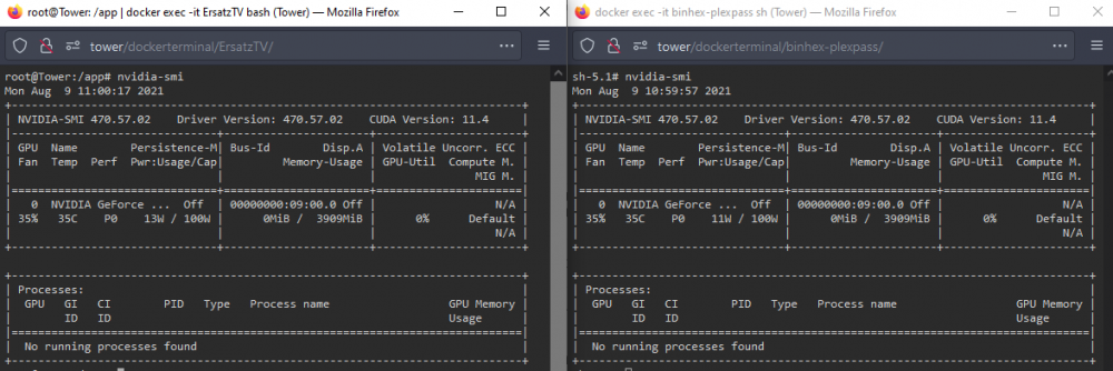

I have a 1650s that I use for transcoding in a plex docker and in an ErsatzTV docker (emulates DVR scheduling of plex media to the Live TV section). When I boot the server up and check the nvidia plugin, I see the card listed as well as its info and driver version. If I go into the console of both docker containers and run the nvidia-smi command, I can see the card listed and working.
After a few days though, the card just disappears from the nvidia plugin, and the containers. If I run nvidia-smi in the unraid console, I still see the card listed in the devices, and if I run the lspci command, I see it listed in the hardware there as well.
It is plugged into the first pcie slot. I have a sata adapter plugged into my m.2 slot, in order to add more drive capacity to the motherboard. My PSU is 650w, so it should be enough to power everything simultaneously.

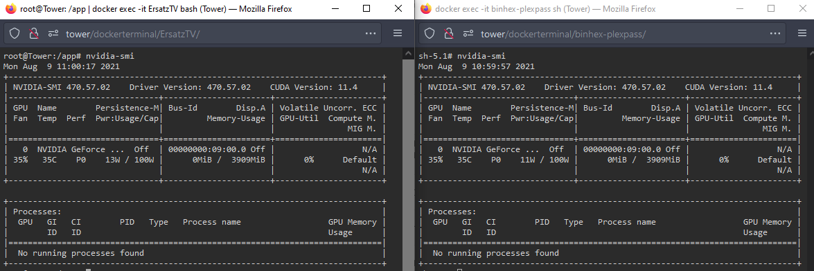

So, I actually ended up crashing my server by trying to run nvidia-smi on the unraid console inside a vm.

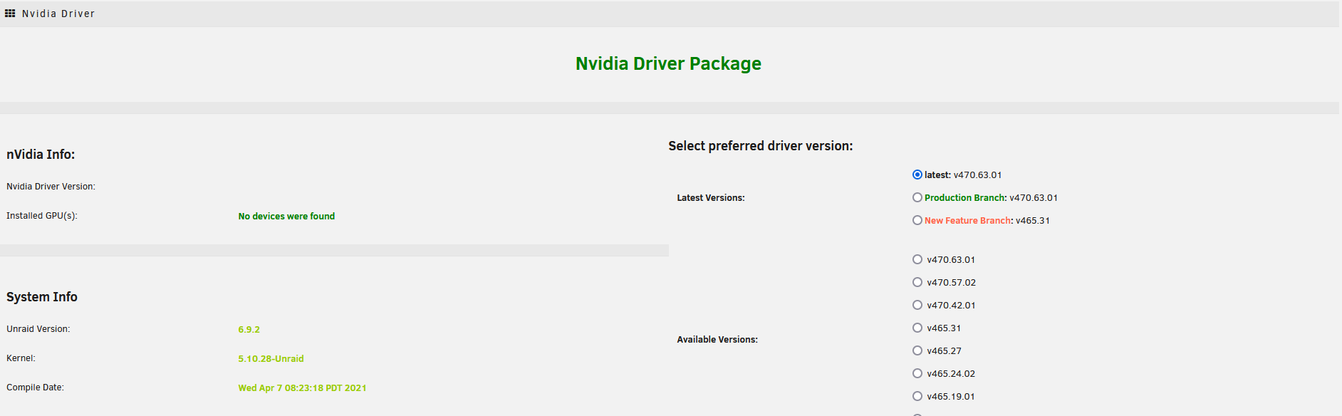

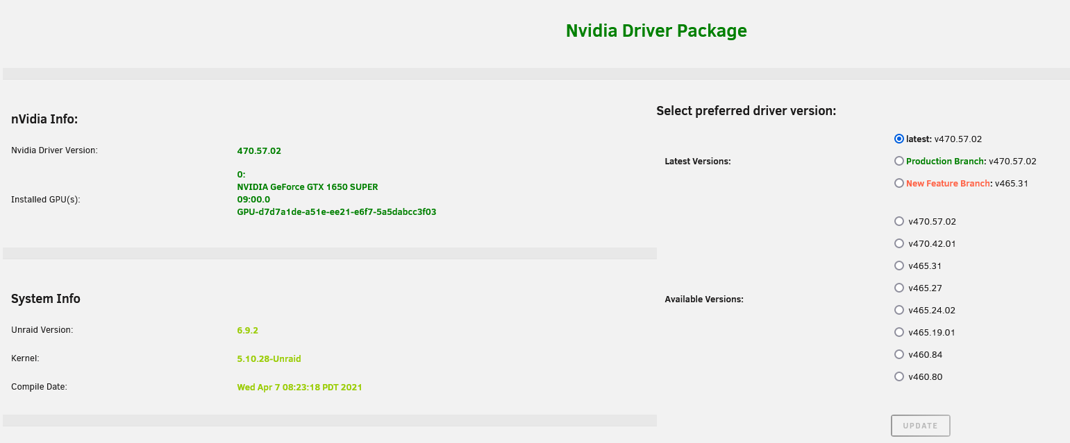

Now that it's rebooted, its recognizing the graphics card, which Ive attached a couple images of. You can see that the server recognizes it.
Now that it's reappeared, I'll have to wait for them to disappear for some pictures of it, but it basically stops being detected by the plugin. Since it isn't detected, the docker containers can no longer utilize it. (which I can show when it happens again). This isn't specific to this graphics card, as it happened with my old 970 too.
Edited by Agent531C
7 minutes ago, Agent531C said:
inside a vm.
Inside a VM?
Can you please post your Diagnostics on what hardware do you run this card? The next time it dissapears from the system please also download an post the Diagnostics, otherwise troubleshooting is really hard...
You can also try to enable persistence mode, simply issue 'nvidia-persistence' from the console.

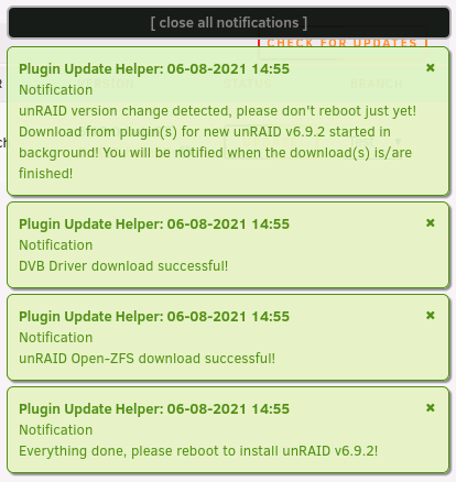

Have you got a message when upgrading from 6.9.2 to RC1 to not reboot yet and that the download started in the background?
Thank you, your amazing!
Simple reinstall has sorted it out.
No I did not get a message about a download being started in the background.
Interesting, can it be the case that you where on a old plugin version?
How did you upgrade? Through the built in updater?
Under normal circumstances you should get a message that you should wait to reboot because a new unraid version is detected, should have looked something like this:

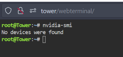

I'm having a similar issue with the graphics card no longer being detected. This has happened to me one more time a few months ago and card was visible after a restart.
No hardware changes were done inbetween these events and no major unraid version changes, only the plugin/driver updates.
nvidia-smi output from unraid console or from a container (plex) now shows "No devices were found"

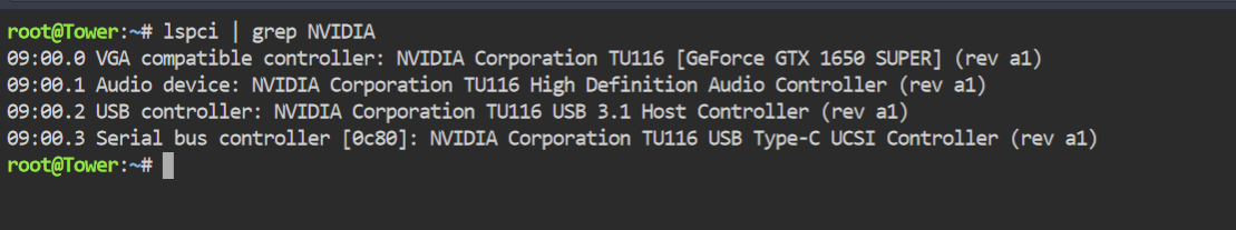

Hi, thanks for the quick reply.
lspci does show the card (even if not visible in the plugin or for nvidia-smi):
09:00.0 VGA compatible controller: NVIDIA Corporation TU116 [GeForce GTX 1660 SUPER] (rev a1)
09:00.1 Audio device: NVIDIA Corporation TU116 High Definition Audio Controller (rev a1)
09:00.2 USB controller: NVIDIA Corporation TU116 USB 3.1 Host Controller (rev a1)
09:00.3 Serial bus controller [0c80]: NVIDIA Corporation TU116 USB Type-C UCSI Controller (rev a1)
And doing 'modbprobe nvidia' had no effect, no change in the plugin displayed info.

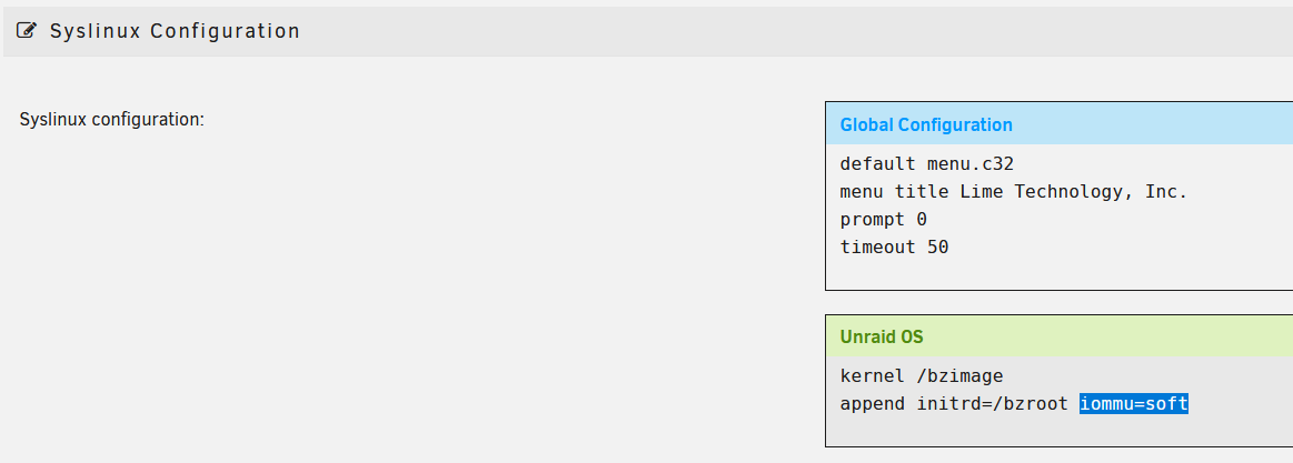

I have two things that might help:
  1. Can you try to add this to your syslinux.conf:
    (Got to "Main", click on the blue text "Flash", scroll a little down and add "iommu=soft", scroll to the bottom, click "Apply" and reboot)
  2. If the above doesn't help please try to turn off AMD-V/AMD-Vi in your BIOS.
I have now many reports of GTX1650/Super and GTX1660/Super that fell of the bus and/or are not visible after a few days, don't know if it's related to the cards itself or if it's a hardware (combination) issue in general.
I've added the iommu bit to the config, so Ill give it a few days and see if it drops off again. My old 970 would drop off as well. I initially thought it was a graphics card problem, so It was incentive to replace it, but now that its happened on both, Im sure it something else.
The BIOS option sounds like it could be a culprit as well.

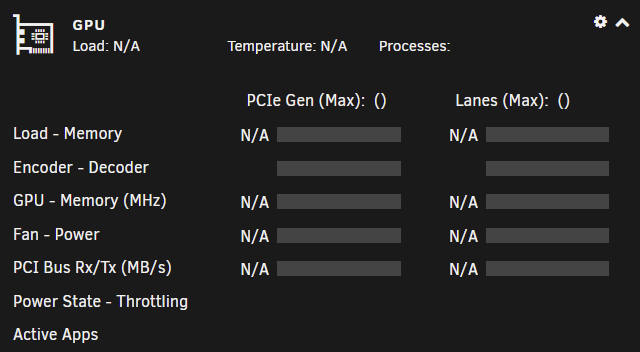

Has anyone gotten a RTX 3060 12GB gpu to work?  I had a 3060 Ti installed and working, but swapping it out with a 3060 has been extremely problematic.  It shows in Tools->System Devices, but only sometimes in the Nvidia plugin.  The GPU Statistics plugin doesn't show it at all.  When it does show, if I run nvidia-smi it shows usage on the console, but then disappears on the driver plugin page.  I've uninstalled/reinstalled the latest driver, removed the GPU Statistics plugin, rebooted countless times, it's just really flaky.
Can you attach the Diagnostics?
Which verison from the driver where you using?
What brand was the 3060 and the 3060Ti?
But yes, I think a few pages back someone said that his 3060 works flawlessly, I only got reports from 3070's and 3080's that also work flawlessly.

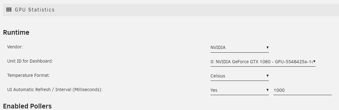

Have you made sure to change the UUID from the card on the GPU Statistics plugin page?
If it doesn't showed up anyways you have to make a post in the support thread.
When you run nvidia-smi it dissapers from the plugin page?
