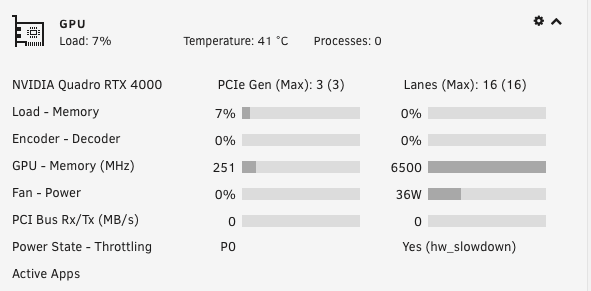

The GPU will not do hardware transcoding in Plex anymore. Or Folding at Home. The GPU Dashboard shows switching 0% to 7% continuously with 0 processes running. And about 30-35 Watt usage.
The mainboard is changed  lately, and I have seen processes run on the GPU (Plex, FaH).
Any ideas?

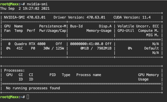

Are you sure that it isn't working, have you tried to issue the command 'nvidia-smi' from the command line yet and see what it tells you, please post a screenshot when transcoding something or using it in fold at home.
If it shows some utilization it definitely is doing something.
Have you tried to restart the server yet? From what motherboard did you switched from? Try to disable the C-States.

I am sure it isn't working. Disabling C-states did not change anything.
Isn't it strange with Trotling at "Yes HW" when not in use?

Can you open a container console window and try to issue the same command just to be sure everything is working inside the container?
What you can do too is that you open up a terminal from unRAID and type in 'watch nvidia-smi' this will call nvidia-smi every 2 seconds and then try to force transcode a video file and see if anything shows up in the line where it says "No running processes found"

Plex is working. Embarrassing. "Enable HW transcoding" was disabled in Plex server setup. I had an error with the cache, needed to reformat, did app restore. But did not check the Plex server setting.
Sorry for the trouble.
It is a FaH problem I have, not a driver issue.
Thank you very much for the help.

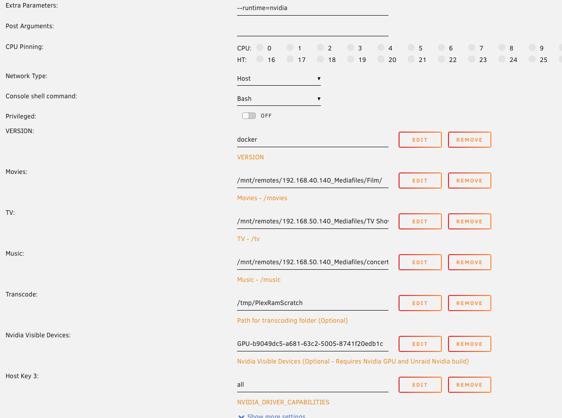

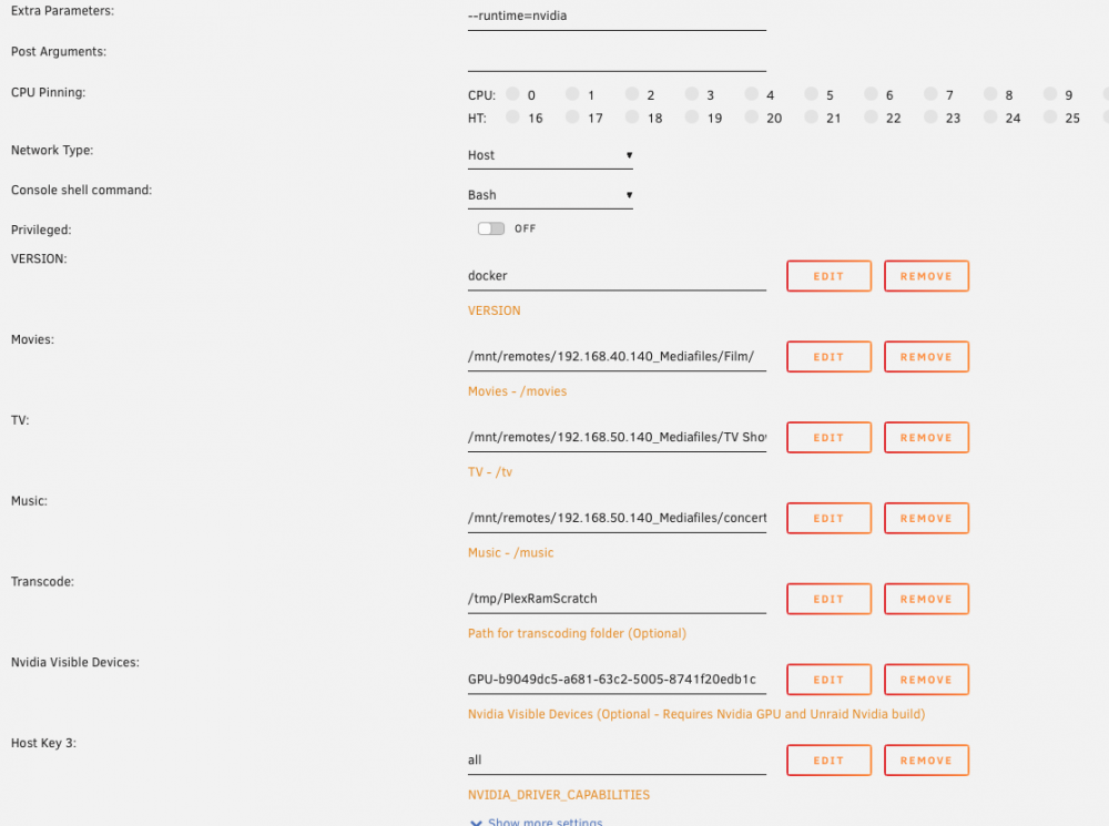

I can't figure out what I'm doing wrong but it seems like everything should work, but no luck.
Please see the album below this is driving me nuts. This should show every relevant setting. I have the same config in plex and neither plex or jellyfin is showing any GPU usage when it should be transcoding, but the CPU usage is still climbing as high as ever. I must be missing something and could really appreciate some help!
https://imgur.com/a/5xEfXdv
Do you force a transcrode from within the web player or the application where you play the file?
What kind of media do you want to transcode?
For Plex you need a Plex pass to get transcoding to work.
What container are you using?
What does the overwiew section in Jellyfin tell you?
Don't forget that it is possible that the file that you transcode maybe also needs to be transcoded in terms of audio and that is producing also load on the CPU.

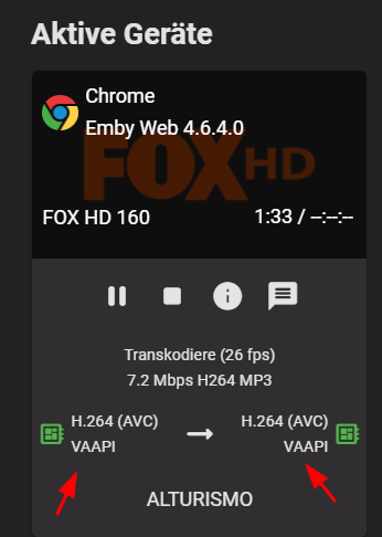

what does the dashboard say while playback, here from emby which should be pretty similar
here you see how the decode/encode is running, in my case vaapi (intel hw acc)

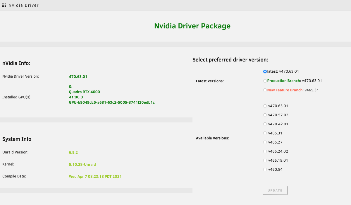

What Branch is the most stable version?
That's a difficult question...
If you want the stable driver then stick with the Latest Production Branch.
If you want the latest and greatest stick with the New Feature Branch.
They should be both functional but the Production Branch is basically the stable branch.
Is there a way to download an older driver, that isn't listed in the options?
I want to use the 460.73 driver.
I'm using nsf miner for ethereum mining, while running a plex docker in the background.
The older driver is the only way I know how to get the overclocking of the gpu to work.
Since the nsfminer docker isn't supported anymore, I was hoping to stick to the older driver,while figuring out a more future proof solution.
I think you are talking about 460.73.01
If you are talking about 460.73.01, you can but you have to be on unRAID version 6.9.2
The reason for this is that I only compile the latest current available Production and the New Feature Branch from the driver at the time a new unRAID version is released and all following drivers for this unRAID version.
After a new unRAID version is released this process starts from the beginning.
Also don't forget that older versions from the Nvidia driver may fail to compiles on newer Kernel versions.
