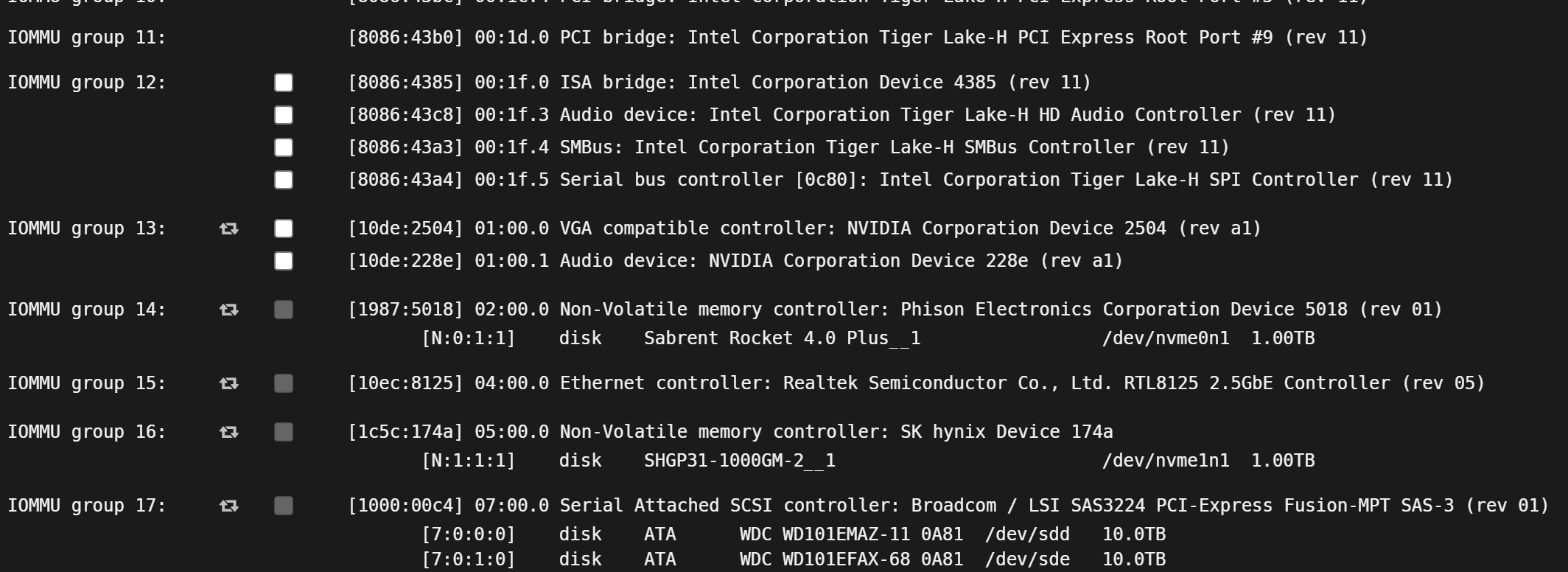

Here's the diagnostics.  I've now also tried disabling the iGPU along with having a dummy plug and display plugged into the 3060, along with updating Unraid to 6.10.0, nothing works.  The diagnostics file was prior to updating to the latest Unraid, if I can get it working and it matters I'll roll-back.
unraid-diagnostics-20210818-0654.zip

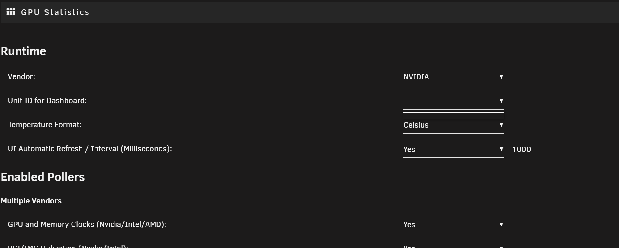

@ich777 I got it work - I think.  Changed boot/PCI devices to legacy and it then showed up for the first time under the GPU Statistics plugin, but it kept dropping out for no apparent reason.  I could get it to drop just by doing different things to access the card, such as going to the Dashboard page where the the load monitor is, going to the Nvidia driver plugin page, running nvidia-smi, it would fall out after doing a couple/three of those things reliably.  I then tried different configs of the iGPU being Auto/Enabled/Disabled with it being primary vs PEG1 (3060).  None of that seems to matter.
If I had a monitor connected and on, it wouldn't drop out that I could see, but if the display shut off, upon a reboot, the 3060 would drop out like before.  So then I tried an HDMI dummy plug on the 3060, that didn't work, then tried a DP dummy plug on it and that didn't work, but for some reason having both the HDMI/DP dummies in it hasn't fallen off yet.  I've tried the normal stuff to break it and it hasn't and rebooted/cold-booted and it's staying active.
I don't really understand why it's working like that, but I'm not going to breathe on it.  :)  Thanks for your help.  If you want me to guinea-pig some other stuff let me know.

Watching the GPU Statistics output, it looks as though the card is not entering any alternate power state (staying in P0) now.  I don't know if that is the result of legacy mode or because I have dummy plugs inserted or what, but I'm fine with that.  The plugin never worked for me in UEFI mode with the 3060, so I don't really know what it was doing, and if it dropped out, I wouldn't be able to see the power state anyway.  It only draws around 50w of power even with the GPU not dropping its core clock speed, so nbd.

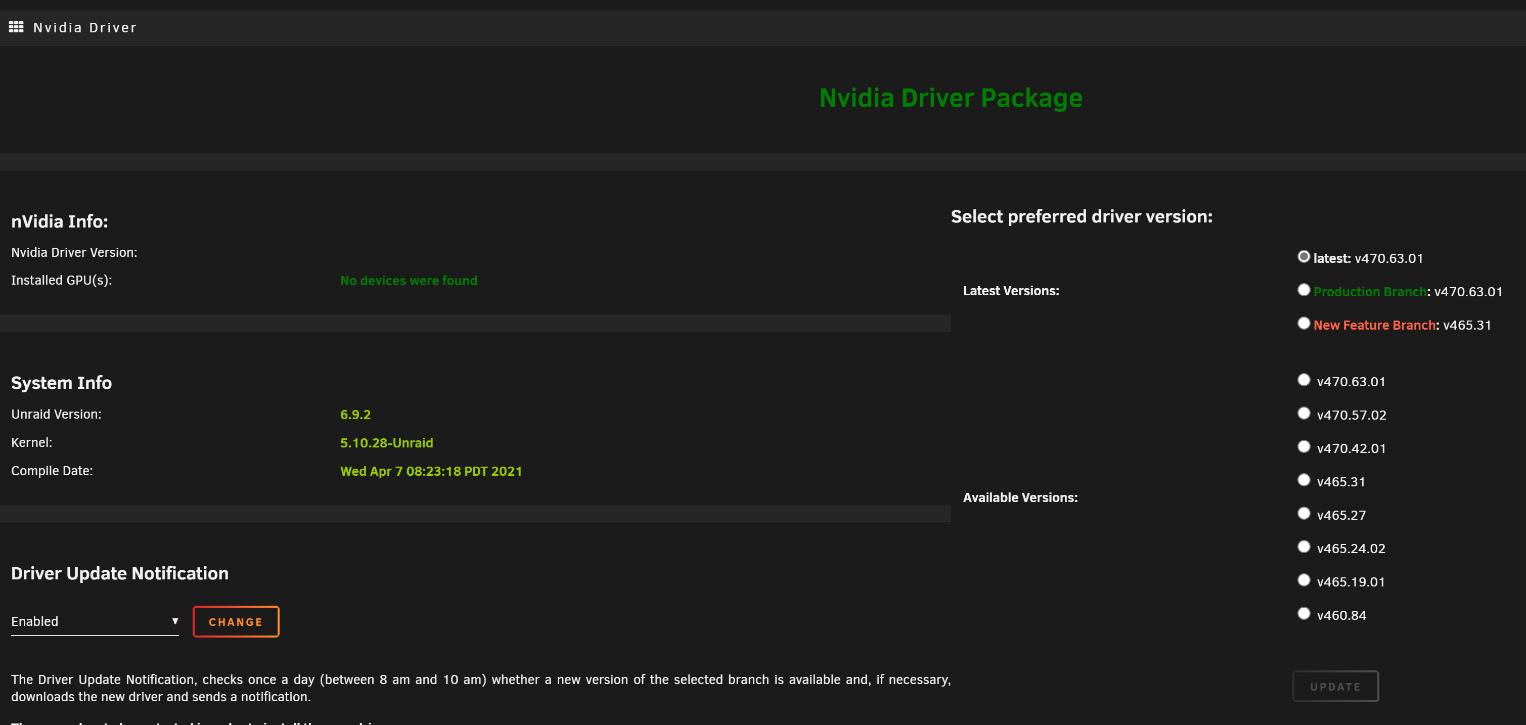

Today i tried to reinstall the Plugin because i got some errors on Startup:
modprobe: FATAL: Module nvidia not found in directory /lib/modules/5.10.28-Unraid
During the reinstall the download of the driver fails. Anyone experiencing similar problems?
plugin: installing: https://github.com/ich777/unraid-nvidia-driver/raw/master/nvidia-driver.plg
plugin: downloading https://github.com/ich777/unraid-nvidia-driver/raw/master/nvidia-driver.plg
plugin: downloading: https://github.com/ich777/unraid-nvidia-driver/raw/master/nvidia-driver.plg ... done
plugin: downloading: https://github.com/ich777/unraid-nvidia-driver/raw/master/packages/nvidia-driver-2021.07.30.txz ... done
| Skipping package nvidia-driver-2021.07.30 (already installed)
| WARNING - WARNING - WARNING - WARNING - WARNING - WARNING - WARNING - WARNING
| Don't close this window with the red 'X' in the top right corner until the 'DONE' button is displayed!
-----------------Downloading Nvidia Driver Package v470.63.01------------------
----------This could take some time, please don't close this window!------------
--------------Can't download Nvidia Driver Package v470.63.01-----------------
plugin: run failed: /bin/bash retval: 1
Updating Support Links
Finished Installing. If the DONE button did not appear, then you will need to click the red X in the top right corner

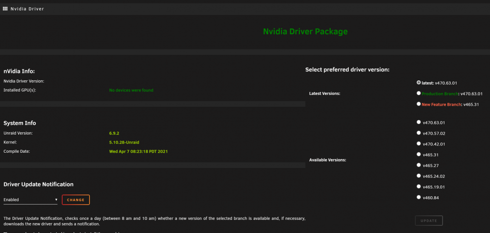

Yes such a message pops up now and then, the message says that the plugin can't download the driver itself.
Have you installed any ad blocking software in your network like PiHole or AdGuard?
Can you download this archive: Click?
If you can't download this archive something is blocking the connection to Github.
From here I can download the file just fine.
Please try to uninstall the plugin and reinstall it again.
Okay, seems like a temporary problem. Today the installation and download just works. Yesterday i gave up after 6 tries.
Thank you very much for your time.
