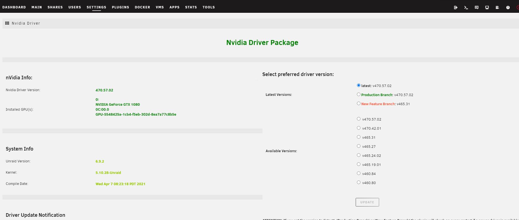

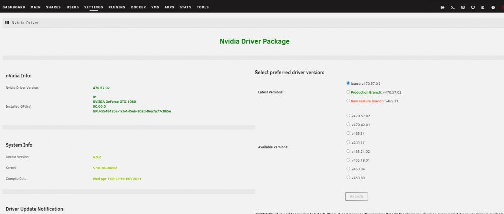

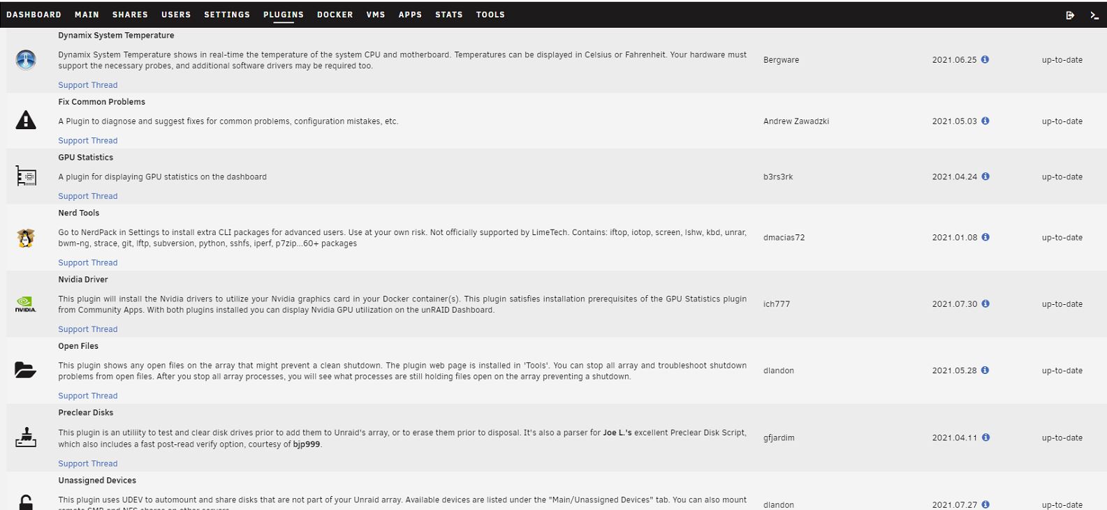

Also check if the plugin looks like in my screenshot above, the Update Notification should be in between System Info and the Download button.

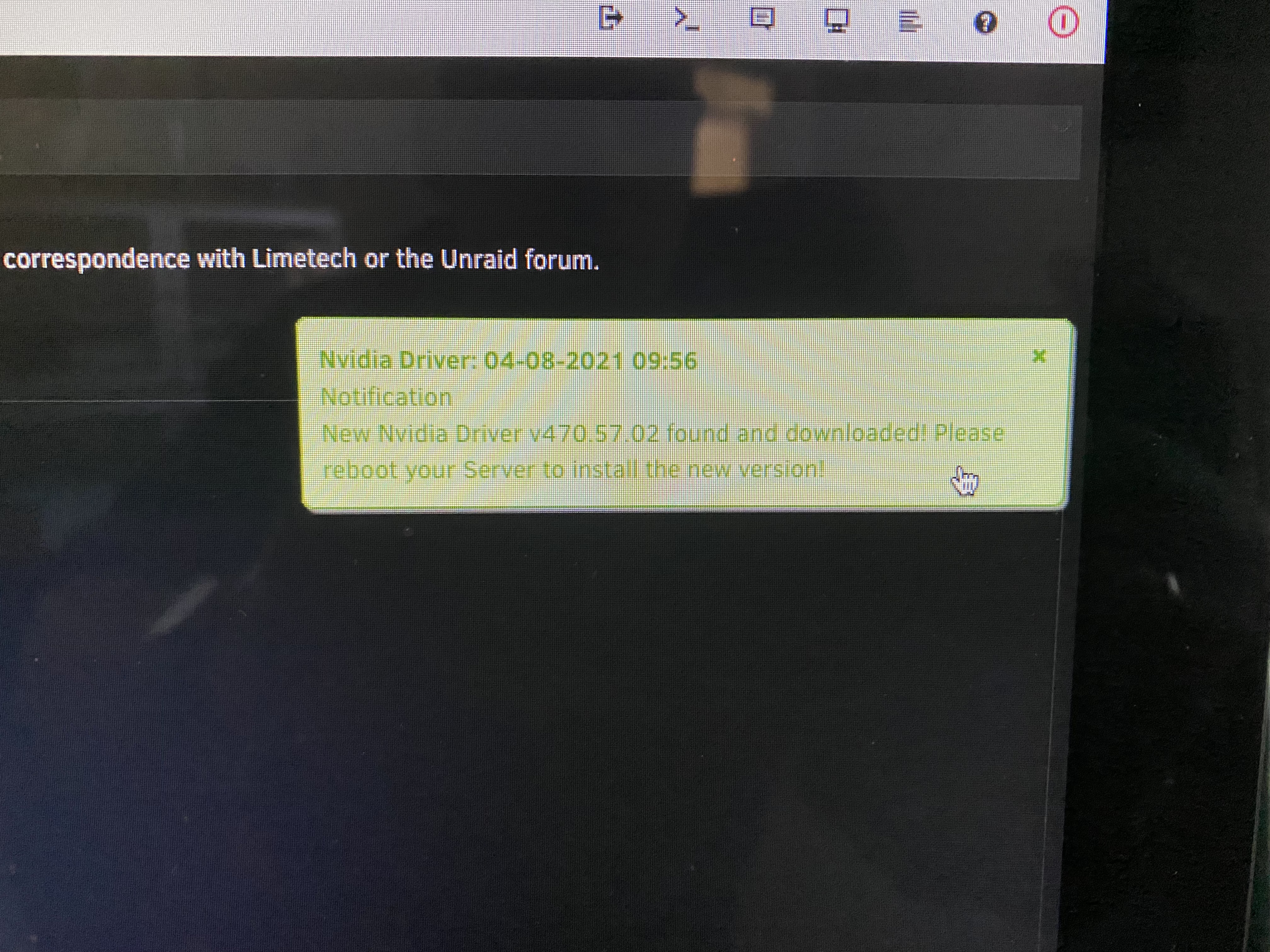

8 minutes ago, leeknight1981 said:
This morning the GUI had locked up and that notification was on the screen.
Do you boot in GUI mode or do you leave a page from unRAID open on your local PC?
Are you sure that the server was actually locked up and not only the GUI on this instance from your browser?

What version from the plugin itself are you running, "2021.07.30" is the latest one.

Yes my server locked up and shows that error in the logs and the update notification before i restarted and it showed the newest as installled as if it was installed without reboot
no it loads into unraid normal not GUI mode. i do have a tab open on my imac during the day thats when i noticed the GUI locked up i clicked close on notification and it wouldnt Go so clicked main and it just sat there with three wavy lines.
Try to close Safari or the Tab for unRAID and reopen it again, I sometimes also have that problem that a Tab freezes when I'm on the Docker page and it seems that the Server is frozen but actually only the browser is frozen and I have to reopen it.

On which plugin version are you because of the screenshot?

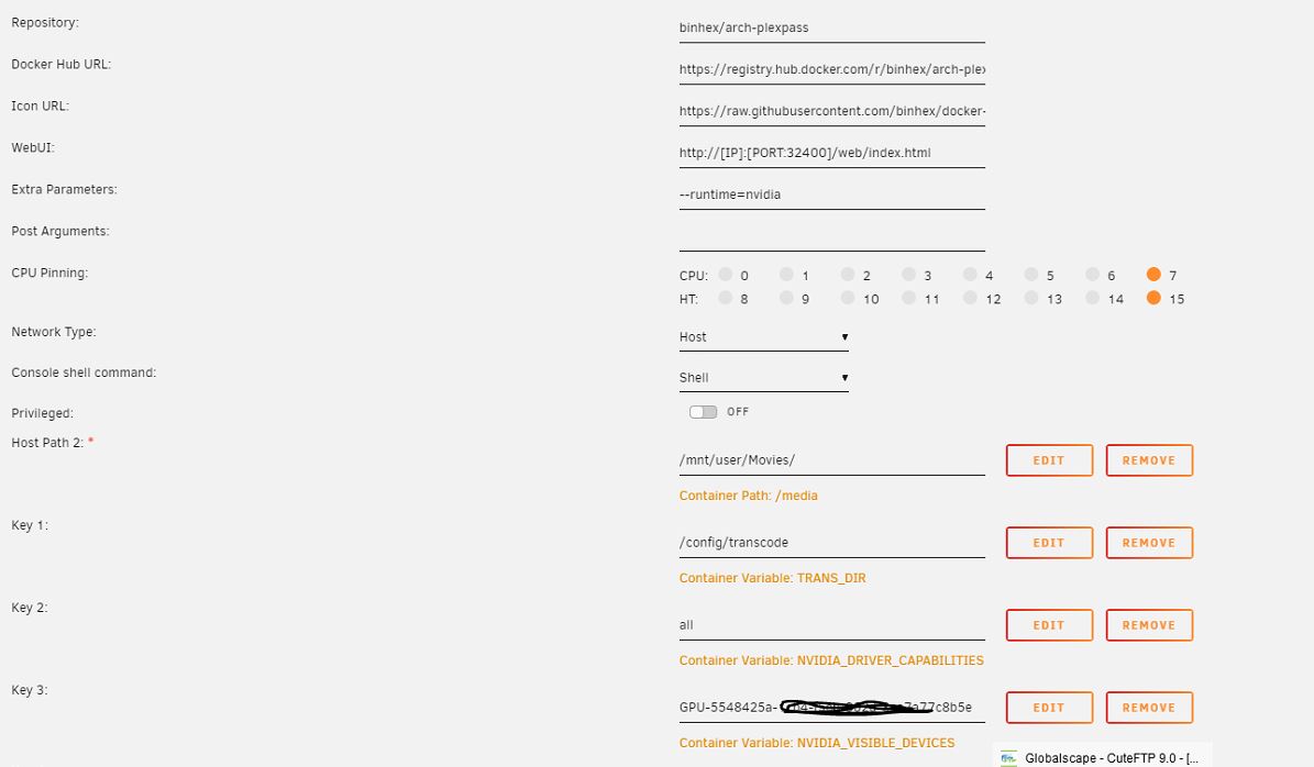

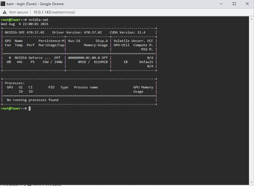

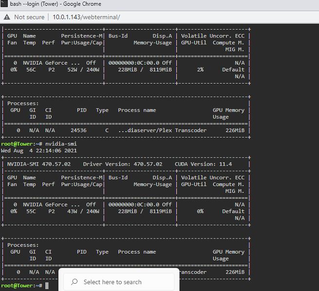

Having trouble getting my GPU Transcoder to work. I've followed all the steps and it's still using CPU to transcode.
I've watched the SpaceInvader Video along with reading through here. I've tried the Plex LinuxServer Docker along with the binhex-plexpass. I believe I've attached all the screenshots needed. Also tried rebooting the server along with the plex docker

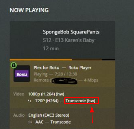

What CPU are you using, from what I see it is using the Nvidia card and not the CPU for video transcoding.

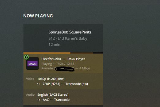

The screenshot from Plex shows that it uses HW but also keep in mind that it transcodes the audio and eventually subtitles, this is done on the CPU.
From the first screenshot from 'nvidia-smi' you can also see that one process is using the card (the better command would be 'watch nvidia-smi' since this will update the output from nvidia-smi every two seconds, to abourt press CTRL+C).
The next thing is that it looks like you haven't configured GPU Statistics, you have to go to the Settings page and on the bottom press on GPU Statistics, from the dropdown select Nvidia, select the GPU UUID from the dropdown and on the bottom press apply.
Hope that helps and makes sense to you. ;)
as seen here
it used hardware video transcoding, so you are good to go like @ich777 mentioned, may follow the other steps he described to get the correct outputs, also u see in the bar to the right (light bar) how far the pre transcode already is and already buffered.

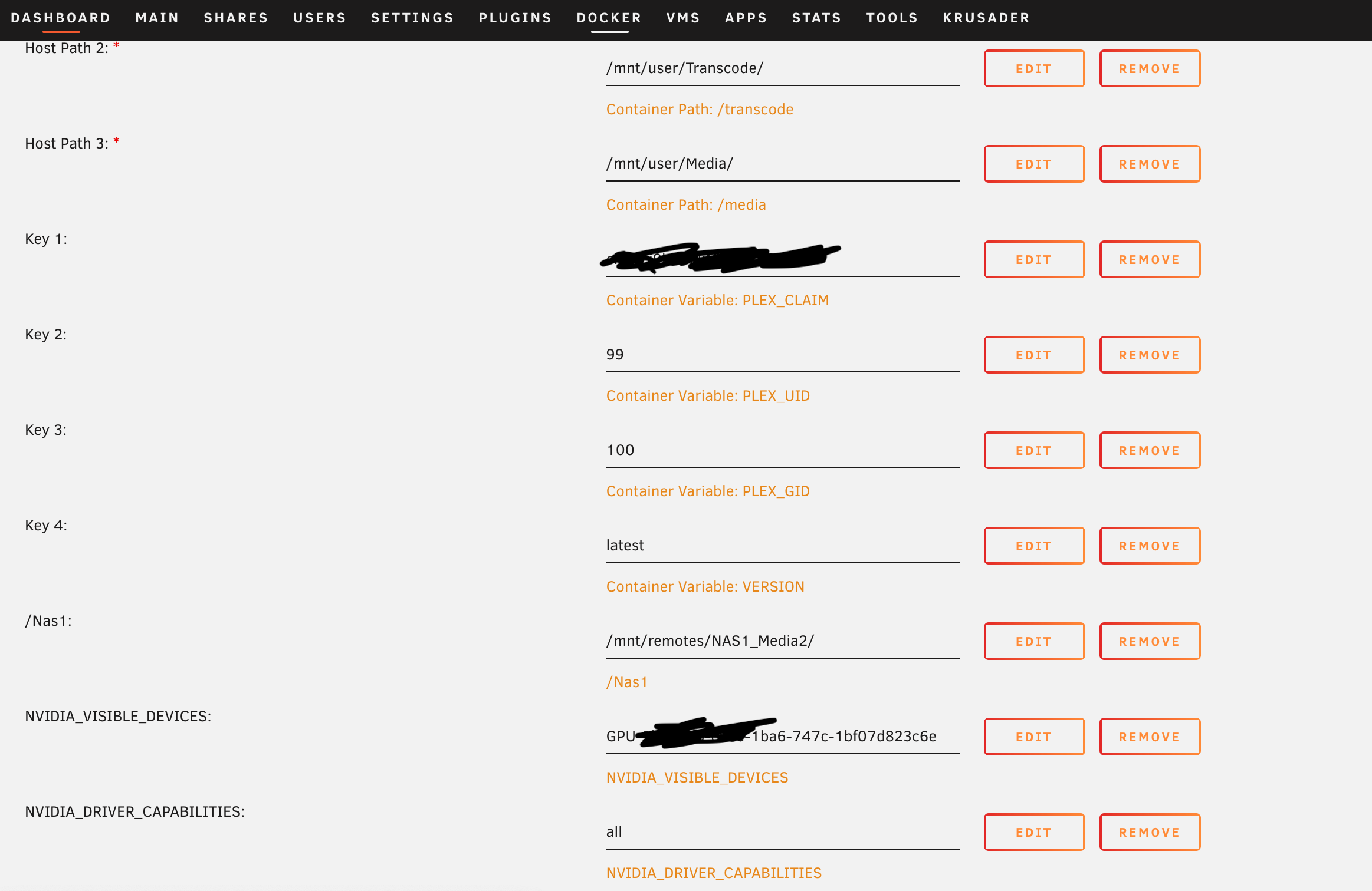

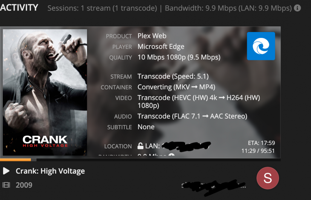

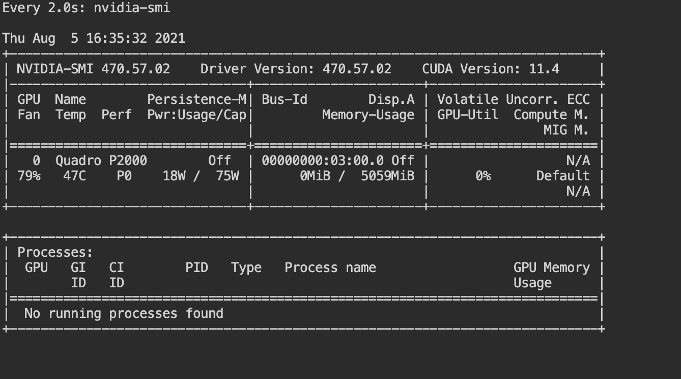

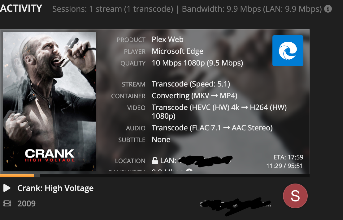

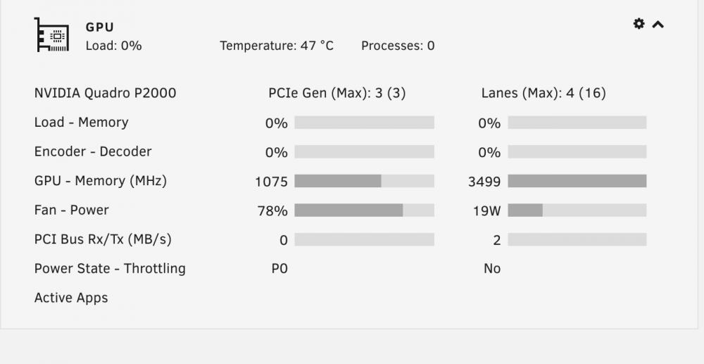

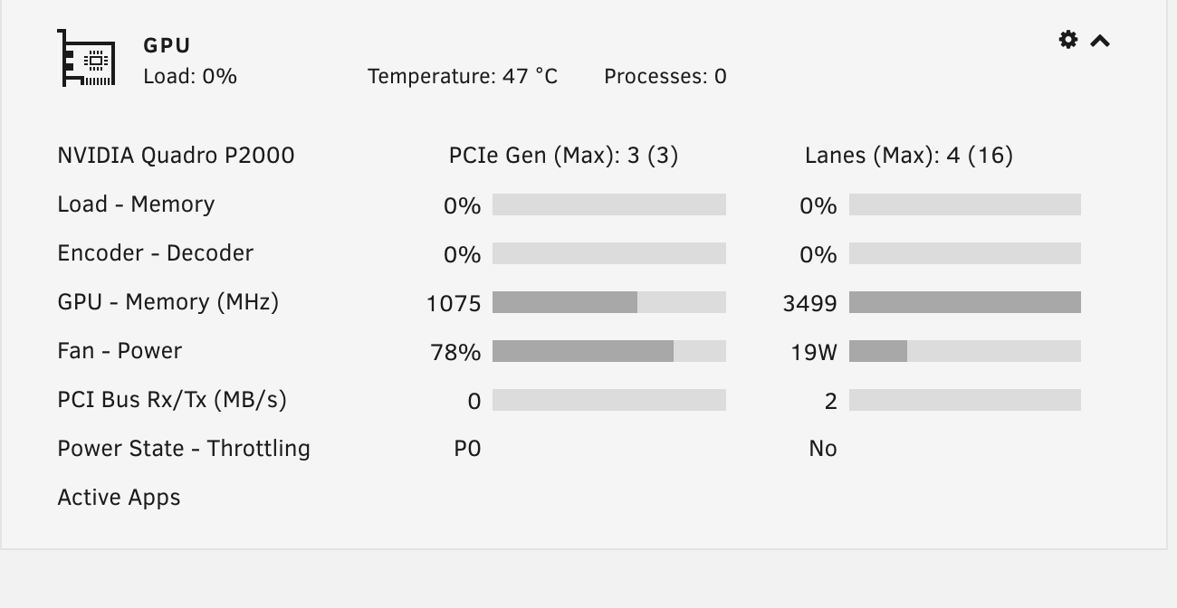

@ich777I am actually having this exact issue, except I am not seeing any processes in watch nvidia-smi.  It is using my 10850K iGPU despite not having it setup to use igpu at all.  Im not even sure how it accesses it.  I see the activity in my igpu though on gpu statistics.
My trex mining docker uses my P2000 fine, as does emby.  I am not running them while I am trying to get Plex to work.
I have tried reinstalling the nvidia driver plugin, tried different driver versions, tried different plex versions and repositories.  I even tried a fresh version of Plex thinking maybe my Plex config was bad.  My VM is not using any gpus, I have tried several system reboots too.  This all used to work fine and then one day a few weeks ago it stopped.
At one point, disabling HDR tonemapping in Plex allowed Plex to use the P2000 again but then that stopped at some point too.
My biggest issue is, when using my iGPU my Plex docker crashes often.  I then configured the iGPU correctly and it is more stable but still crashes from time to time.  I really need this P2000 working as it was stable as a rock.

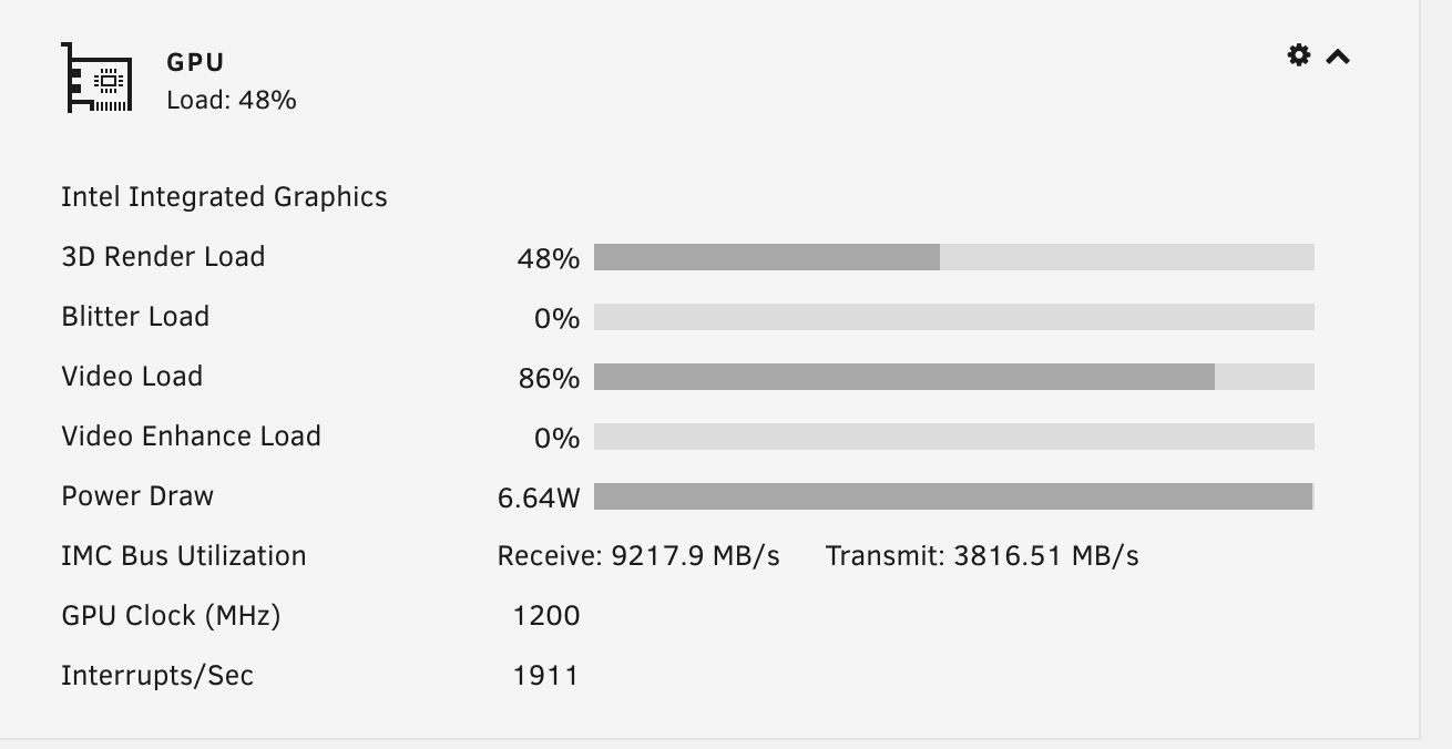

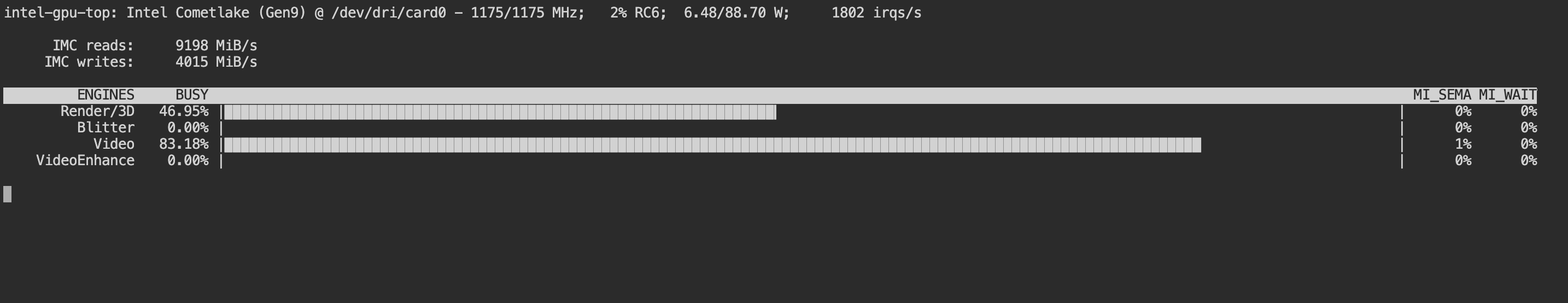

and you dont have /dev/dri as device or in extra parameters setup ?
and about HDR tone mapping in plex, check plex forums and you see some threads about it, there are workarounds howto ...

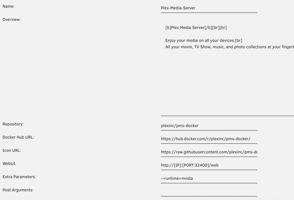

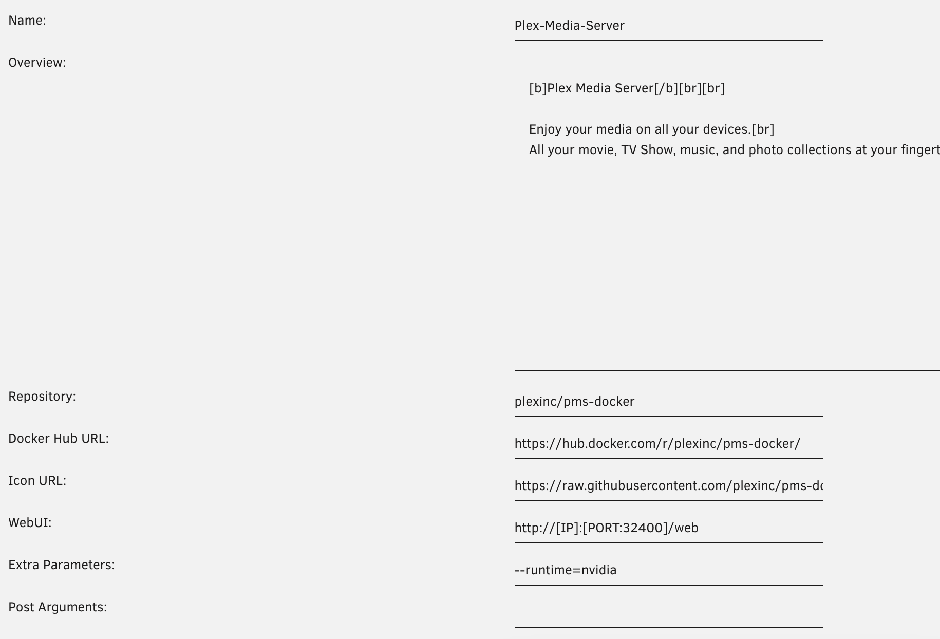

No dev/dri.  I have —runtime=Nvidia in my extra parameter spot.
Hdr tone mapping did work a month or two ago on my p2000.  Do you happen to have some links to those threads?  Navigating Plex forums is a nightmare.
Can you send screenshots where it is visible that it uses the iGPU instead of the Nvidia GPU?
I can't imagine that it uses your iGPU when you don't passed through the device /dev/dri like @alturismo said before.
Why would you do that when Emby and Trex are fine using them, then there must be something wrong with the template itself.
Can you post a few screenshots from your Docker template with the Advanced View turned on in the top right corner?
I have tried binhex, linux server, and offcial plex docker builds with their templates.  I even tried starting fresh.  Here are all the screenshots.  I can see in gpu statistics that my intel igpu usage shoots up when i transcode, and goes down when i stop transcode.
Sorry but I really can't help here since I can't think of a way that the Container can even see the iGPU without create a device mapping with '/dev/dri' in the template.
It definetely doesn't have anything to do with the Nvidia plugin.
From what I see try to uninstall the Intel-GPU-TOP plugin and make sure that you don't activate the iGPU on boot with /boot/config/modprobe.d/i915.conf and reboot. After you did this the iGPU should be deactivated and Plex can't use it amymore.
What you can also do to ask on the Plex forums how to force to use the Nvidia GPU instead of the iGPU but as said I have no clue why this is even possible when you haven't created the device mapping in the template.

You're a fucking genius!!!!  So previously I had a VM using my iGPU, I stopped booting that VM though.  I fired that VM up and now Plex uses my P2000!  So now I just need to keep that VM up lol.  Is there a way to snub the iGPU so that Docker wont use it but my VM can if I want to turn it on?
As said above if the device in the template '/dev/dri' doesn't exist it shouldn't be able to use it anyways because it simply can't see it.
But of course uninstall the Intel-GPU-TOP, remove the /boot/config/modprobe.d/i915.conf file and reboot.
Then the iGPU isn't activated and the container or unRAID won't be able to use it for hardware acceleration things.

The Notification is that green one time and date stamped. My server was running All Ok on the previous version. I realised there was an issue when I tried to clear that Notification as I had to click on the tab to reload and that’s when it locked up! So I’m not sure as you say it’s Not Possible for my server to Notify Me yet there it is Notifying me it’s done it and I need to reboot but before I even rebooted the logs was full of the error and GUI locked up. I’m not saying it’s your plug-in but it’s also Not my server / hardware as it’s been working faultlessly until I had that green Notification of Updated Version which os exactly what broke it last time in Exactly the same way.

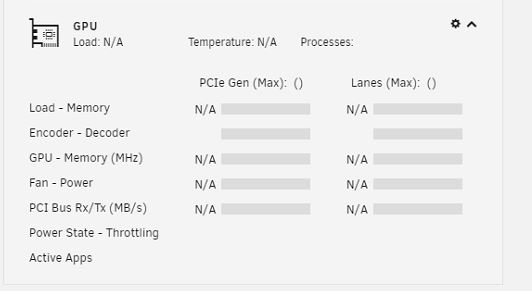

I had GPU Statistics setup as well. I thing that's where I was getting confused is nvidia-smi showed it but dashboard gpu stats didn't show anything

Removing that file and uninstalling intel top fixed the problem.  I dont need the vm anymore.  Thank you!
Interestingly, when my 10850k was properly setup for igpu in plex, it woldnt show "video enhance load" when it was transcoding.  But when my 9900k transcodes with igpu, it does show "video enhance load" when transcoding.
