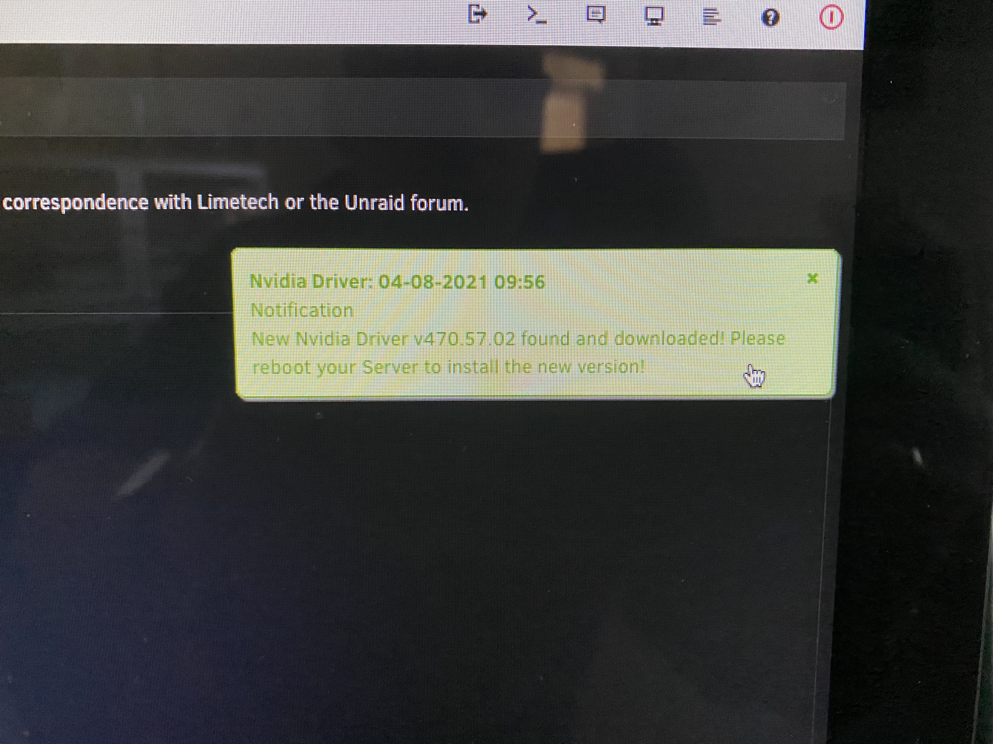

  2. The Notification is that green one time and date stamped. My server was running All Ok on the previous version. I realised there was an issue when I tried to clear that Notification as I had to click on the tab to reload and that’s when it locked up! So I’m not sure as you say it’s Not Possible for my server to Notify Me yet there it is Notifying me it’s done it and I need to reboot but before I even rebooted the logs was full of the error and GUI locked up. I’m not saying it’s your plug-in but it’s also Not my server / hardware as it’s been working faultlessly until I had that green Notification of Updated Version which os exactly what broke it last time in Exactly the same way.

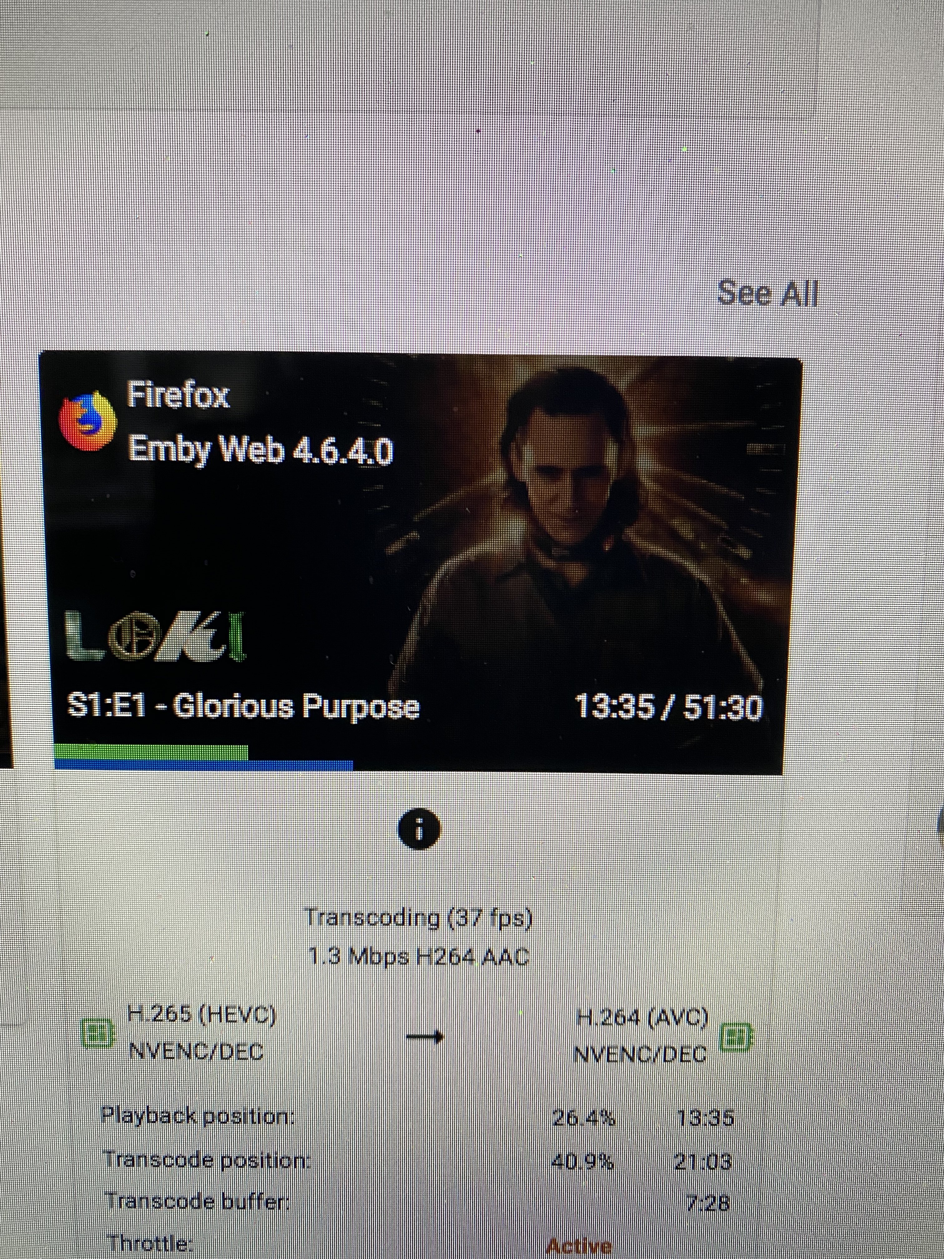

  5. Will have to do all that after work! Basically servers been running fine all week! This morning the GUI had locked up and that notification was on the screen. Auto Plug-in update is off yet that says Found and downloaded which caused that normal error in the logs. Just to clarify the servers been working the GPU has been working and transcoding all week NO issue not one then This morning my sever locked up and that update was installed that broke it. regards lee

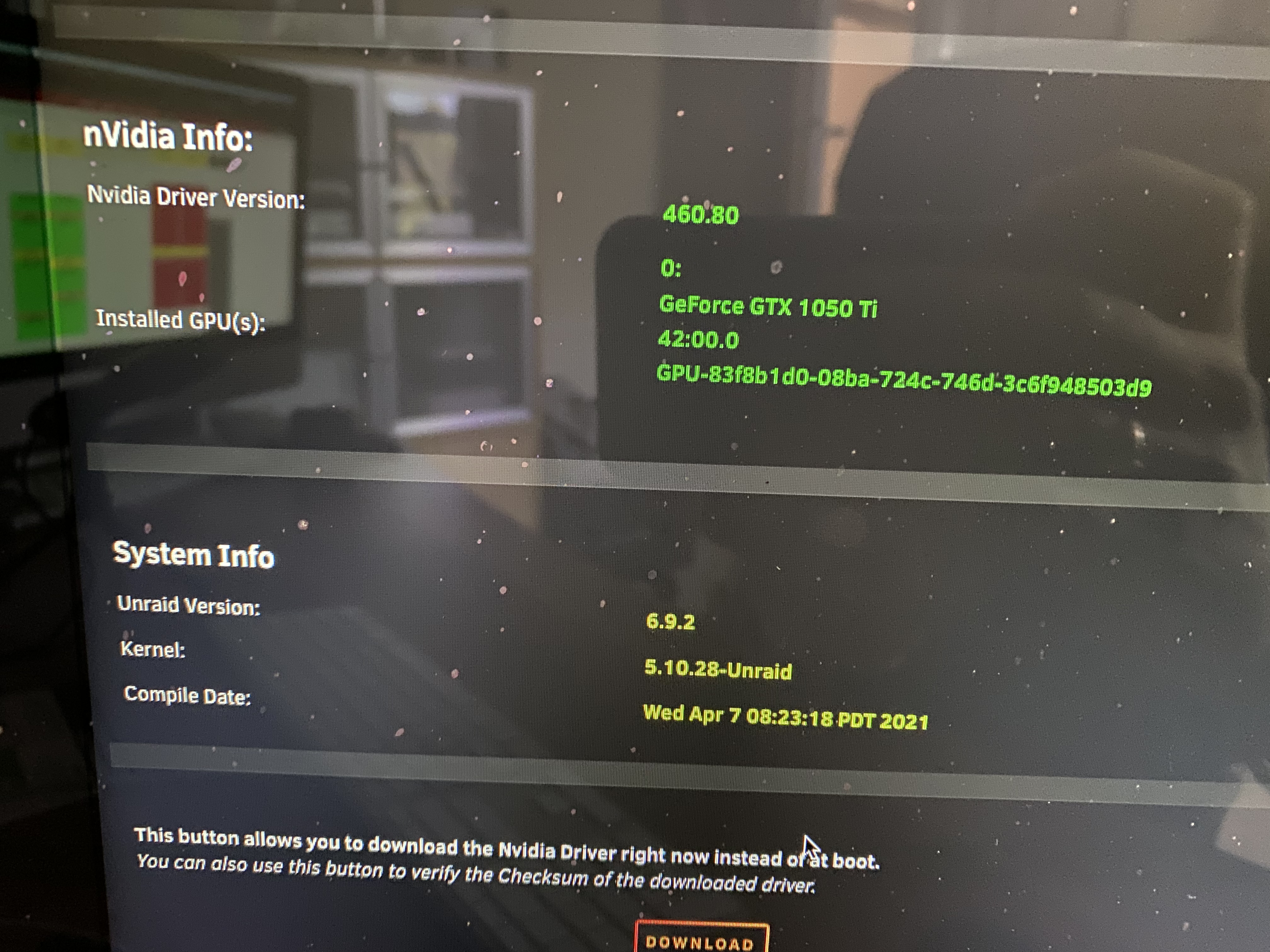

  6. Nope nothing has changed Nothing at all, my sever GUI locked up and I had a notification of the update. I’m running the 1st one and it’s working fine so it’s Not my server or GPU. servers running ok not locking up no fault in logs snd it’s transcoding fine so I don’t know but v470.42.01 worked absolutely fine until today when it updated and then locked up GUI and the fault in logs. Now running 460.80 and again running fine no issues so if it was my server / gpu why was it ok on 470.42.01 and 460.80. I don’t want it auto updating I turned auto update off yet it’s being forced like this morning

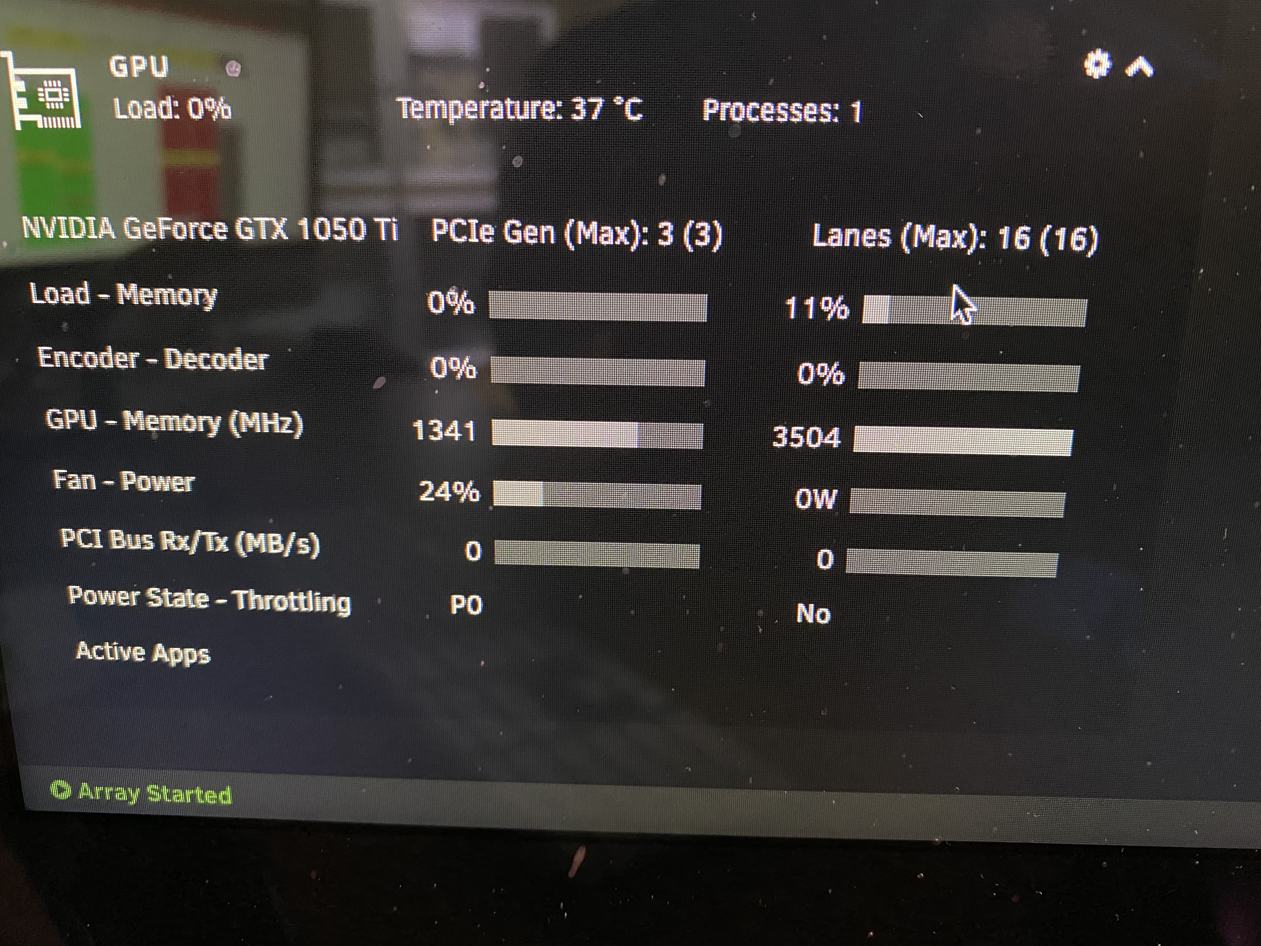

  14. removed Plugin Jul 1 22:30:44 R720XD emhttpd: cmd: /usr/local/emhttp/plugins/dynamix.plugin.manager/scripts/plugin remove nvidia-driver.plg Jul 1 22:30:44 R720XD root: plugin: running: anonymous Jul 1 22:31:01 R720XD kernel: docker0: port 1(veth049e849) entered disabled state Jul 1 22:31:01 R720XD kernel: veth6194793: renamed from eth0 Jul 1 22:31:01 R720XD avahi-daemon[12225]: Interface veth049e849.IPv6 no longer relevant for mDNS. Jul 1 22:31:01 R720XD avahi-daemon[12225]: Leaving mDNS multicast group on interface veth049e849.IPv6 with address fe80::5468:5dff:fe57:d2c7. Jul 1 22:31:01 R720XD kernel: docker0: port 1(veth049e849) entered disabled state Jul 1 22:31:01 R720XD kernel: device veth049e849 left promiscuous mode Jul 1 22:31:01 R720XD kernel: docker0: port 1(veth049e849) entered disabled state Jul 1 22:31:01 R720XD avahi-daemon[12225]: Withdrawing address record for fe80::5468:5dff:fe57:d2c7 on veth049e849.
