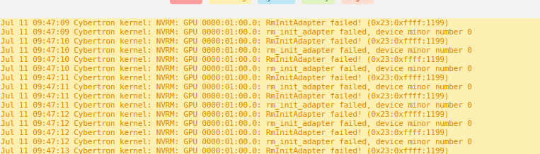

On 6/28/2021 at 3:06 PM, HellraiserOSU said:
I'm having an issue where my card appears for a little bit and then disappears. It's an EVGA GeForce RTX 3060 and on the plugins it'll show the driver version and the Installed GPU fine after I reboot. After I check it and refresh the page, it's gone and says No devices found.
I don't have a VM
I do see in the logs
NVRM: GPU 0000:01:00.0: RmInitAdapter failed! (0x23:0xffff:1199)
NVRM: GPU 0000:01:00.0: rm_init_adapter failed, device minor number 0
Im having an identical Problem and am being advised its my card that works in other machine's and shows up in My UnRaid then disappears. If you find a fix please let me know :))
1 hour ago, ich777 said:
Sorry I really can't help with that since @HellraiserOSU hasen't reported back yet and since you don't tried HW transcoding with Unraid on the Gaming machine.
As said the drivers are still the same and nothing wasn't changed there at all, so if you roll back to that driver version that worked before I see no reasen why it shouldn't work now.

6 hours ago, HellraiserOSU said:
So I turned on the Above 4G Decoding.. still doesn't work.. Here's my diagonstic log.
From the Diagnostics I see nothing suspicious (please remove the line that is executed on boot for the card, I think you know what I mean), do you boot in UEFI or Legacy mode? If you are booting into Legacy please try to boot with UEFI and send me the Diagnostics again.

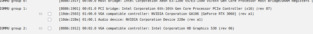

So i rebooted and in lspci.txt I see
01:00.0 VGA compatible controller [0300]: NVIDIA Corporation GA106 [GeForce RTX 3060] [10de:2503] (rev a1)
    Subsystem: eVga.com. Corp. Device [3842:3655]
    Kernel driver in use: nvidia
    Kernel modules: nvidia_drm, nvidia
01:00.1 Audio device [0403]: NVIDIA Corporation Device [10de:228e] (rev a1)
Edited by HellraiserOSU

i MAYBE got it.
In the Bios there was a PCI device mode and it was at UEFI ..   changed it to Legacy .. There was other areas that let you change either UEFI and Legacy mode and they were all in Legacy mode except for this one.
Now, I am not getting the RMIInitAdapter failed error
So, hopefully this is it.. Thanks for your help!
5 hours ago, ich777 said:
@HellraiserOSU so everything is working now?
Nice and thank you for the hint with the UEFI/Legacy devices. :)
Yup seems so.. Plex says hardware decoding and the gpu statistics show everything and the plex icon when plex is running.
Welcome and thank you as well!
