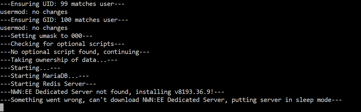

  2. Hello and Happy New Year! I'm trying to start Neverwinter Nights and it's giving me this. I think you had to update the container the last time this happened. When you have a chance can you give it a look? Thanks!

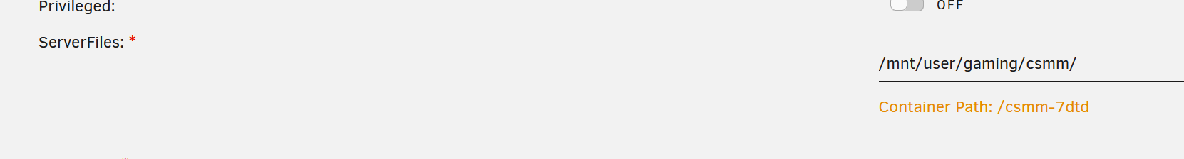

  13. Hello! I'm on the step of installing the docker container. I edited the config.yaml and put in my UUID in the correct places. When you start the cloudflared container, it keeps restarting with this Use `cloudflared tunnel run` to start tunnel XXXXXX-XXXX-XXX where the x's are my UUID I removed the restart argument and it just runs.. posts that message in the log file, and stops.. Can someone help me on this one? I've tried redoing the container a few times. Thanks!
  14. Ah yeah that COULD be it. This was setup a way long time ago before i had a good grasp of Unraid. I'll see maybe about moving it to appdata . Thanks!
