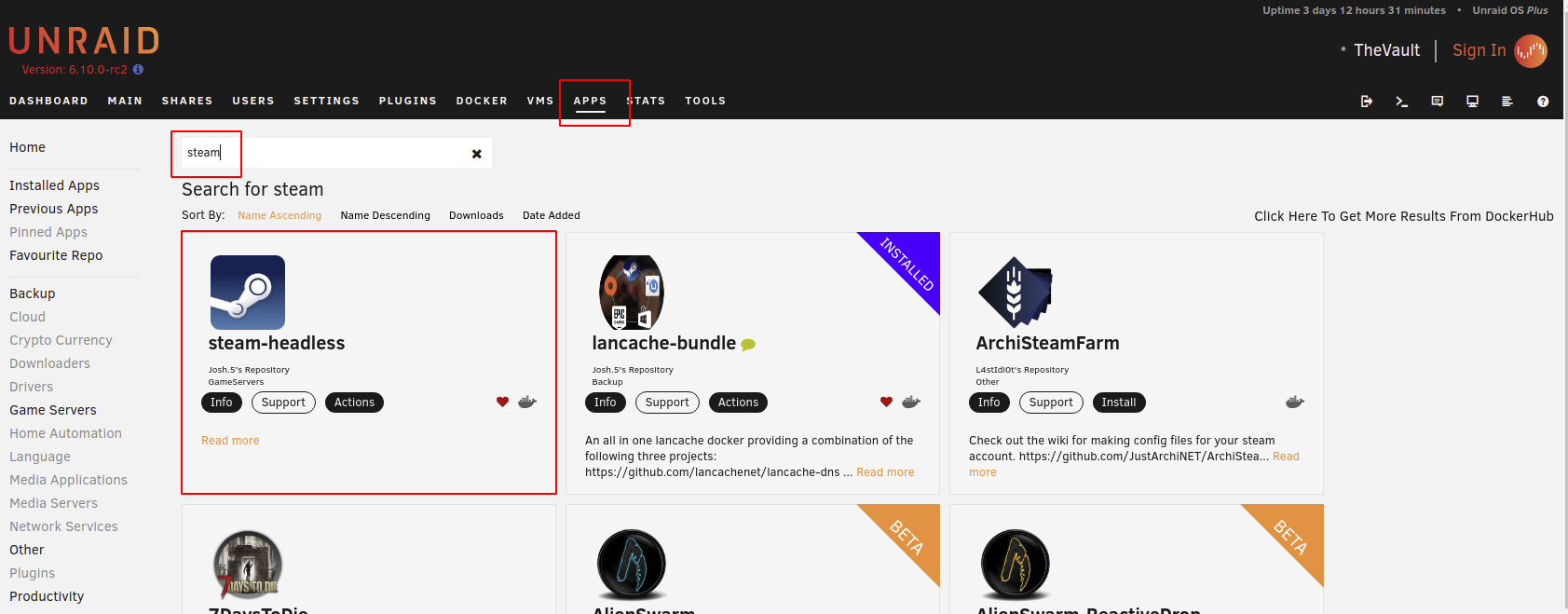

CONTAINER TEMPLATE:
  1. Navigate to "APPS" tab.
  2. Search for "steam-headless"
  3. Select either Install or Actions > Install from the search result.
  4. Configure the template as required.

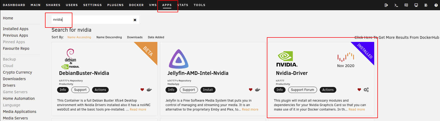

GPU CONFIGURATION (NVIDIA):
This container can use your GPU. In order for it to do this you need to have the NVIDIA plugin installed.
  1. Install the Nvidia-Driver Plugin by @ich777. This will maintain an up-to-date NVIDIA driver installation on your Unraid server.

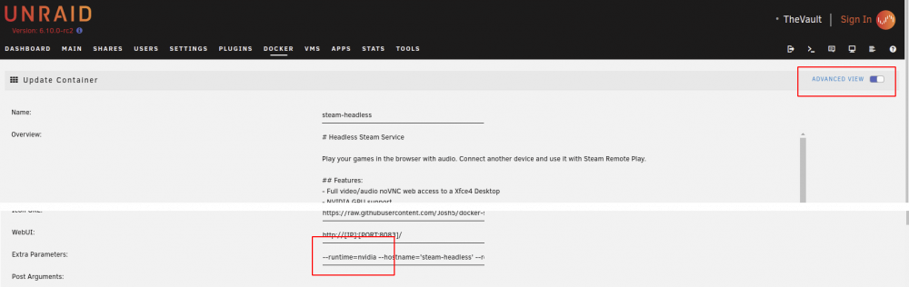

  2. Toggle the steam-headless Docker Container template editor to "Advanced View".
  3. In the "Extra Parameters" field, ensure that you have the "--runtime=nvidia" parameter added.
    unraid-steam-headless-template-nvidia-extra-params.thumb.png.0421c194f4b5f6c72147635a92e14b39.png

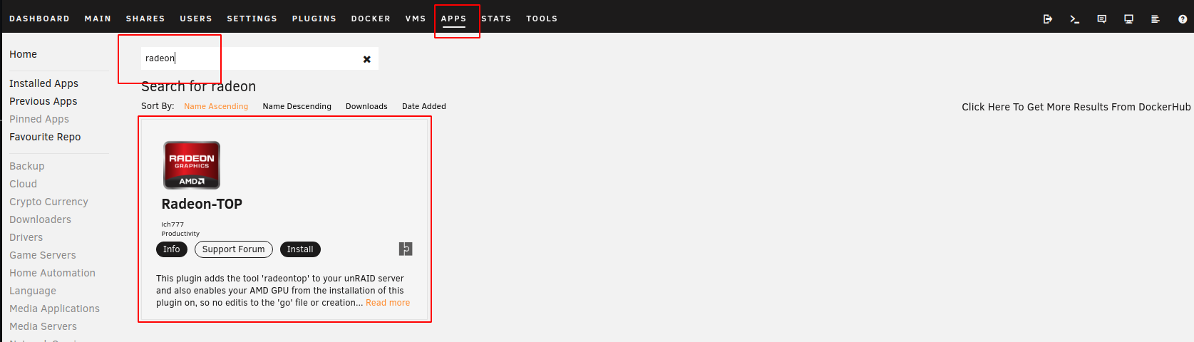

GPU CONFIGURATION (AMD):
  1. Install the Radeon-Top Plugin by @ich777.image.thumb.png.197974d8a61c268525794394dadb70ba.png
  2. Profit

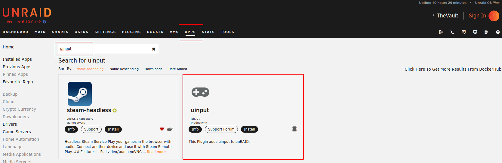

ADDING CONTROLLER SUPPORT:
Unraid's Linux kernel by default does not have the modules required to support controller input. Steam requires these modules to be able to create the virtual "Steam Input Gamepad Emulation" device that it can then map buttons to.
@ich777 Has kindly offered to build and maintain the required modules for the Unraid kernel as he already has a CI/CD pipeline in place and a small number of other kernel modules that he is maintaining for other projects. So a big thanks to him for that!
  1. Install the uinput plugin from the Apps tab.
    unraid-steam-headless-install-uinput-plugin.thumb.png.5445fa85686bb24606ab30bfef49f1c8.png

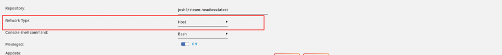

  2. The container will not be able to receive kernel events from the host unless the Network Type: is set to "host". Ensure that you container is configured this way.
    WARNING:
    Be aware that this container requires at least 8083, 32123, and 2222 available for the WebUI, Web Audio, and SSH to work. It will also require any ports that Steam requires for Steam Remote Play
    unraid-steam-headless-configure-network-as-host.thumb.png.62d1ac7f0094e8eff85fca4b67cff481.png
  3. No server restart is required, however. Ensure that the steam-headless Docker container is recreated after installing the uinput plugin for it to be able to detect the newly added module.

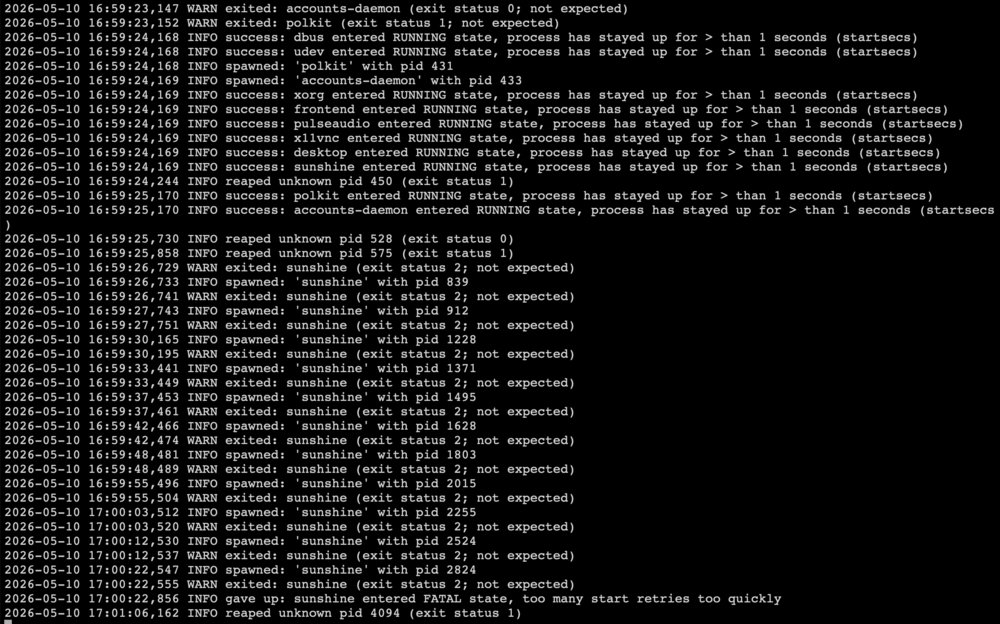

2022-01-10 11:10:08,471 INFO exited: audiostream (exit status 111; not expected)
2022-01-10 11:10:09,236 INFO spawned: 'xorg' with pid 240
2022-01-10 11:10:09,239 INFO spawned: 'de' with pid 241
2022-01-10 11:10:09,313 INFO exited: xorg (exit status 1; not expected)
2022-01-10 11:10:09,369 INFO reaped unknown pid 250 (exit status 0)
2022-01-10 11:10:09,371 INFO exited: de (exit status 1; not expected)
2022-01-10 11:10:09,483 INFO success: x11vnc entered RUNNING state, process has stayed up for > than 1 seconds (startsecs)
2022-01-10 11:10:09,485 INFO exited: x11vnc (exit status 1; not expected)
2022-01-10 11:10:10,491 INFO spawned: 'audiostream' with pid 251
2022-01-10 11:10:10,496 INFO spawned: 'x11vnc' with pid 252
2022-01-10 11:10:10,501 INFO exited: audiostream (exit status 111; not expected)
2022-01-10 11:10:11,262 INFO reaped unknown pid 220 (exit status 1)
2022-01-10 11:10:11,516 INFO spawned: 'xorg' with pid 253
2022-01-10 11:10:11,516 INFO success: x11vnc entered RUNNING state, process has stayed up for > than 1 seconds (startsecs)
2022-01-10 11:10:11,520 INFO spawned: 'de' with pid 254
2022-01-10 11:10:11,521 INFO exited: x11vnc (exit status 1; not expected)
2022-01-10 11:10:11,526 INFO spawned: 'x11vnc' with pid 255
2022-01-10 11:10:11,601 INFO exited: xorg (exit status 1; not expected)
2022-01-10 11:10:11,652 INFO reaped unknown pid 264 (exit status 0)
2022-01-10 11:10:11,653 INFO exited: de (exit status 1; not expected)
2022-01-10 11:10:12,547 INFO success: x11vnc entered RUNNING state, process has stayed up for > than 1 seconds (startsecs)
2022-01-10 11:10:12,547 INFO reaped unknown pid 249 (exit status 1)
2022-01-10 11:10:12,550 INFO exited: x11vnc (exit status 1; not expected)
2022-01-10 11:10:12,634 INFO spawned: 'x11vnc' with pid 265
2022-01-10 11:10:13,658 INFO spawned: 'audiostream' with pid 266
2022-01-10 11:10:13,658 INFO success: x11vnc entered RUNNING state, process has stayed up for > than 1 seconds (startsecs)
2022-01-10 11:10:13,659 INFO exited: x11vnc (exit status 1; not expected)
2022-01-10 11:10:13,663 INFO spawned: 'x11vnc' with pid 267
2022-01-10 11:10:13,667 INFO exited: audiostream (exit status 111; not expected)
2022-01-10 11:10:13,668 INFO gave up: audiostream entered FATAL state, too many start retries too quickly
2022-01-10 11:10:14,686 INFO spawned: 'xorg' with pid 268
2022-01-10 11:10:14,686 INFO success: x11vnc entered RUNNING state, process has stayed up for > than 1 seconds (startsecs)
2022-01-10 11:10:14,690 INFO spawned: 'de' with pid 269
2022-01-10 11:10:14,690 INFO reaped unknown pid 263 (exit status 1)
2022-01-10 11:10:14,691 INFO exited: x11vnc (exit status 1; not expected)
2022-01-10 11:10:14,695 INFO spawned: 'x11vnc' with pid 270
2022-01-10 11:10:14,757 INFO exited: xorg (exit status 1; not expected)
2022-01-10 11:10:14,813 INFO gave up: xorg entered FATAL state, too many start retries too quickly
2022-01-10 11:10:14,813 INFO reaped unknown pid 279 (exit status 0)
2022-01-10 11:10:14,815 INFO exited: de (exit status 1; not expected)
2022-01-10 11:10:15,463 INFO gave up: de entered FATAL state, too many start retries too quickly
2022-01-10 11:10:15,714 INFO success: x11vnc entered RUNNING state, process has stayed up for > than 1 seconds (startsecs)
2022-01-10 11:10:15,716 INFO exited: x11vnc (exit status 1; not expected)
2022-01-10 11:10:16,722 INFO spawned: 'x11vnc' with pid 280
2022-01-10 11:10:17,751 INFO success: x11vnc entered RUNNING state, process has stayed up for > than 1 seconds (startsecs)
2022-01-10 11:10:17,753 INFO exited: x11vnc (exit status 1; not expected)
2022-01-10 11:10:18,761 INFO spawned: 'x11vnc' with pid 281
2022-01-10 11:10:18,762 INFO reaped unknown pid 278 (exit status 1)
2022-01-10 11:10:19,783 INFO success: x11vnc entered RUNNING state, process has stayed up for > than 1 seconds (startsecs)
2022-01-10 11:10:19,786 INFO exited: x11vnc (exit status 1; not expected)
2022-01-10 11:10:20,793 INFO spawned: 'x11vnc' with pid 282
2022-01-10 11:10:21,563 WARN received SIGTERM indicating exit request
2022-01-10 11:10:21,564 INFO waiting for audiowebsock, dbus, pulseaudio, ssh, x11vnc, novnc to die
2022-01-10 11:10:21,595 INFO stopped: novnc (exit status 143)
2022-01-10 11:10:21,595 INFO reaped unknown pid 204 (exit status 0)
2022-01-10 11:10:21,815 INFO success: x11vnc entered RUNNING state, process has stayed up for > than 1 seconds (startsecs)
2022-01-10 11:10:21,817 INFO stopped: x11vnc (terminated by SIGQUIT)
2022-01-10 11:10:21,819 INFO stopped: ssh (exit status 255)
2022-01-10 11:10:21,821 INFO stopped: pulseaudio (terminated by SIGQUIT)
2022-01-10 11:10:21,824 INFO stopped: dbus (terminated by SIGQUIT)
2022-01-10 11:10:21,828 INFO stopped: audiowebsock (terminated by SIGQUIT)

Just installed this, the "--runtime=nvidia" value was already there by default.
I also didn't modify "Nvidia GPU UUID" value as it was set to "all" by default and that seemed to work fine.

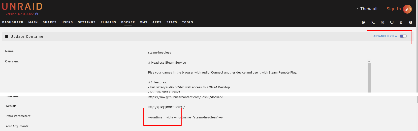

Awesome.
I will be removing that runtime param from the template once I add support for other hardware. For now it can stay there.
Also, you are right. The only reason to specify the GPU uuid is when you have multiple and you specifically want to use one.

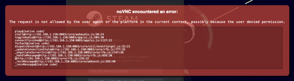

I do have this issue on Safari, doesn't happen in Firefox. I can still use the VNC, it just is in the way. No big deal, I can set up in Firefox and shouldn't need to touch it again.
