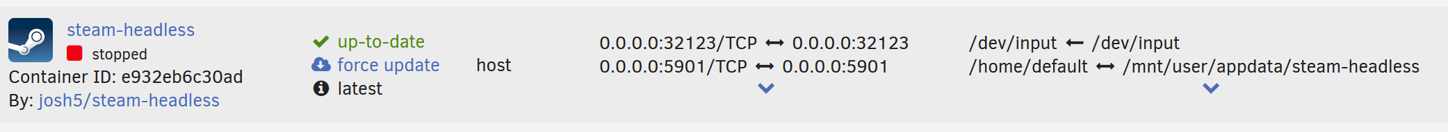

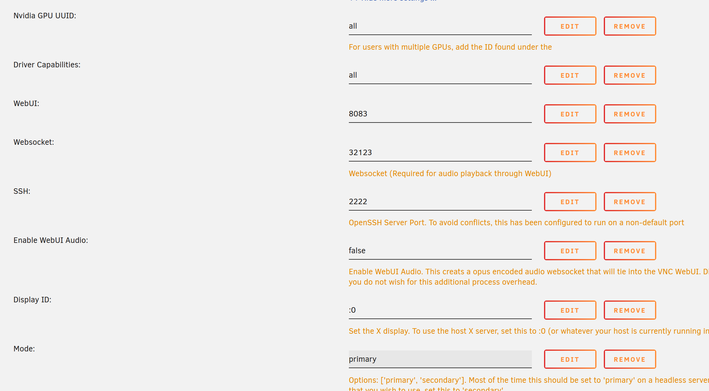

Hello! I am back to having this error... clean install too.. I deleted app_data for steam headless
2022-01-29 17:58:16,090 INFO spawned: 'novnc' with pid 150
2022-01-29 17:58:16,091 INFO spawned: 'x11vnc' with pid 151
2022-01-29 17:58:16,091 INFO spawned: 'desktop' with pid 152
2022-01-29 17:58:16,099 INFO reaped unknown pid 169 (exit status 0)
2022-01-29 17:58:16,113 INFO exited: desktop (exit status 1; not expected)
2022-01-29 17:58:17,083 INFO exited: x11vnc (exit status 1; not expected)
2022-01-29 17:58:17,087 INFO success: dbus entered RUNNING state, process has stayed up for > than 1 seconds (startsecs)
2022-01-29 17:58:17,087 INFO success: pulseaudio entered RUNNING state, process has stayed up for > than 1 seconds (startsecs)
2022-01-29 17:58:17,088 INFO success: sshd entered RUNNING state, process has stayed up for > than 1 seconds (startsecs)
2022-01-29 17:58:17,093 INFO success: udev entered RUNNING state, process has stayed up for > than 1 seconds (startsecs)
2022-01-29 17:58:17,093 INFO success: novnc entered RUNNING state, process has stayed up for > than 1 seconds (startsecs)
2022-01-29 17:58:17,186 INFO spawned: 'desktop' with pid 312
2022-01-29 17:58:17,195 INFO reaped unknown pid 317 (exit status 0)
2022-01-29 17:58:17,209 INFO exited: desktop (exit status 1; not expected)
2022-01-29 17:58:18,250 INFO spawned: 'x11vnc' with pid 329
2022-01-29 17:58:19,257 INFO success: x11vnc entered RUNNING state, process has stayed up for > than 1 seconds (startsecs)
2022-01-29 17:58:19,258 INFO spawned: 'desktop' with pid 330
2022-01-29 17:58:19,258 INFO exited: x11vnc (exit status 1; not expected)
2022-01-29 17:58:19,259 INFO spawned: 'x11vnc' with pid 331
2022-01-29 17:58:19,268 INFO reaped unknown pid 336 (exit status 0)
2022-01-29 17:58:19,280 INFO exited: desktop (exit status 1; not expected)
2022-01-29 17:58:20,266 INFO success: x11vnc entered RUNNING state, process has stayed up for > than 1 seconds (startsecs)
2022-01-29 17:58:20,266 INFO exited: x11vnc (exit status 1; not expected)
2022-01-29 17:58:21,095 INFO spawned: 'x11vnc' with pid 348
2022-01-29 17:58:22,105 INFO success: x11vnc entered RUNNING state, process has stayed up for > than 1 seconds (startsecs)
2022-01-29 17:58:22,106 INFO exited: x11vnc (exit status 1; not expected)
2022-01-29 17:58:23,109 INFO spawned: 'x11vnc' with pid 349
2022-01-29 17:58:23,110 INFO spawned: 'desktop' with pid 350
2022-01-29 17:58:23,121 INFO reaped unknown pid 355 (exit status 0)
2022-01-29 17:58:23,136 INFO exited: desktop (exit status 1; not expected)
2022-01-29 17:58:23,866 INFO gave up: desktop entered FATAL state, too many start retries too quickly
2022-01-29 17:58:24,116 INFO success: x11vnc entered RUNNING state, process has stayed up for > than 1 seconds (startsecs)
2022-01-29 17:58:24,117 INFO exited: x11vnc (exit status 1; not expected)
2022-01-29 17:58:25,120 INFO spawned: 'x11vnc' with pid 367
2022-01-29 17:58:26,127 INFO success: x11vnc entered RUNNING state, process has stayed up for > than 1 seconds (startsecs)
2022-01-29 17:58:26,128 INFO exited: x11vnc (exit status 1; not expected)
2022-01-29 17:58:27,130 INFO spawned: 'x11vnc' with pid 368
2022-01-29 17:58:28,137 INFO success: x11vnc entered RUNNING state, process has stayed up for > than 1 seconds (startsecs)
2022-01-29 17:58:28,138 INFO exited: x11vnc (exit status 1; not expected)
I am running as host..
I've tried secondary display, :0 as  display ID, changing WebUi to a different port..
I can't get it to run again..
--Update--
Opening Desktop.err.log I'm getting
ln: failed to create symbolic link '/etc/alternatives/desktop-background': Permission denied
xrdb: Connection refused
xrdb: Can't open display ':55'
Unable to init server: Could not connect: Connection refused
Changing to a different number gave the same error
and changing it to :0 gave the same
xrdb: Can't open display ':0'
Edited by HellraiserOSU

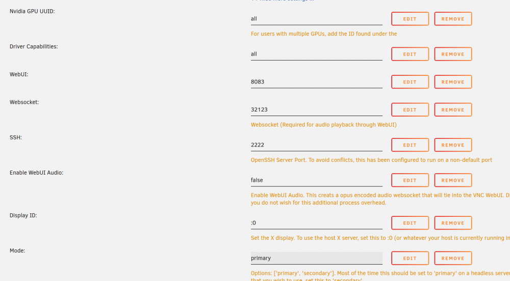

2022-01-29 17:58:16,090 INFO spawned: 'novnc' with pid 1502022-01-29 17:58:16,091 INFO spawned: 'x11vnc' with pid 1512022-01-29 17:58:16,091 INFO spawned: 'desktop' with pid 1522022-01-29 17:58:16,099 INFO reaped unknown pid 169 (exit status 0)2022-01-29 17:58:16,113 INFO exited: desktop (exit status 1; not expected)2022-01-29 17:58:17,083 INFO exited: x11vnc (exit status 1; not expected)2022-01-29 17:58:17,087 INFO success: dbus entered RUNNING state, process has stayed up for > than 1 seconds (startsecs)2022-01-29 17:58:17,087 INFO success: pulseaudio entered RUNNING state, process has stayed up for > than 1 seconds (startsecs)2022-01-29 17:58:17,088 INFO success: sshd entered RUNNING state, process has stayed up for > than 1 seconds (startsecs)2022-01-29 17:58:17,093 INFO success: udev entered RUNNING state, process has stayed up for > than 1 seconds (startsecs)2022-01-29 17:58:17,093 INFO success: novnc entered RUNNING state, process has stayed up for > than 1 seconds (startsecs)2022-01-29 17:58:17,186 INFO spawned: 'desktop' with pid 3122022-01-29 17:58:17,195 INFO reaped unknown pid 317 (exit status 0)2022-01-29 17:58:17,209 INFO exited: desktop (exit status 1; not expected)2022-01-29 17:58:18,250 INFO spawned: 'x11vnc' with pid 3292022-01-29 17:58:19,257 INFO success: x11vnc entered RUNNING state, process has stayed up for > than 1 seconds (startsecs)2022-01-29 17:58:19,258 INFO spawned: 'desktop' with pid 3302022-01-29 17:58:19,258 INFO exited: x11vnc (exit status 1; not expected)2022-01-29 17:58:19,259 INFO spawned: 'x11vnc' with pid 3312022-01-29 17:58:19,268 INFO reaped unknown pid 336 (exit status 0)2022-01-29 17:58:19,280 INFO exited: desktop (exit status 1; not expected)2022-01-29 17:58:20,266 INFO success: x11vnc entered RUNNING state, process has stayed up for > than 1 seconds (startsecs)2022-01-29 17:58:20,266 INFO exited: x11vnc (exit status 1; not expected)2022-01-29 17:58:21,095 INFO spawned: 'x11vnc' with pid 3482022-01-29 17:58:22,105 INFO success: x11vnc entered RUNNING state, process has stayed up for > than 1 seconds (startsecs)2022-01-29 17:58:22,106 INFO exited: x11vnc (exit status 1; not expected)2022-01-29 17:58:23,109 INFO spawned: 'x11vnc' with pid 3492022-01-29 17:58:23,110 INFO spawned: 'desktop' with pid 3502022-01-29 17:58:23,121 INFO reaped unknown pid 355 (exit status 0)2022-01-29 17:58:23,136 INFO exited: desktop (exit status 1; not expected)2022-01-29 17:58:23,866 INFO gave up: desktop entered FATAL state, too many start retries too quickly2022-01-29 17:58:24,116 INFO success: x11vnc entered RUNNING state, process has stayed up for > than 1 seconds (startsecs)2022-01-29 17:58:24,117 INFO exited: x11vnc (exit status 1; not expected)2022-01-29 17:58:25,120 INFO spawned: 'x11vnc' with pid 3672022-01-29 17:58:26,127 INFO success: x11vnc entered RUNNING state, process has stayed up for > than 1 seconds (startsecs)2022-01-29 17:58:26,128 INFO exited: x11vnc (exit status 1; not expected)2022-01-29 17:58:27,130 INFO spawned: 'x11vnc' with pid 3682022-01-29 17:58:28,137 INFO success: x11vnc entered RUNNING state, process has stayed up for > than 1 seconds (startsecs)2022-01-29 17:58:28,138 INFO exited: x11vnc (exit status 1; not expected)
--Update--
Is xorg starting?
there is no controller support in the Debian Distro what so ever, could there be the culprit?
Sorry, I have not tried to use the container for this reason. If you do figure it out, please post some details here so that others can also set theirs up in the same way that you are trying to.
