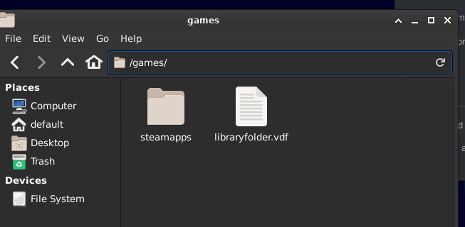

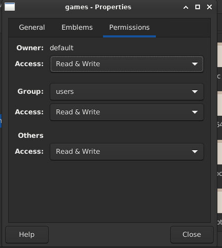

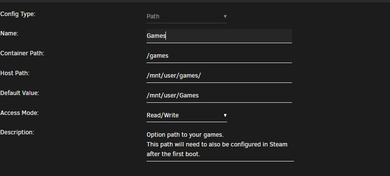

On 1/14/2022 at 2:00 AM, Josh.5 said:
Have you got something modifying the permissions of the files in that directory?
Hey,
No its a brand new install. this is a test on a test machine. i have one ssd set in the array not in the cache. what permission does the share need ?. installling the game works fine.
i can see the files.

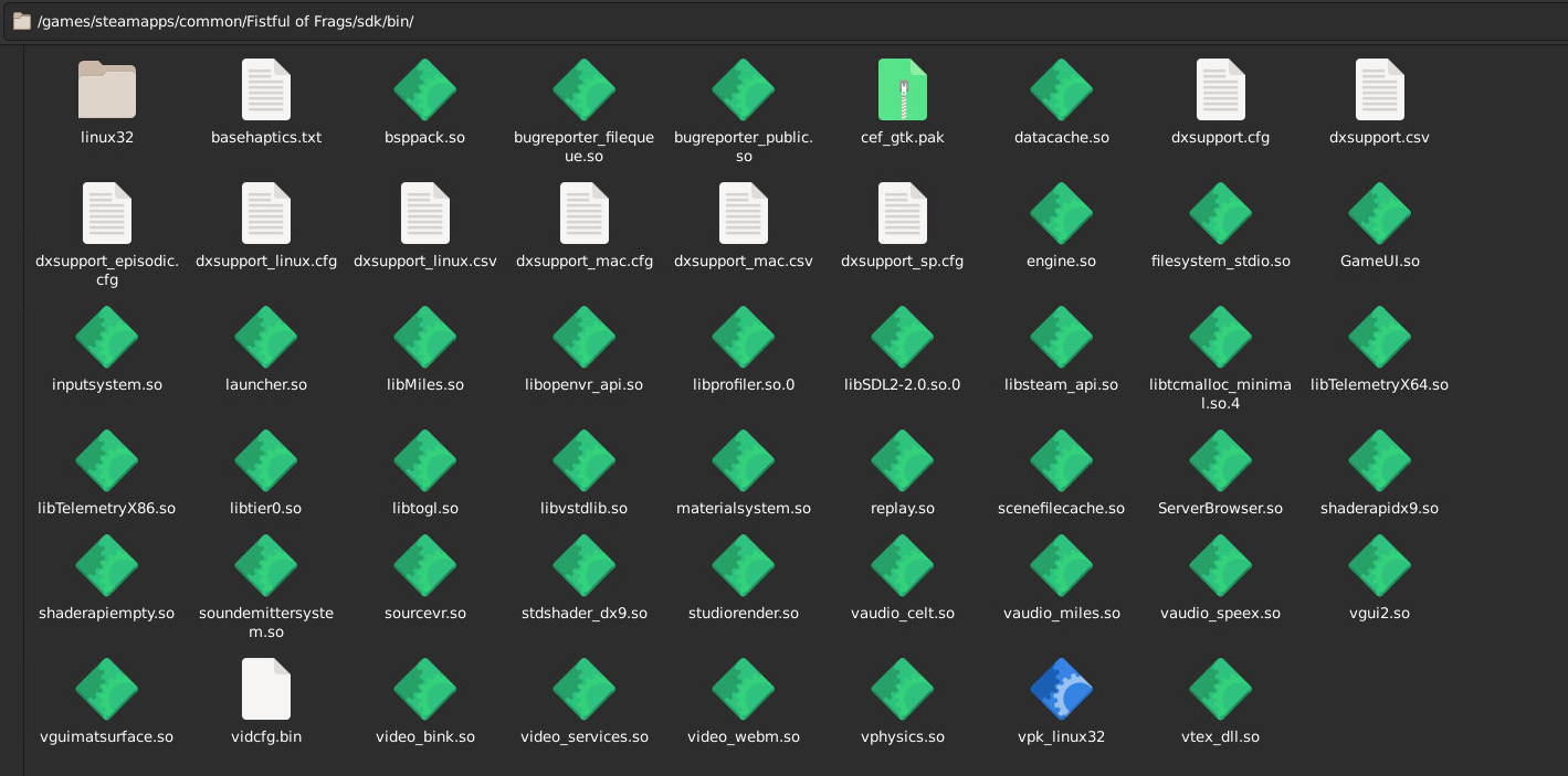

Looks like the file filesystem_steam.so it's not even there.
Edited by [RIVINS]

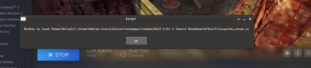

I'm trying to test this out with HL2 Deathmatch and I get this error. Also, my shared game directory didn't come over. I can see it in the file system but it wont let me add it in Steam.

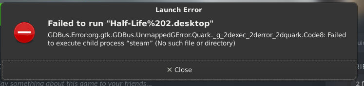

I tried running HL2 from the icon and got this.
Edited by Mobious
@[RIVINS]  @Mobious
Try google the error "Unable to load filesystem_steam.so". Looks like there are some issues with steam and XFS file systems for some games. I have not looked into this, but let me know if you find a fix that can be applied to the container or Unraid configuration.
