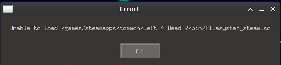

Hey all, am i doing something wrong? i get.image.png.ade8a67af4945205bf905127cb20366c.png

Have you got something modifying the permissions of the files in that directory?
