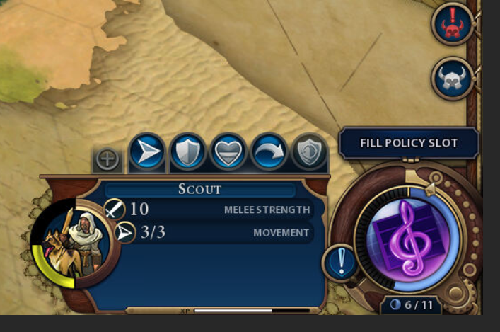

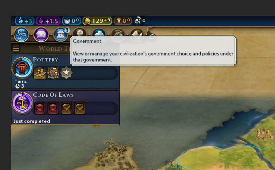

Hi everybody,
I have the Steam Headless app up and running.
This is exactly what I have been waiting for as I have not been able to get my GPU 2070 to pass through successfully.
I want to play CIV VI and I can lauch the game no problem and get it going.
However - When I need to fill the policy slot - Nothing happens when I click it.
The same goes for the menu under Goverment.
This makes the game literally unplayable 😞
Has anyone encountered this as well? What am I doing wrong?
