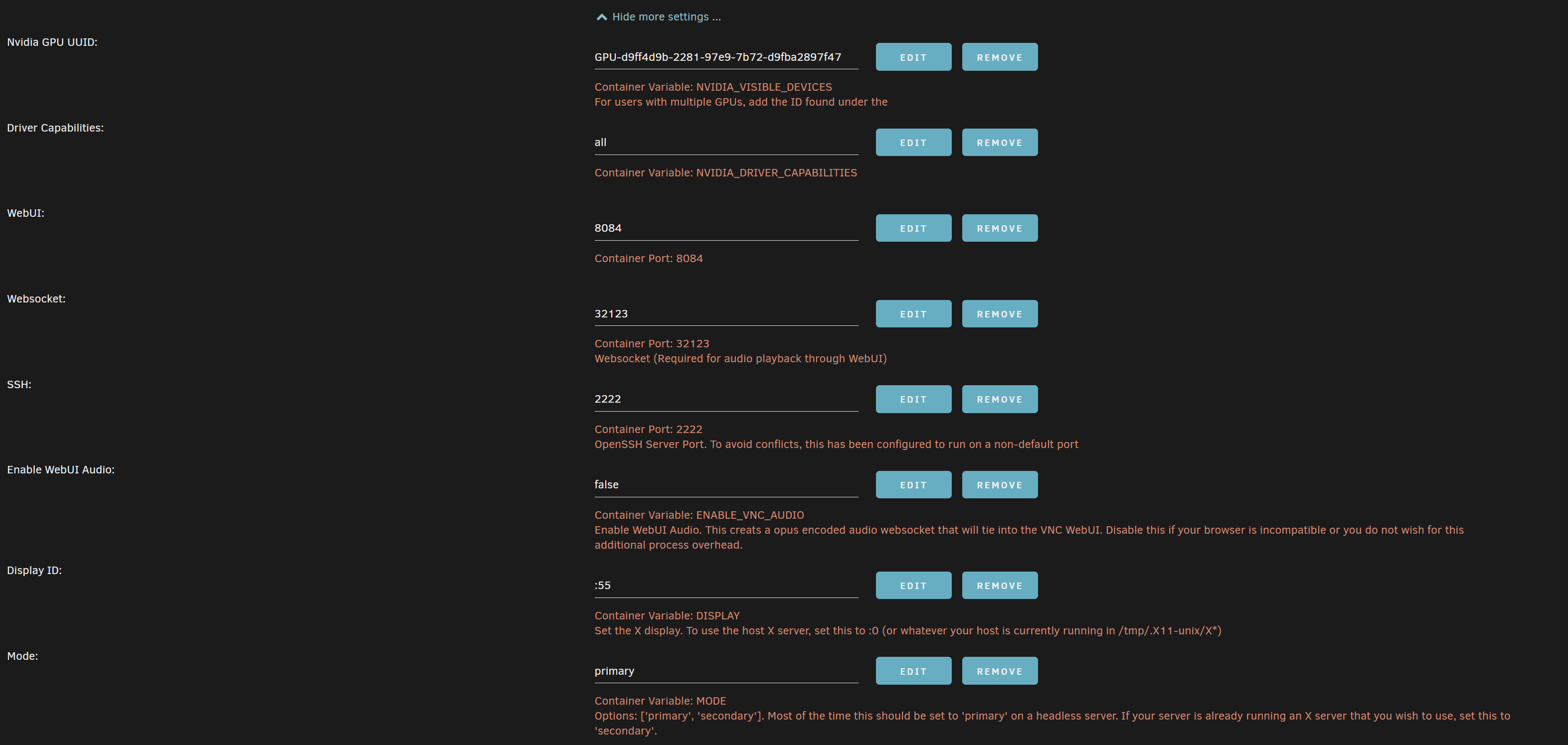

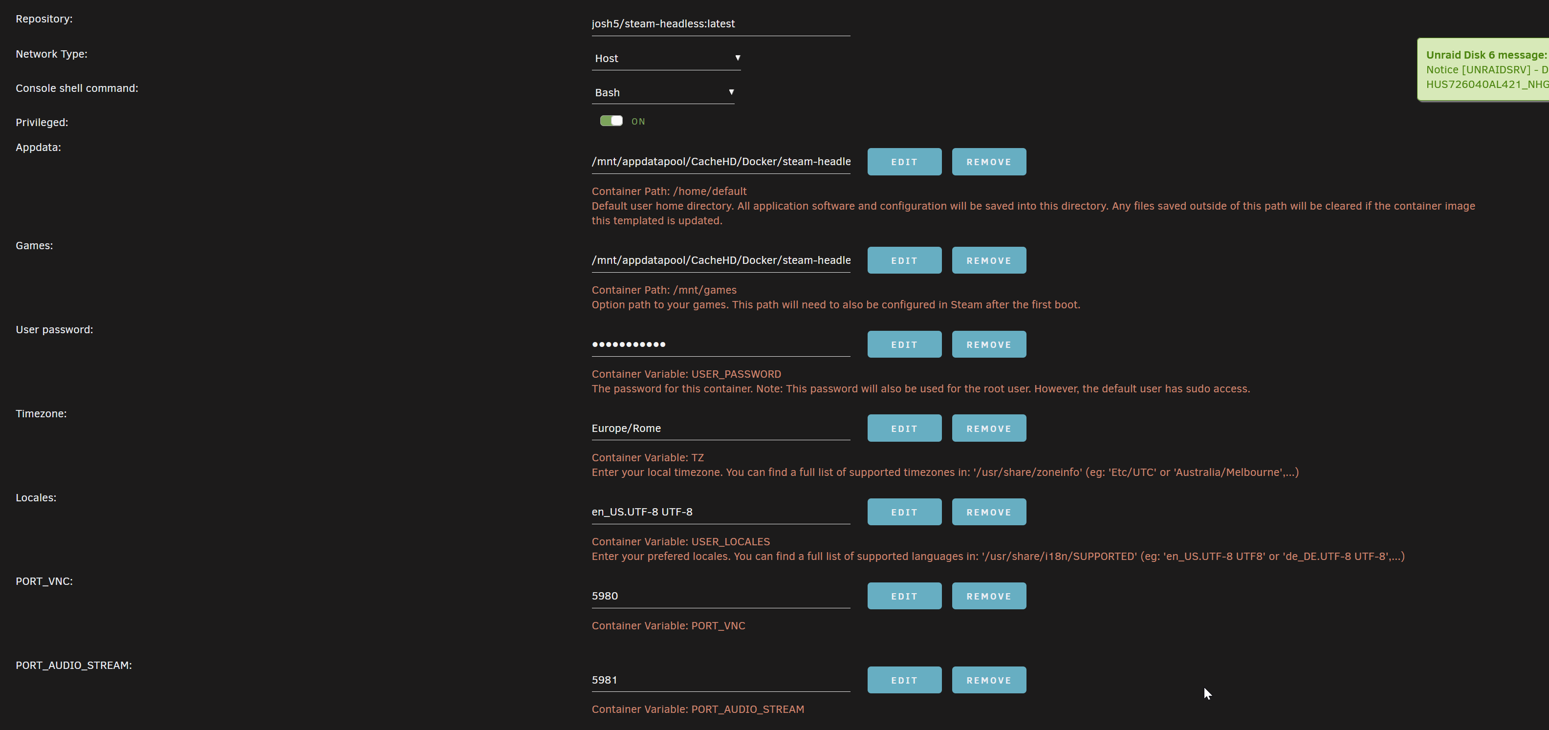

  12. I just updated UNRAID from 6.10.1 to 6.10.3 and now steam headless wont work. On the log console i get a spam of this: 2022-06-22 20:56:06,396 INFO spawned: 'x11vnc' with pid 566 2022-06-22 20:56:07,408 INFO success: x11vnc entered RUNNING state, process has stayed up for > than 1 seconds (startsecs) 2022-06-22 20:56:07,409 INFO exited: x11vnc (exit status 1; not expected) 2022-06-22 20:56:08,412 INFO spawned: 'x11vnc' with pid 567 2022-06-22 20:56:09,425 INFO success: x11vnc entered RUNNING state, process has stayed up for > than 1 seconds (startsecs) 2022-06-22 20:56:09,426 INFO exited: x11vnc (exit status 1; not expected) 2022-06-22 20:56:10,429 INFO spawned: 'x11vnc' with pid 568 etc... What should i check? Attached, my config
