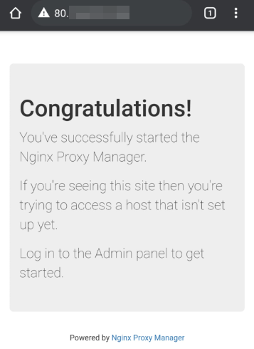

If you instead receive a 5xx / timeout error, your domain could have a wrong IP in the DNS/DDNS database or your internet provider does not provide a real IPv4. You can test this by opening your public IPv4 with the same mobile device outside of your Wi-Fi:

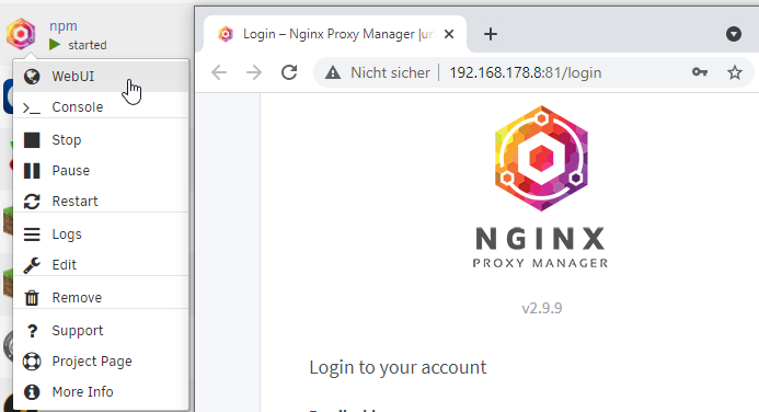

http://11.22.33.44/
This must return the welcome page of NPM:
721522783_2021-10-2818_28_44.png.753ba9b5b0c5ba6c916b06790f75386d.png.6e2b8ed924fafc2d13ac59aeedfb9d8f.png
If not, then port 80 is probably closed or your IPv4 is not public reachable.
Only if this requirements are met, Let's Encrypt is able to reach your NPM container and verify the SSL certificate. Note: This is automatically repeated every 90 days to re-verify the certificate, so port 80 must stay open!

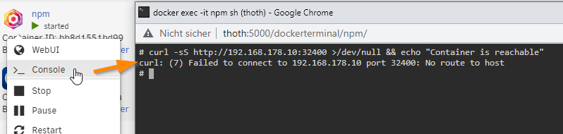

4.) Does NPM reach your target container?
Maybe you get an 5xx error if you open "http://plex.example.com". This happens usually if NPM is not able to reach the target container. You can verify this by NPM's container's console and entering the following commands:
curl -sS http://<container_ip>:<port>/ >/dev/null && echo "Container is reachable"
As you can see in my example, NPM is not able to reach the target IP:Port
This could be because of your selected networks. For example a container which uses the br0 network, is not able to reach a container which uses the bridge network:
image.thumb.png.1d9231ab31679e48b173d03a493889c9.png.97885877b66a2da2004e003b043e6179.png
Another reason could be, that you selected the wrong scheme. For example you used "http", but your target container only supports incoming connections through the scheme "https". Or you used the wrong ports. So double check your proxy host settings!
There could be other reasons as well. Feel free to post your test results in this thread and I try to help you to find the problem. But please add screenshots, so I can retrace which steps you already tried.

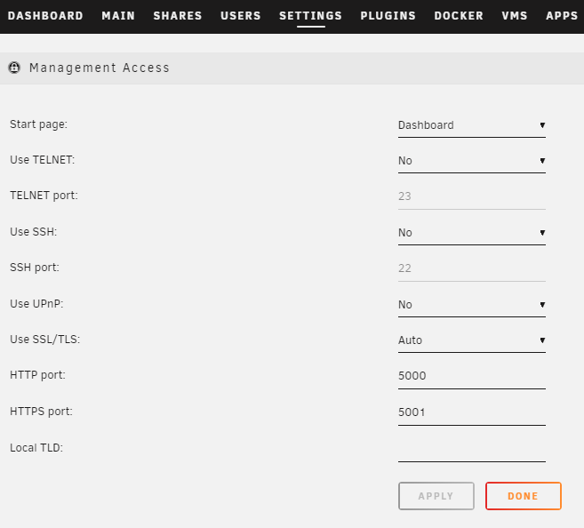

IPv6 Setup
This is the only reliable way to use NPM through IPv6:
1.) Change Unraid's HTTP and HTTPS ports to 5000 and 5001:
2.) Install NPM by using the host network:
3.) Open the ports 80 and 443 in your router:
4.) Open the NPM WebGUI and after changing the login, you can add a proxy host (see next post for Plex as an example).
5.) If you only want to type "tower" in your browser to reach your Unraid WebGUI, add this Redirection Host in NPM:
Further explanation:
IPv6 does not need port forwarding and many routers don't support it. So it's often not possible to forward internet traffic from port 443 (http) to a custom port like 8443. By that we have two options: Run NPM in the br0/custom network with a fixed ip address or run it in the host network (bridge has IPv6 disabled). I tried everything, but br0/custom isn't reliable as its not possible to define a fixed IPv6 without passing the IPv6 prefix and if your provider assigns a new IPv6 prefix, the container is offline and stays offline until we manually change the containers IPv6. And changing the IPv6 alone does not work as the "old" IPv4/IPv6 combination is internally reserved from the docker service. So its not only needed to change the IPv6 of the container, we additionally need to restart to entire Docker service itself.

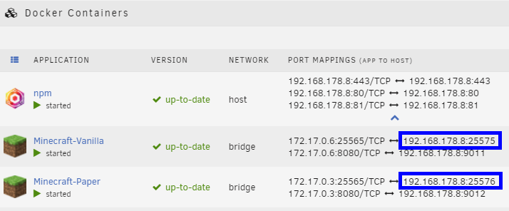

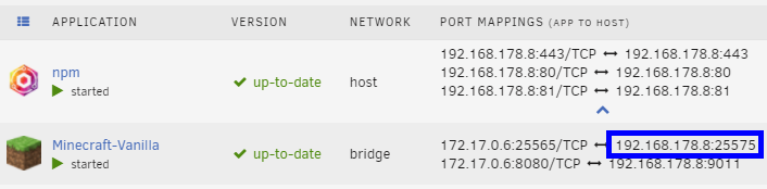

Single Minecraft Server (or other Gaming Servers)
If you host a single Minecraft Server (MCS) you need to add a Stream Host, which listens to port 25565 (default Minecraft Port) and forwards all traffic to your MCS container's IP and Port. In my case the Minecraft Server Container uses the bridge network and listens to port 25575:
In NPM add a stream host with the incoming Port 25565 and the containers IP and Port 25575 as its target:
Open the TCP Port 25565 in your router:
Now setup a domain with your public IP address (DDNS).
Note: No container is allowed to listen to a Port which is defined as an incoming Stream port in NPM.

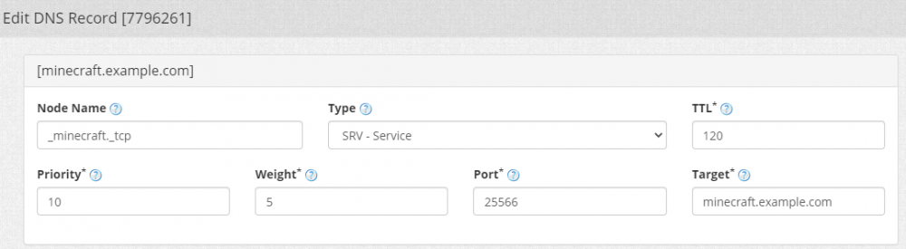

Multiple Minecraft Servers (or other Gaming Servers which support SRV records)
If you host multiple Minecraft Servers (MCS) you need to add multiple Stream Hosts which listen on different ports. For two servers it could be 25565 and 25566 while the MCS containers listen to 25575 and 25576:
In NPM add two stream hosts which listen to 25565 and 25566 and forward the traffic to the container's IPs and Ports accordingly:
Open both ports in your router:
Now the most important step:

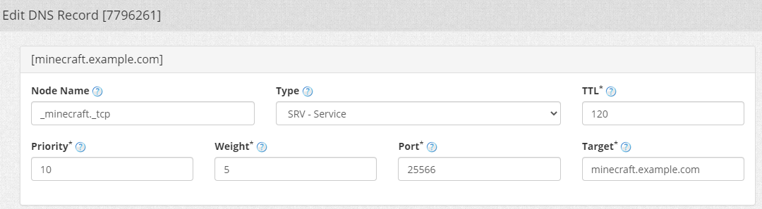

You need a domain or DDNS (dynu.com, noip.com, etc) provider which supports custom SRV records. After you registered your domain, you add an SRV record as follows:
Type: SRV
Service: minecraft
Protocol: tcp
TTL: 120
Priority: 0
Weight: 5
Target: minecraft.example.com (your DDNS address)
Especially for dynu.com you need to enter "_minecraft._tcp" in the "Node Name" field (the Dot is important!):
Finally you should check the entry as follows (set your DDNS address):
https://mxtoolbox.com/SuperTool.aspx?action=srv%3a_minecraft._tcp.minecraft.example.com&run=toolpage
If you now connect to your minecraft server through minecraft.example.com, your client will automatically check for the existence of this SRV record and use the different Port 25566 instead of the default 25565.
The same method is support by:

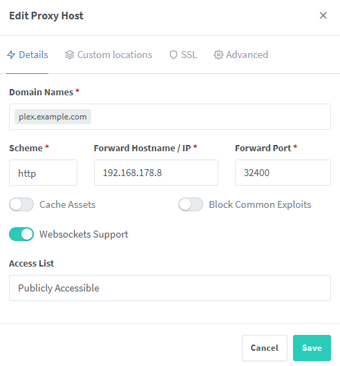

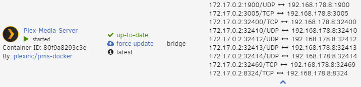

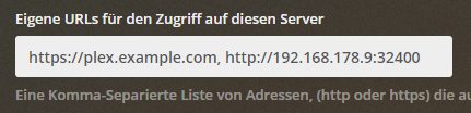

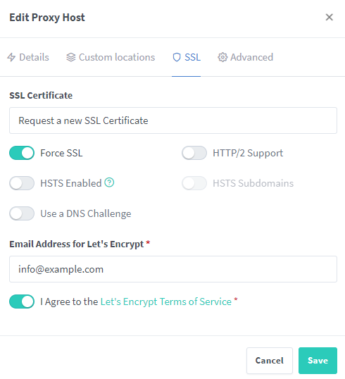

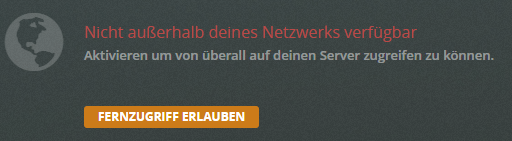

Plex
1.) Choose "bridge" as network:
2.) Plex Settings > Remote Access > Disable Remote Access (this forces Plex to use https://plex.example.com/ instead of https://49-243-220-22.48abf8487edc9d743c.plex.direct:32400/ )
3.) Plex Settings > Network > Set your domain and your unraid server IP as your "Own URLs" (use https and http as needed!):
By that your own domain is used for external access and your unraid server ip is used for local access (and https://local-ip.xxx.plex.direct/ of course).
4.) Add a new proxy host in Nginx Proxy Manager for your domain which targets the fixed IP of your Plex container and enable Websockets:
5.) Request an SSL certificate and force SSL:

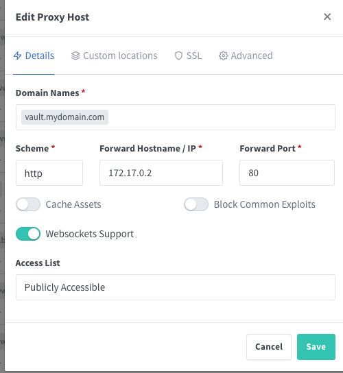

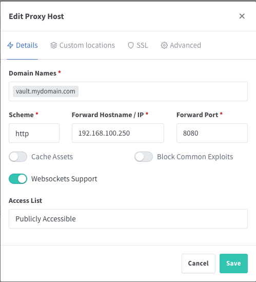

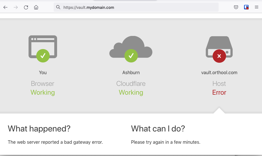

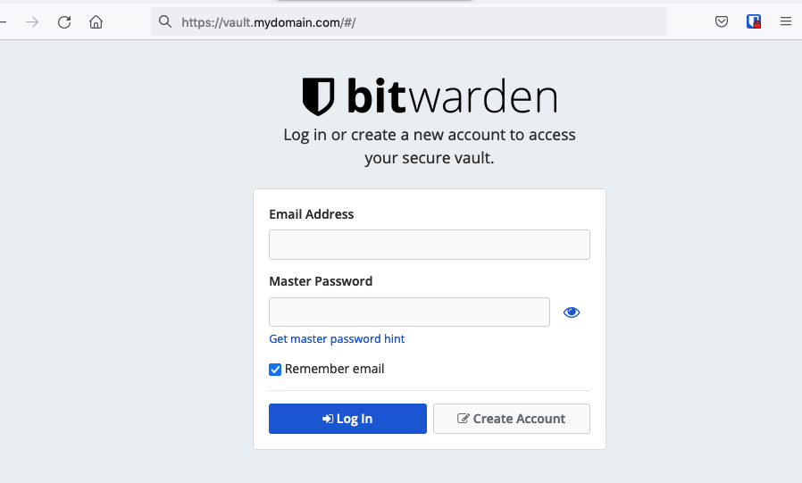

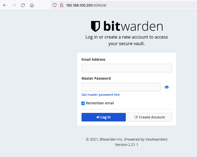

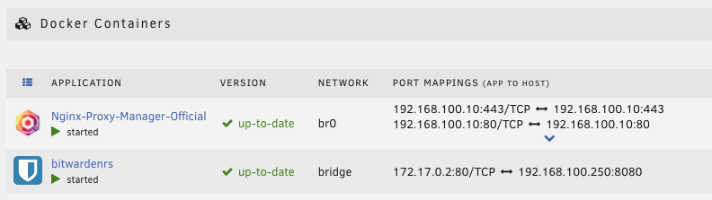

Reverse Proxy Docker container (Bitwarden) in network bridge on port 8080 not working.
Dear friends, I finally was able to migrate. I was having a huge problem with Bitwarden (from: vaultwarden/server).
I still don't know if it is something on my system or on NPMO.
My Docker in BW is set on bridge and NPMO is in network br0.
NPMO is using SQLite
When I added my proxy settings, as below, however it did not work. (it used to work with jlesage version). (I changed my real domain to mydomain.com for the screenshots).
image.png.0d5aa95be3e8abc481d709ee44e10352.pngimage.png.b8c94f017c7e37b414d2194981f57cb2.png
To make it work, I had to add "bridge" network as Post Arguments in the advanced view of NMPO. And  had to use the internal IP of BW and port 80.
image.png.298bfd28d0668455cef30ed0700e5432.pngimage.png.2bee92c90142413637e6b588c7acd874.png
My question is:
Am I missing some somthing on my UNRAID server to make NMPO in br0 to have access to the 192.168.100.250:8080 or is something wrong with NPMO that it does not accept port 8080 as the Forward Port?
Thank you in advance,
Lucas
My question is:
Lucas
This is the fix (I had the same issue).
Stop all your dockers.
Go to settings > dockers > enable "no"
Wait for that to turn off
Change "Host access to custom networks:" to off. Apply
Change "Host access to custom networks:" to On. Apply
Turn docker back on, try again.
Yes @Candle, you are right!!
Now that you pointed to the right direction, I found this:
Thank you!!!
This is something which will be removed in future Unraid versions. My suggestion: Run NPM as host and run all other containers as bridge.
Why? Why don't you guys just fix it instead of making it more difficult?
