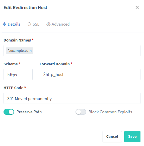

8 hours ago, Spritzup said:
is it possible to do a wildcard http to https redirect?
Yes. Add a redirection host with the following settings:

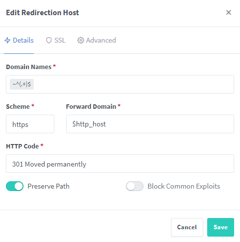

Or if you want it for all domains:
